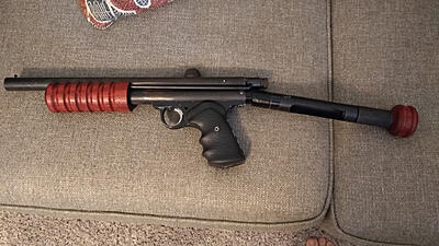

    Made some wood parts for my piranha, in somewhat of a Wally style. At least the butt stock knob is about the same spot as Papa Smurfs stock. Trying out this new interface.

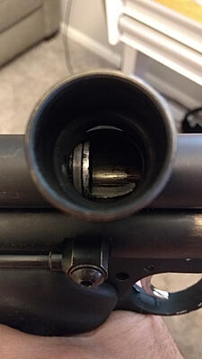

    It has a 3d printed "fishing line mod", and a printed changer cup seal that seals before it punctures.
    Very ingenious on the fishing line mod oring extension...
    loven in with the sweet looking wood pump and butt knob...
    very nicely done....
    hows the co2 seal and oring holding out...

      I've found the seal a little loose after dumping an almost full 12g, but it's been through a dozen 12 grams so far and still going.
      I'm working on another detent finger, to go with some 0.675" paint we had last month. I used reballs to test it, but that paint was sneaky and would double feed often.
