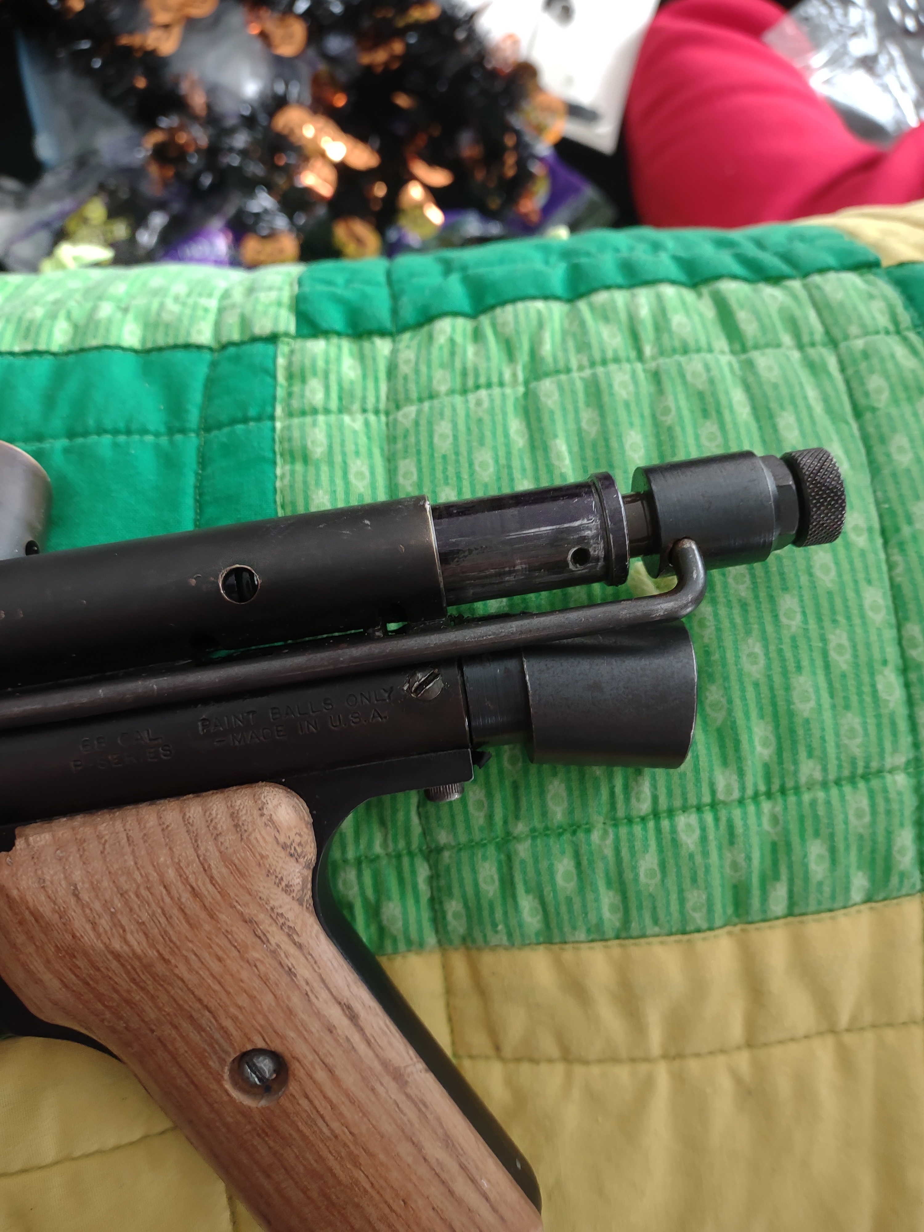

    I noticed it most when I had the tank at a full 3k, and when the tank was dropping below 1k. It did chrono well for the first few games, and eventually it just became routine and I would find it hissing at the end of the tank and at the very top of the tank. I can attempt to get video, the P/O suggested it might be a cupseal issues which means... well I don't know what it means so I'm turning to y'all, the experts. I have the tools to tear it apart aside from a sheridan valve tool, I do need to pick one up. Will show the video later today/this week. Also, is this normal bolt extension?

      Bolt is normal, the back retracts to allow the ball bearings in the front half to move in during the pump stroke.

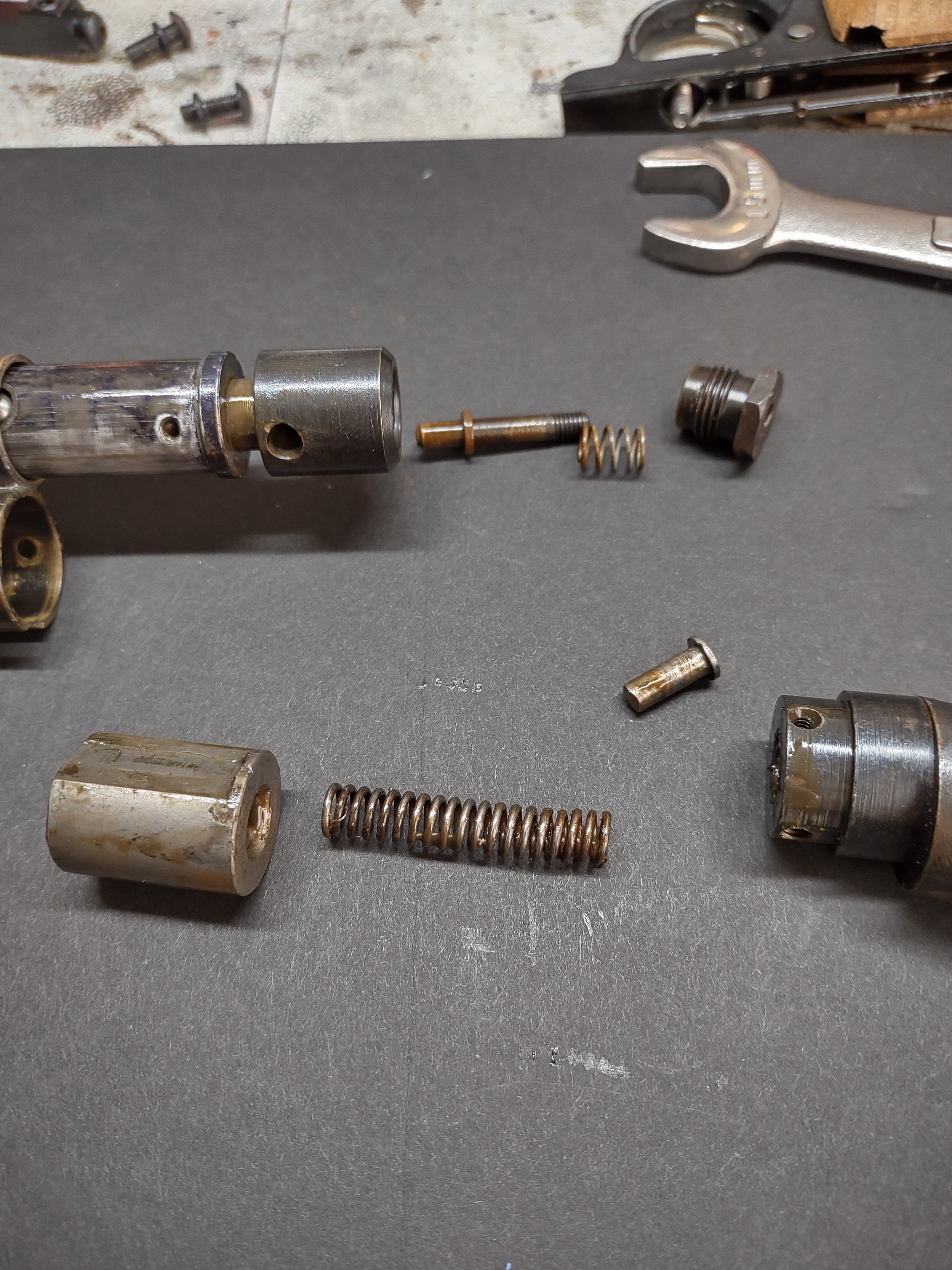

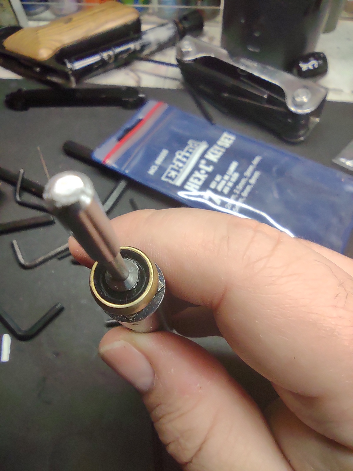

              Sorry for the annoyances. This is about as far as I can get without a valve tool, haven't had the chance to make one yet. Aside from some rust, everything looks okay, but I'm still looking at diagrams . The valve seems to move okay, it feels a little gritty, so, working on bashing out a tool.

                  Shoot me your address and I can send you a valve tool. I have a few.

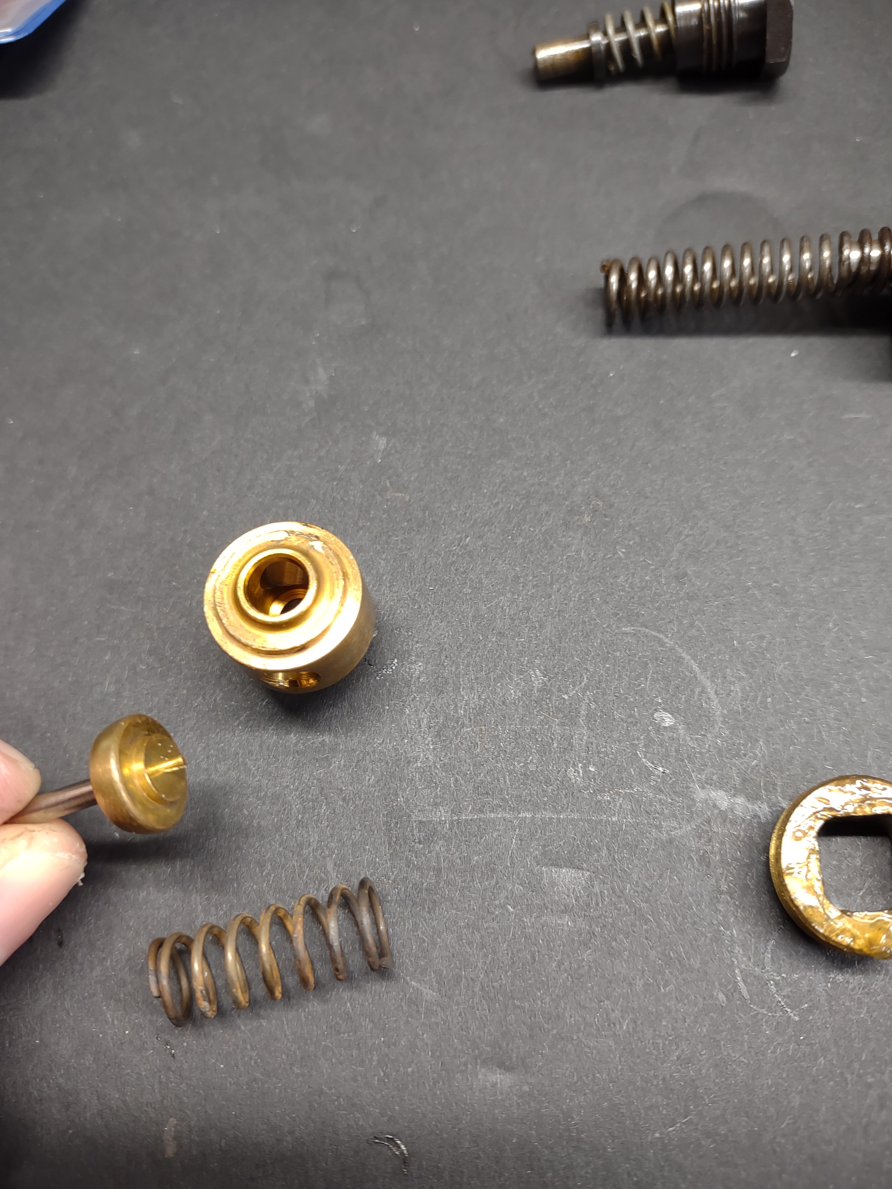

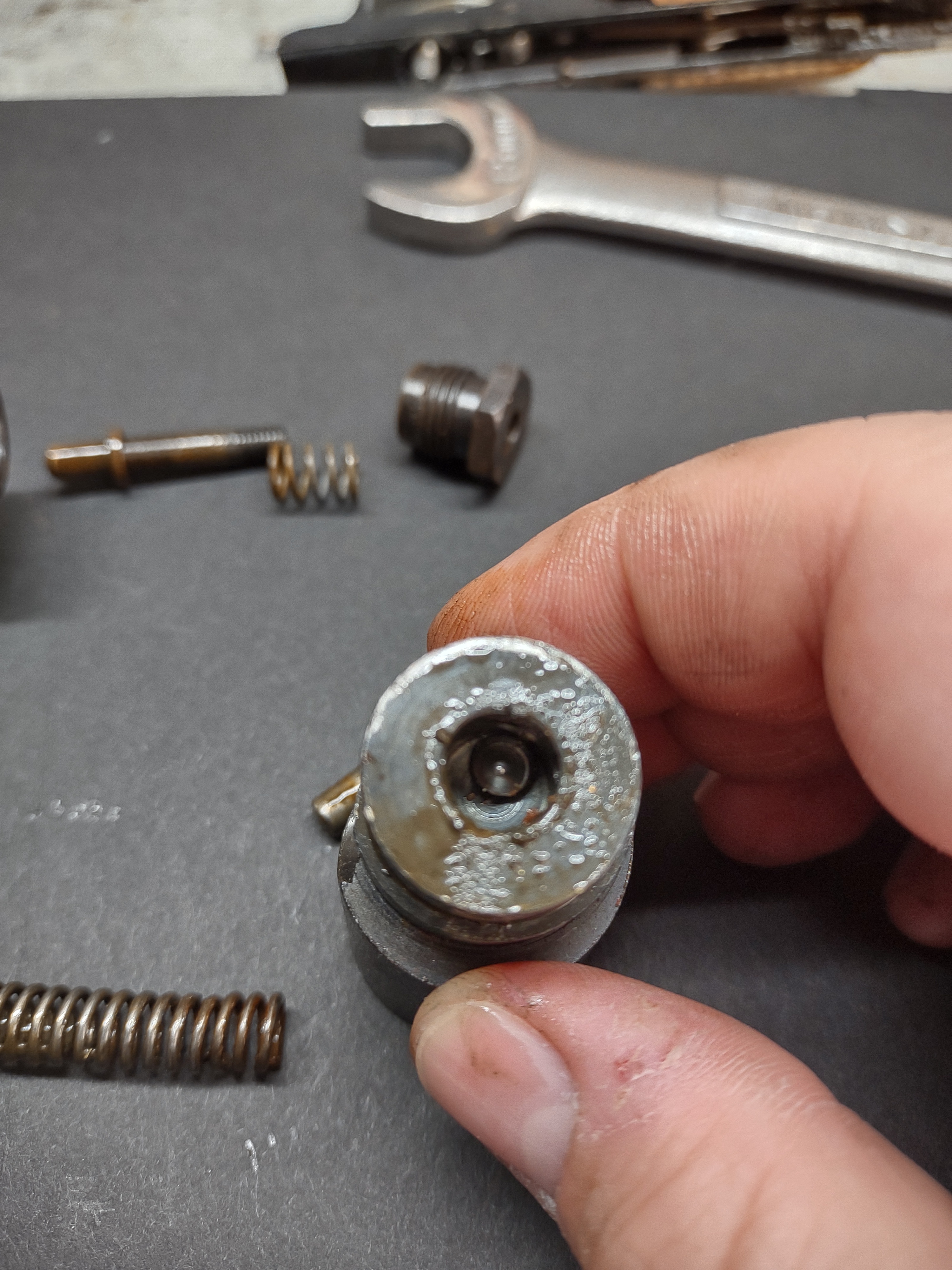

                  Thanks to MAr and his kindness I've finally got it apart. Spring looks pretty gross, and inside the chamber it's kind of dirty so gonna clean it out. Looks like there is a little bit of marring on the face of the pin. Not sure if that's something I can so but look for a new one. Gonna clean up everything and re-assemble as I am out of air to test with.
                  Edit - found the valve orings. These things are toast! Super hard and dry, and partially pinched

                    • Headshotted
                      Headshotted commented
                      Couldn't have done it without MAr. Looks like an oring kit is in the future and maybe sourcing some parts, but probably not. The valve's a little, well, marred up on the threads but seems to be okay otherwise.

                    Got a rebuild kit from Xenom on the way, but it looks like the seal on the face of the valve stem is a little marred. Unsure if it's a two part item and is supposed to seperate or I am supposed to dig the oring out.
                      XEMON commented
                      If it doesn't have any nicks or crack, it might be OK.
                      Put a healthy dose of grease on there when you put it back together and give it a shot ...
