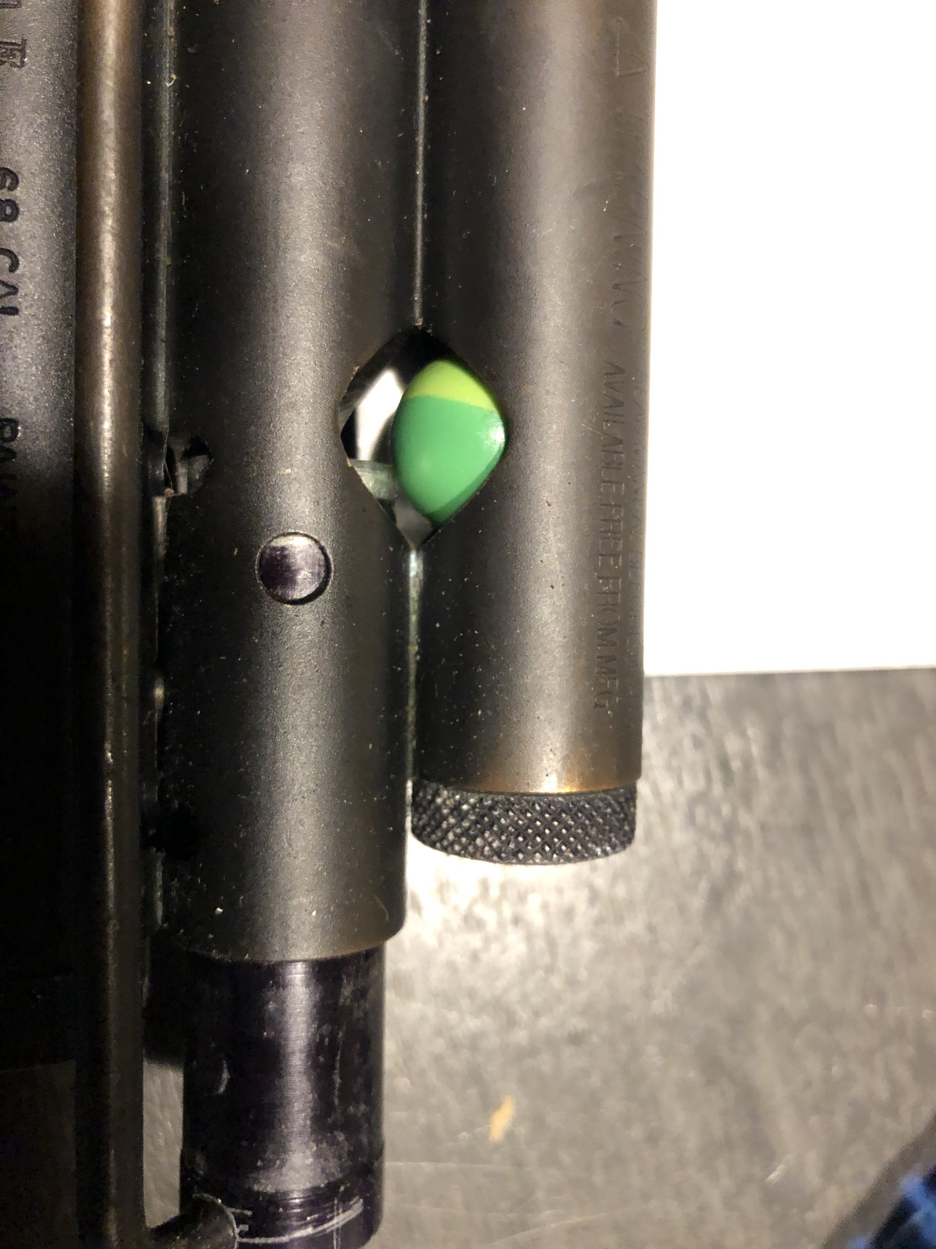

    So it´s been a decade since I worked on a PGP, so maybe I´m just stupid.
    I have a basic PGP. It shoots pretty good, no leaks or nothing. But the when I cock it, the bolt is so far that ball is not falling in breech.
    By the time it the hammer catches there is still 5mm showing, and in order to load a ball I have to really push the pump back.

              Just the stock bolt. This is where it cocks, and its really hard to push further back.

                        Well it was indeed a spring problem afterall. I cut 3mm off and it now works as it should. Feeling a bit stupid now.
