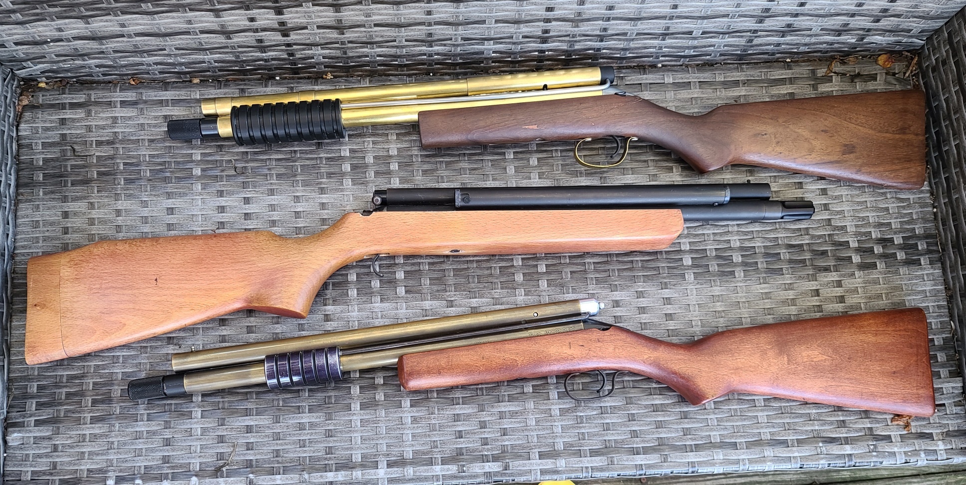

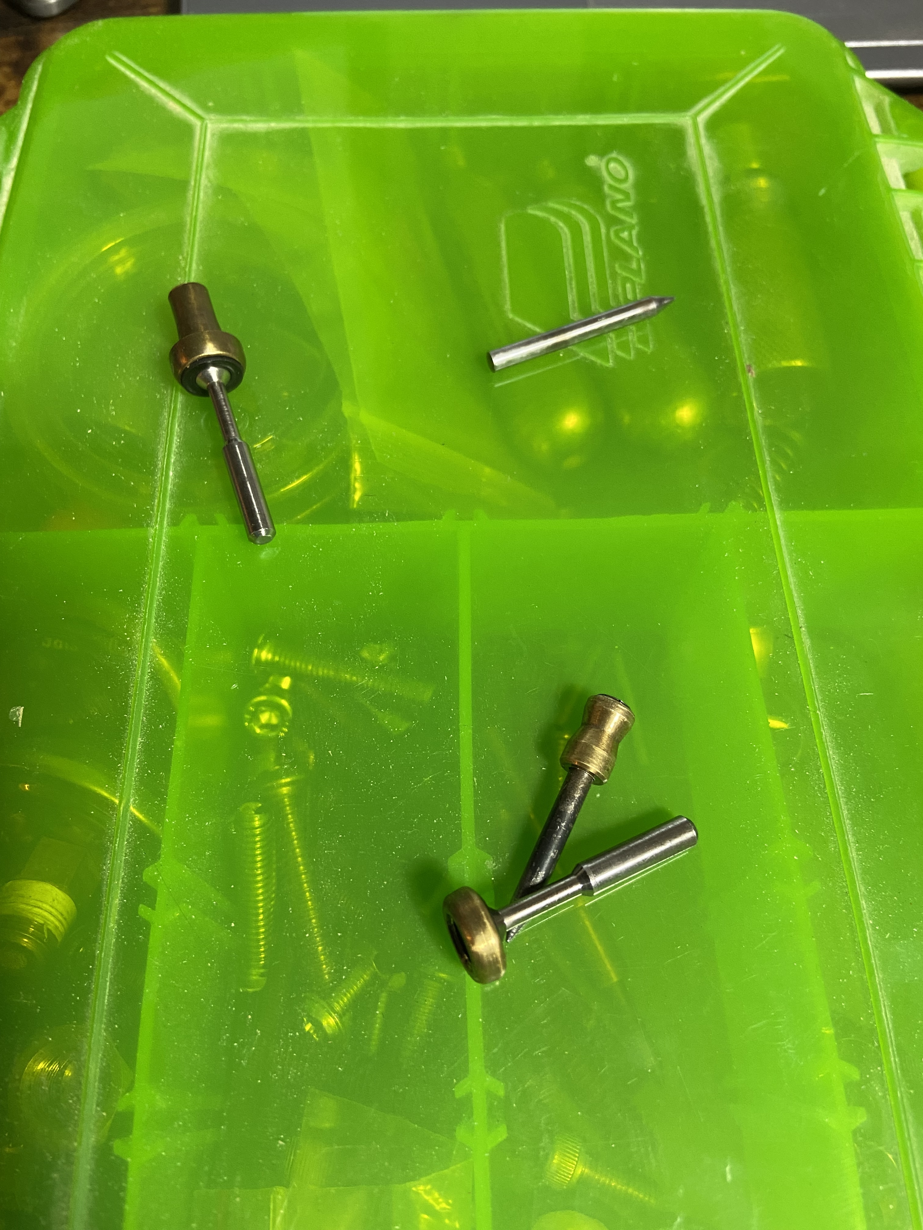

    Anyone run across this? From different K series rifles. K2, KP2 and also a KP3. Granted me and the better half will target shoot often in freezing temperatures, but the past few months I have been seeing different failures with these. Two most recent pictured. Guilty girls attached as well.

    I've had issues with Palmer's coming apart. I just reset them with locktite green 609.
    • jeramiej
      • 222
      Thanks Netsurfer, that was going to be my follow up question.

        silver solder also works (but you will need a new seat)

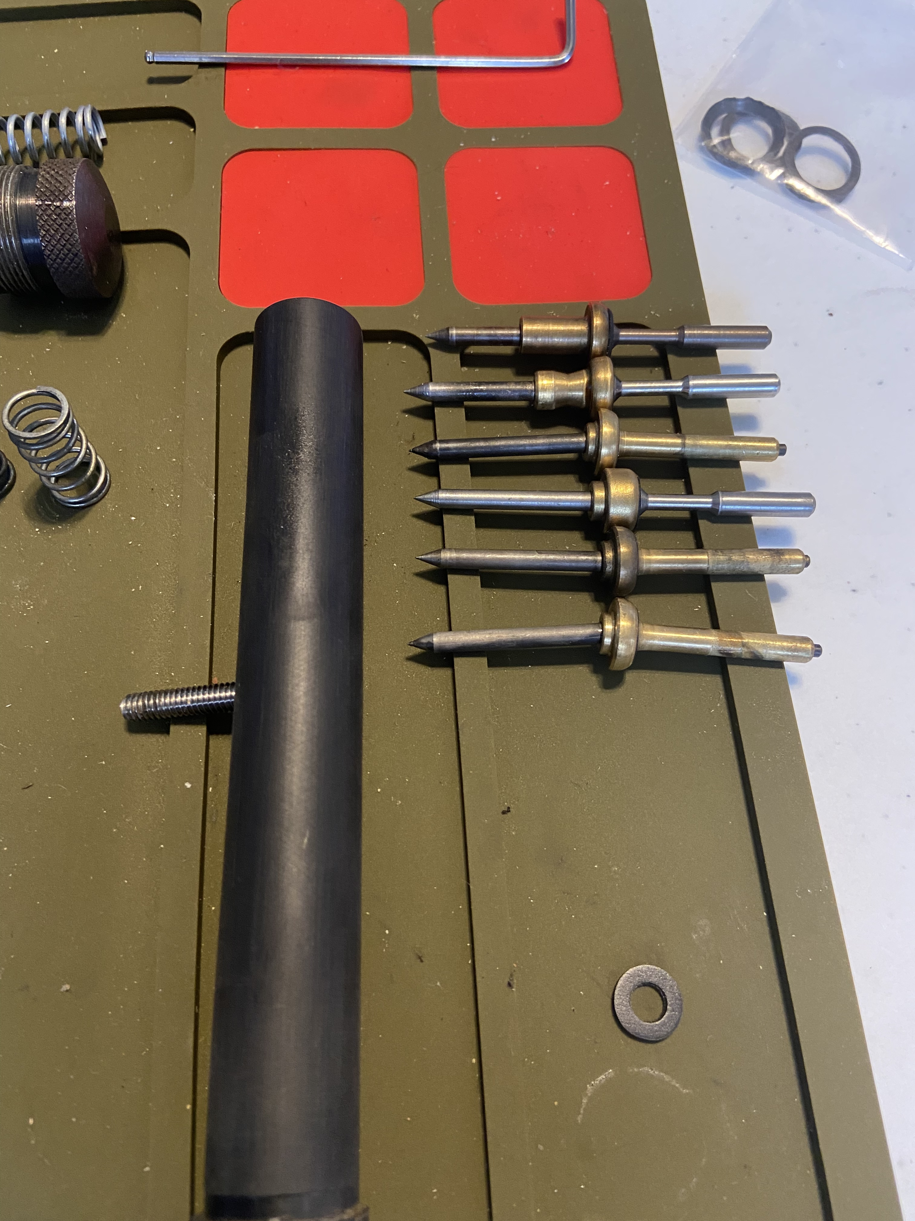

            PPS seems to have had issues with their 12gram Dynavalves lately. Mine arrived dry rotted badly and unuseable, and the lance portion is too long - it gets stuck in the pierced hole in the 12gram when it's empty.

              Interesting on the observation of the lengths, I have a few different lengths as well.

                Had a bunch to line up recently: Click image for larger version

                  I’ve been lucky enough to not break one. But I’ve definitely gotten multiples from palmers that were too short to pierce. Cheated that by making a custom valve spring, soft and short enough to allow enough travel to pierce
                  XEMON commented
                  I went at it the other way, by making a thinner 12g seal ...
