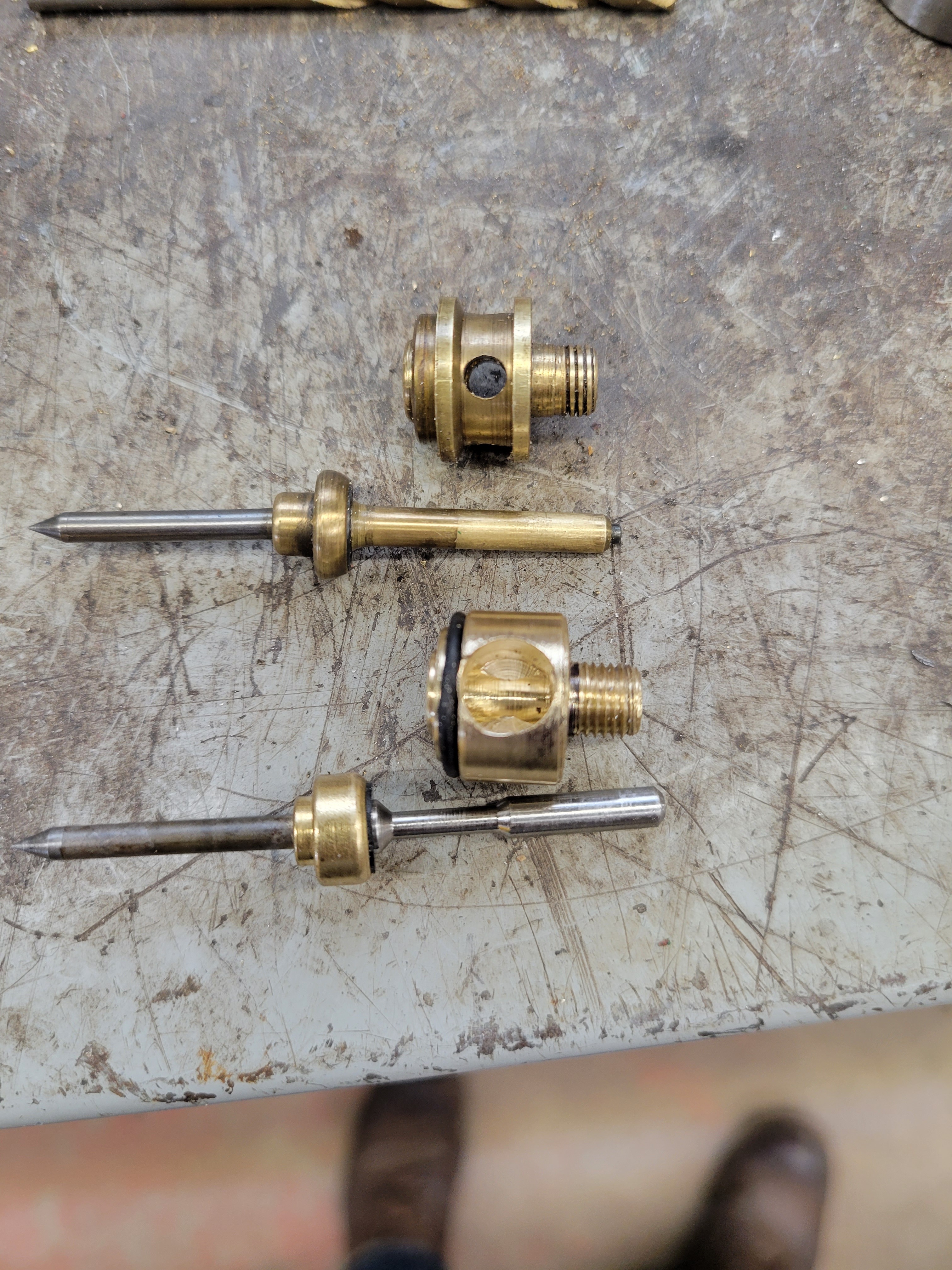

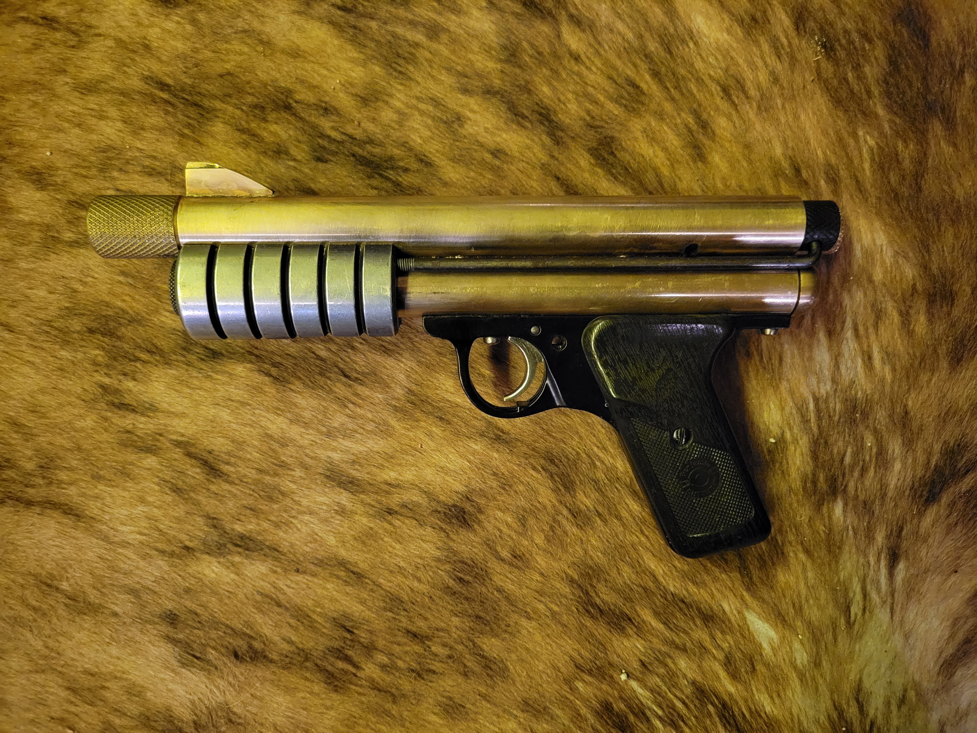

    Got a PGP a while ago, which was missing the top tube for some reason.
    Decided to go freaky.
    The top tube is the perfect ID for freaks, so made a smaller ID tube that the delrin bolt runs in and creates a shoulder for the freak to butt up against.
    Opened up the transfer hole to 5/16" and made a matching valve, just to see if I could.
    It needs a bit of tweaking to the feed ramp on the plug to work consistently, but it'll get there.

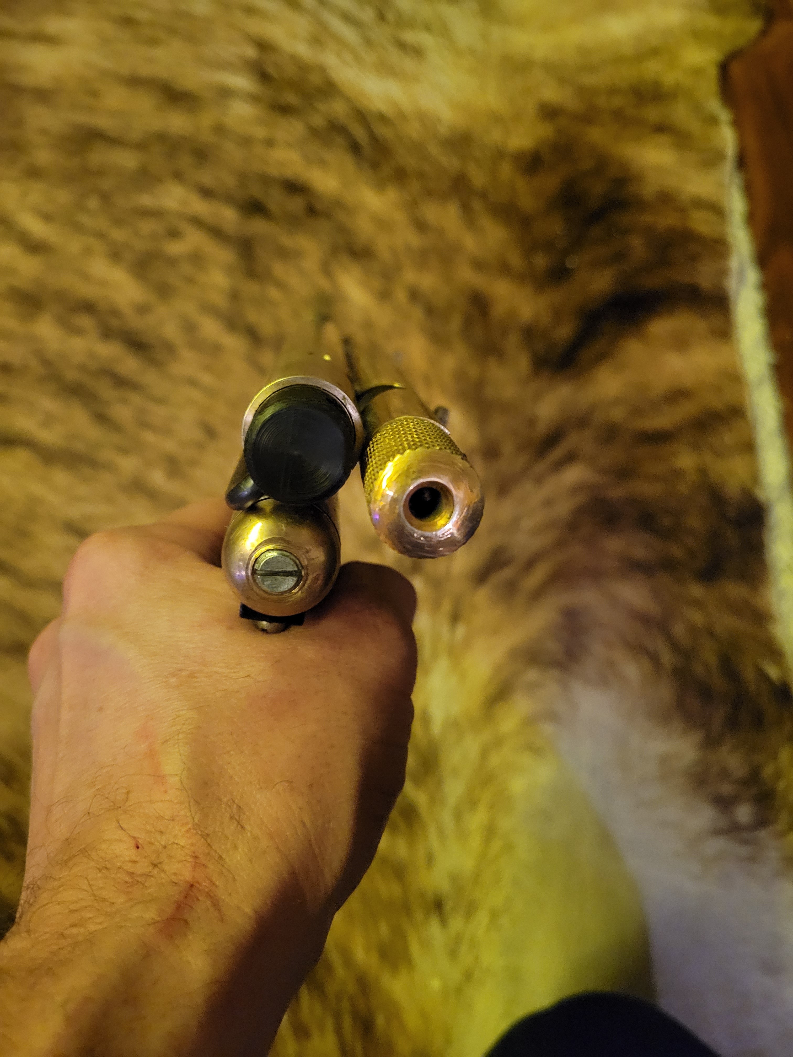

    The knurled freak tip (I was on a knurling rampage for some reason) is held in place by the feed tube nose cap screw, it runs right through to act as a set screw.
    I strongly think may powdercoat, just not sure of the colour.

            How’s it shooting?
            • Oddbawl
              Oddbawl commented
              It's popping at around 265, range is pretty sweet and accuracy appears really good even though this paint is a little dubious.
              It's -15°C here today, not in the mood to go too far with a chronograph to see what kind of efficiency it's getting.
              Soon though.

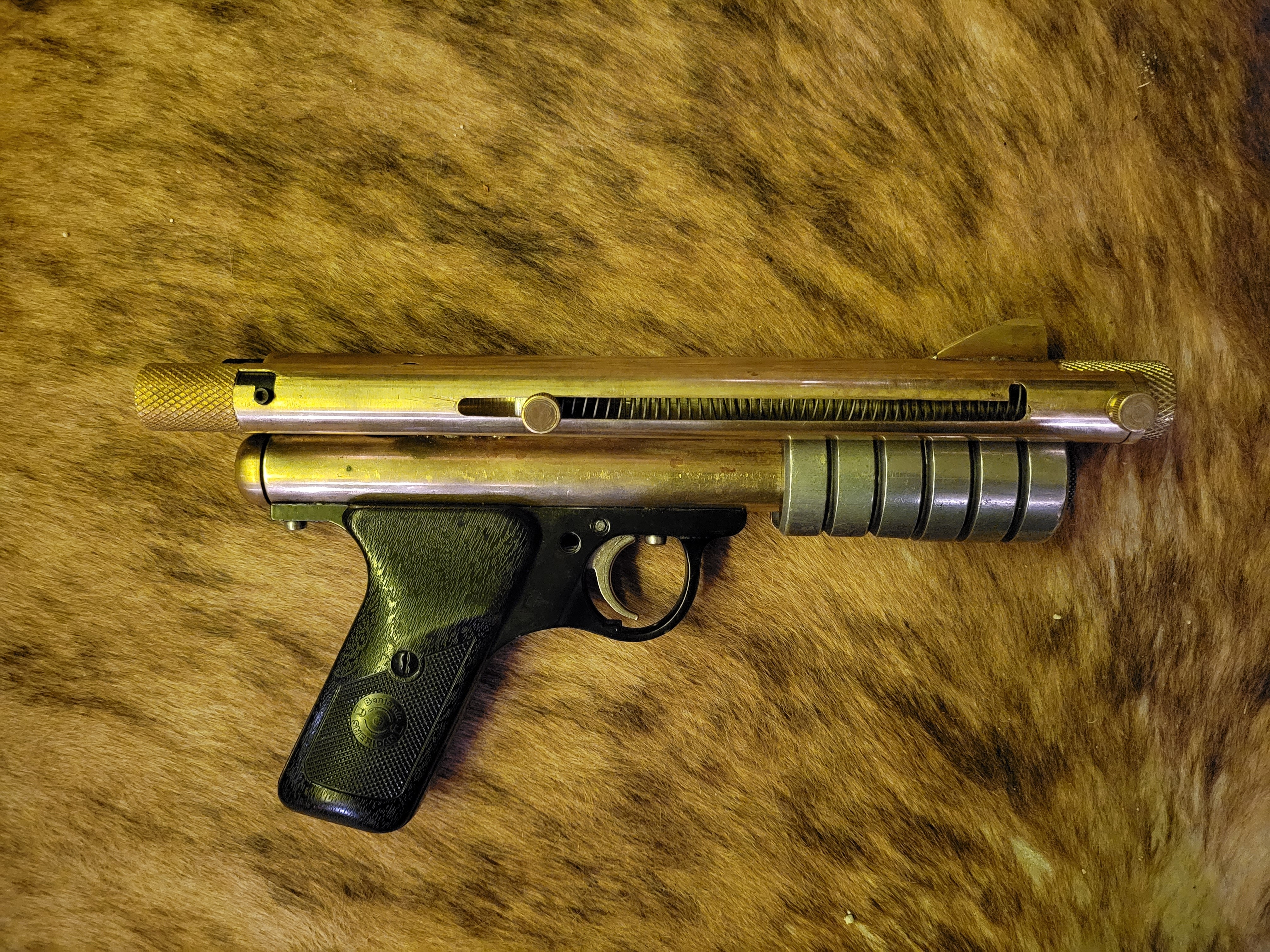

              Opinions on colour? Leave it raw, or was thinking either black satin or wrinkle powder coat.

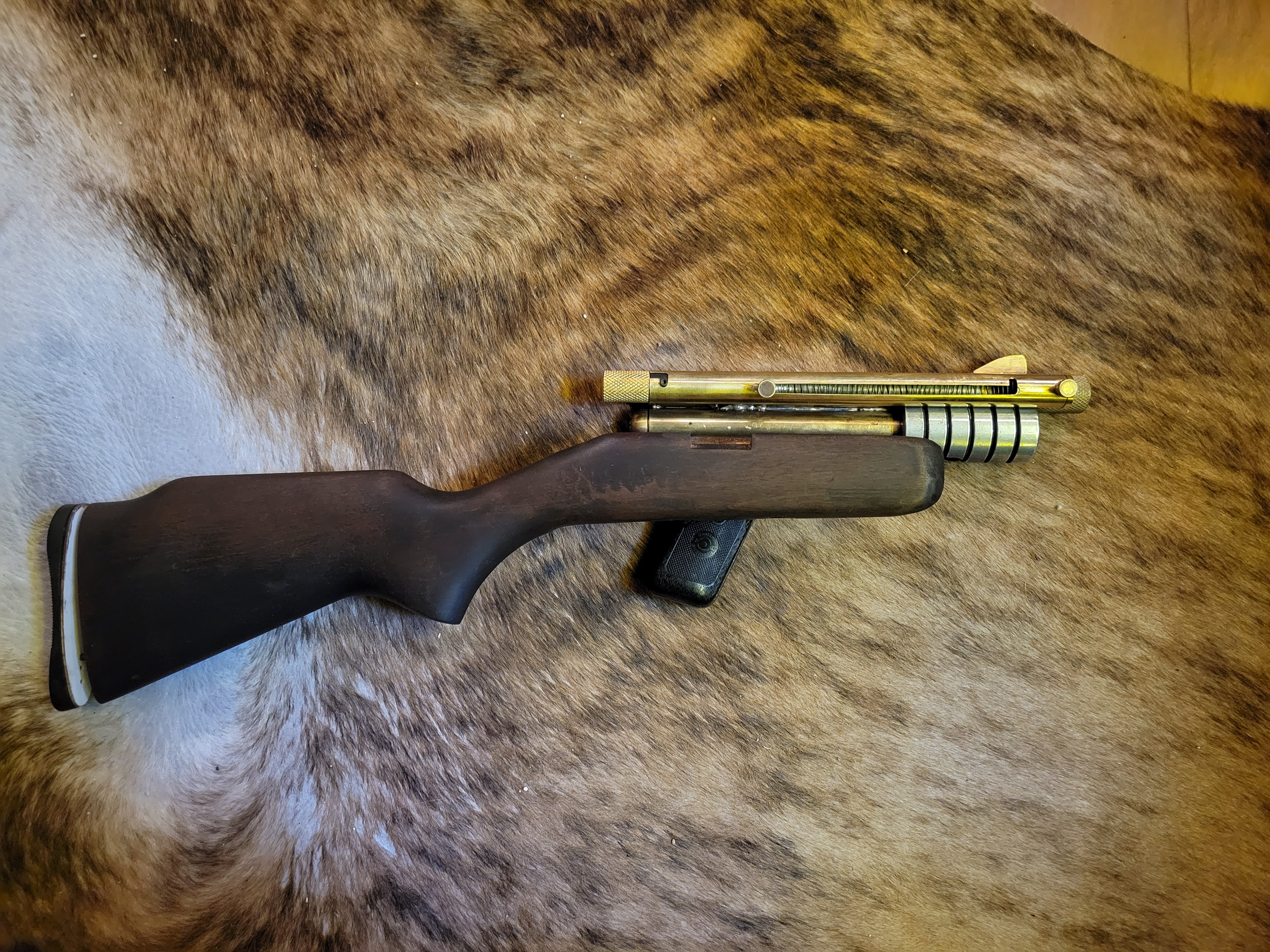

              I have a few Cooey stocks that I've milled out for Sheridans. I may stub this stock a bit shorter and lengthen the pump rod. Something like this (it's just laying on top)
              Or just leave it pistolly.

              • BigRed
                BigRed commented
                I would keep this as a pistol myself. It's a nice setup.
              • packersrule729
                packersrule729 commented
                K-frame it.
                K Frame for sure

                I would leave it how it is, or get a K frame. I will be getting one for mine soon.
