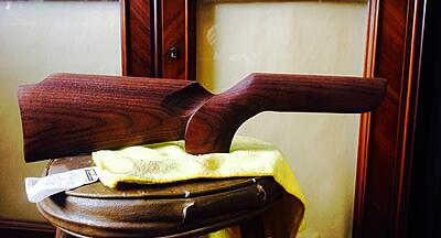

    Member Jeep sent me his pistol and said make me a rifle and make it left offset feed.
    add a few who-who's and a rear site to her please.... oh... a little inlay on the stock would be nice too...
    So I grabbed a piece of walnut and cut this out for starters...
    Unmodded pistola setting on wood stock...

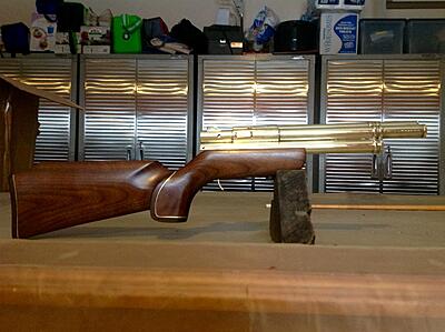

    A few hours later with the rasp and some loven this is taking shape nicely...

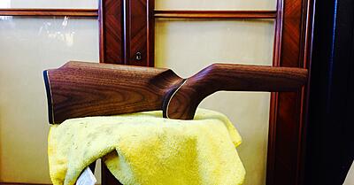

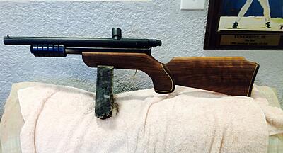

      Another couple hours and she is about ready for the pistola..

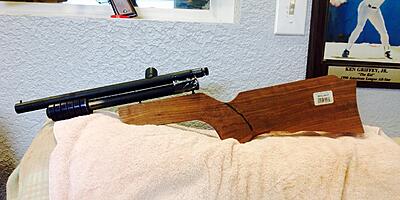

        Inletted and ready for pistola...

          • 6379
          Beautiful work can’t wait to see this in person!
            South Paw
            • 1820
            Wow, That stock is immaculate! You’ve already hit the nail on the head for me, Wally. 3 pics and you’ve far exceeded my expectations.
            Last edited by JeepDVLZ45; 03-11-2022, 10:05 AM. Reason: Make that 4…you’re already posting faster then I can! 🤣
            JeepDVLZ45's Feedback

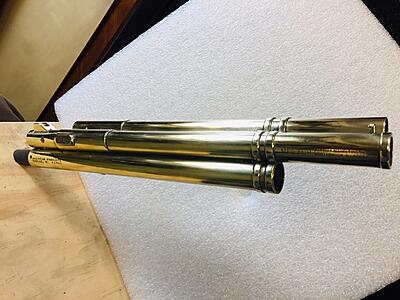

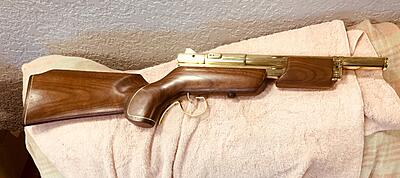

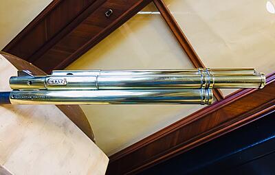

                    Made a trigger assembly from the grip frame and mounted marker in stock so you can check her out...
                    still need to finish polishing her out and make a trigger guard...
                    and the bolt, caps, rod and handle.. etc...
                    WALZ 's Wayback Feedback

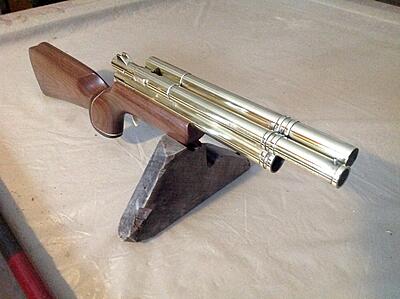

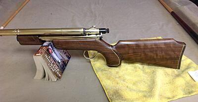

                    Had a little time for this one so I made a trigger guard for her ( not installed) and a pump handle from the fore end cutoff...
                    i need to inlet the pump handle a bit so it rides over the front rings but it fits well.
                    i willl include your stock handle when I send to you also... or if you don't likel this one I'll install your original handle..
                    what do you think...
                    Press on photo for bigger pic...
                      BrickHaus commented
                      I love the pump handle. But at this point Im pretty sure you could polish a turd and Id probably like it.
                      This gives me western vibes. Like it belongs in a holster on a horseback
                    South Paw
                    • 1820
                    That pump handle is great. It really smooths out the marker. Definitely a keeper!!

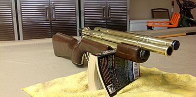

                  • WALZ
                    • 372

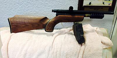

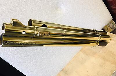

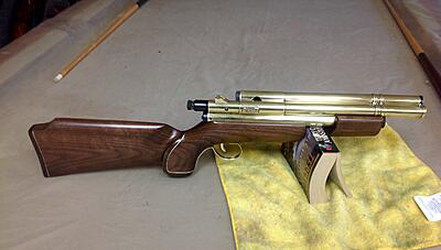

                    Completed this one today... Had to make a new trigger for her, added a palmer high flow valve, enlarged the valve ports and added new seals... and made a longer cocking rod from brass..
                    This one has the stock bore barrel but I added wedets to stop those smaller balls from rolling out.
                    She shoots very well and sights right on.
                    I did manage to break the handle ( don't ask) so I made a new one a bit wider...
                    i did glue the original back together and it seems pretty strong but....
                    im sending both and your original handle back to you also.
                    Very comphy in your hands, she is a bit shorter than a full length rifle and points nicely also..
                    This gallery has 3 photos.
                      BrickHaus commented
                      The trigger is brass? I was thinking of going with a brass trigger, but how does it hold up against the hammer?
