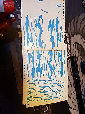

      I have a few brass guns I wanna experiment with forced patina on.
      I also have tiger stripe vinyl decals from when I did my mini mag. I really wanna try polishing a sheridan, putting the decals on, then doing a force patina. Im not sure what patina method to try, and what ones will not kill my decals, plus I'd have to clear coat after the fact. ill leave it with the attached gif.

      I have 2 and a half sheets of these. If you ( who has proven to get stuff done faster than myself) wants a sheet of half sheet, I may be able to send em your way sir.
      • AnarchicArctic
        AnarchicArctic commented
        Those are cool! You should give it a shot when you get around to it. I appreciate the offer, but my project focus is gonna dry up for awhile when the current one concludes. Can only put off house stuff for so long. Thanks anyways though!

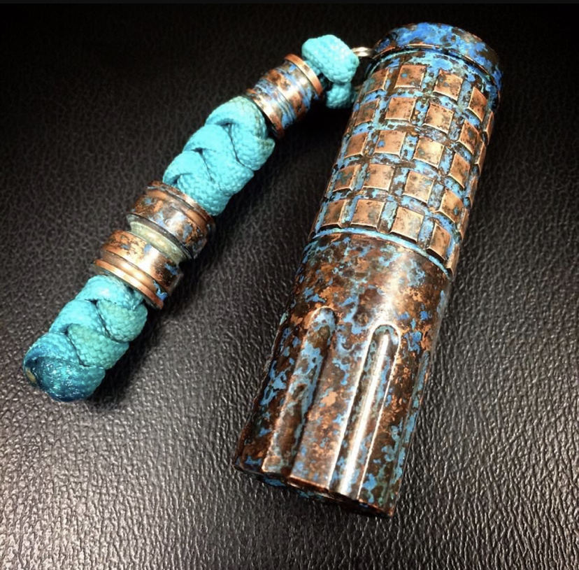

                    • 6401
                    What I mean by Force patina. There is a bunch of YouTube vids on how it’s done.
                    • AnarchicArctic
                      I think the blue comes from salt and ammonia but I could be wrong
                      There is a how to on YouTube for modifying douche flutes that basically walks you threw it. It’s like ammonia salt and time. You spray on the Ammonia and sprinkle salt on it but it needs to be suspended Otherwise you won’t get the marbled look. They suspended it on like a coat hanger so it could be easily rotated. I would plug the important bits lol internals or coat it with vaseline so it don’t mess with tolerance. If you stuck a sticker to it the design would stay polished like Tigerstripe or something would be cool.
