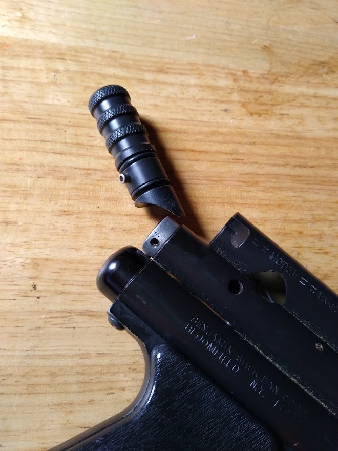

        If you’re looking for a PGP2 feed plug, I created an extended knurled plug that’s held securely by dual o-rings.

        Well I already have a nice feed plug on the PGP I purchased
Name:	PGP 06-03-2022 1.jpg

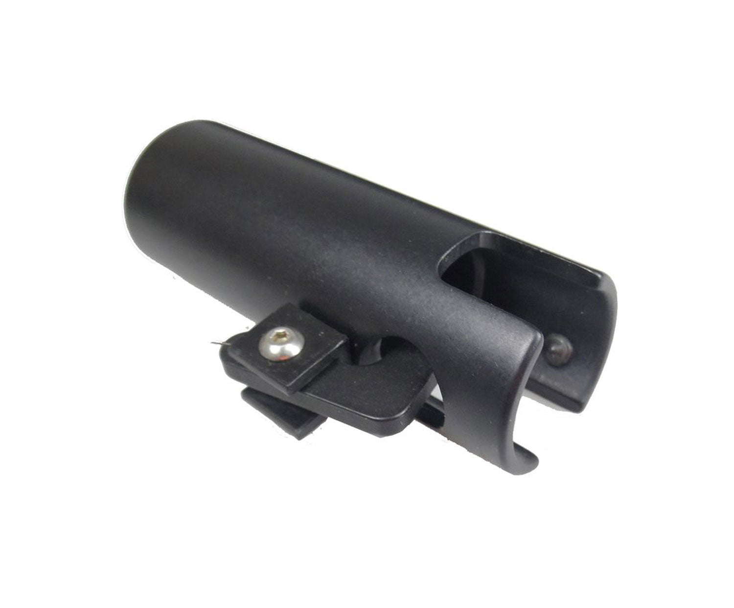

        What I was thinking of is something like Palmer's Sheridan feedgate
Name:	Palmer's Feedgate -.jpg
        I've had such a feedgate on several different PGPs in the past
        But I can't find it on their website
        And figured someone would have printed something simpler and less metallic by now
        The old feedgates would often scratch up the finish installing them and I expect printed plastic would be easier on the surfaces

          Ooh, where would one get that style feed plug?
          XEMON
          commented
          Those are made by PPS, theyre good, but do scratch the finish and can cause jam because they dont protrude up to teh transfer port.
          BrickHaus
          commented
          I used to have one. I personally didnt like it. Reloads are quicker, but I found paint overshot the feed hole as a result of the ball stop being so far back. I MUCH prefer the parabolic style feed plug like the above picture. Ill take a slower reload for a faster pump stroke any day.
