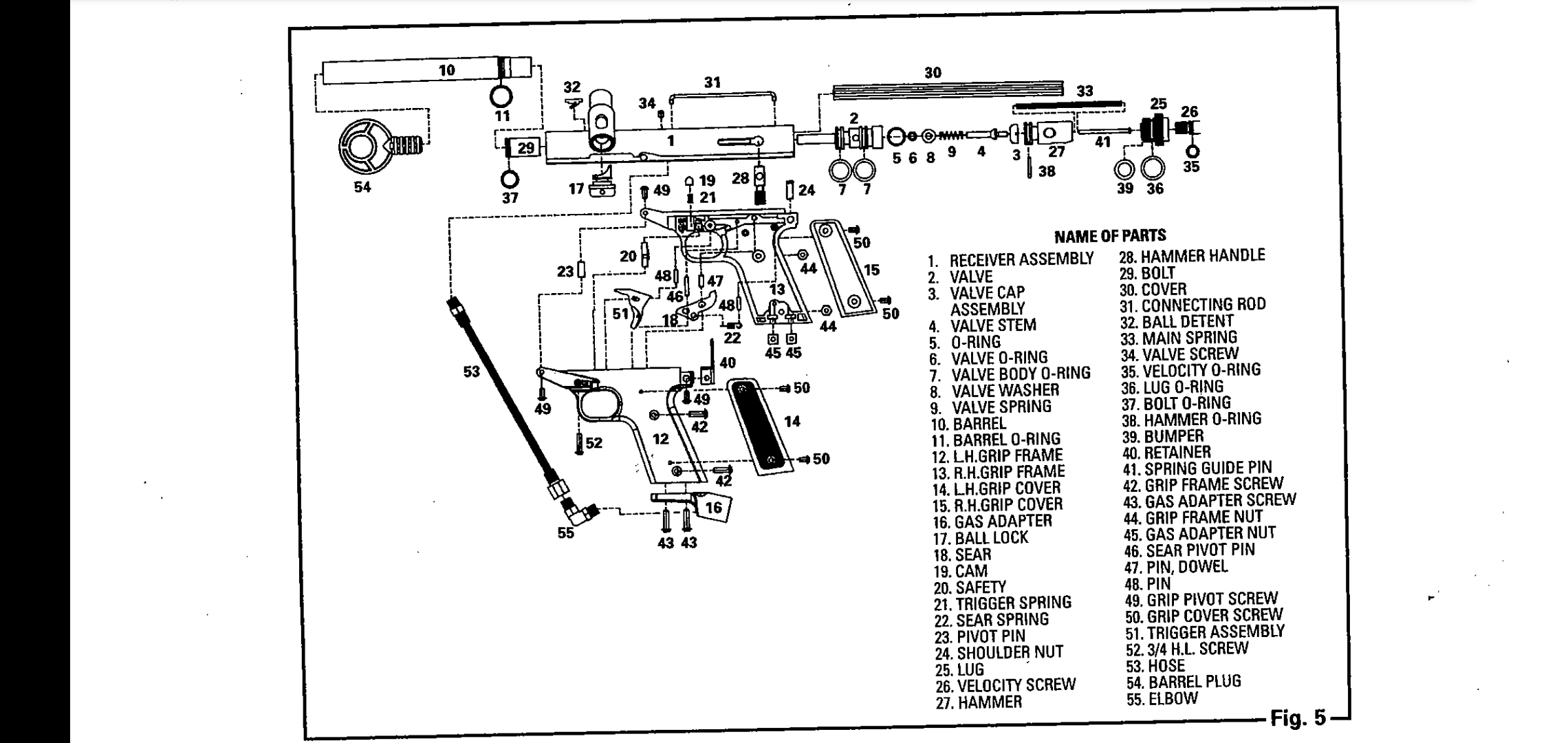

    So I finally got the xts nemesis from a lot I bought last week. Needless to say, it's missing a whole bunch of parts (back cap and probably all the moving internals) . Does anyone have a diagram laying around or a marker they can disassemble and take a picture of? I'd like to get this thing back to life, but I don't how feasible that's going to be now. at least if I know what's missing I can throw a wtb thread up and look for donor markers.

    I emailed Benjamin airguns... they sent me what I needed, will update.

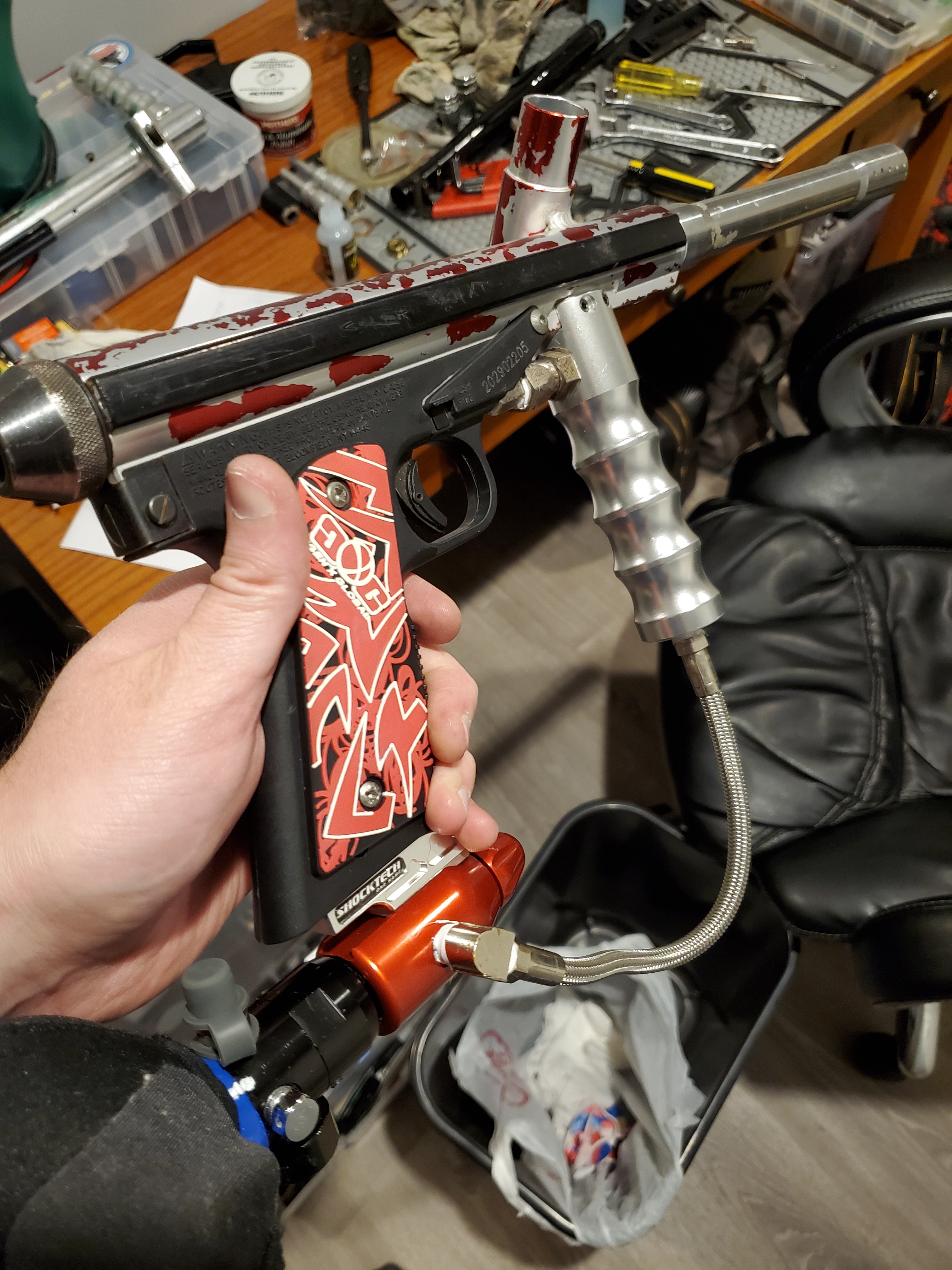

      I've gotten three parts guns and was able to cobble together one so far. I'm making progress on functionality too. This one holds air and fires but does not recock. Once I get that figured out, I'll get proper sized hoses. I also think I've decided to get a mini lathe this winter to try to make parts to get one more of these running.
        XEMON commented
        Being a blowback, you may have to have paint in the breach for it to re-cock correctly
      • Brokeass_baller
        Brokeass_baller commented
        ^This. Try taking the barrel off and dry firing with your hand in front of it.
      • evilfishsticks
        evilfishsticks commented
        I had tried covering the breach last night and I also tried it with reballs and it was still sputtering. I'll try later that with some regular paintballs and check the velocity to see if that helps.
