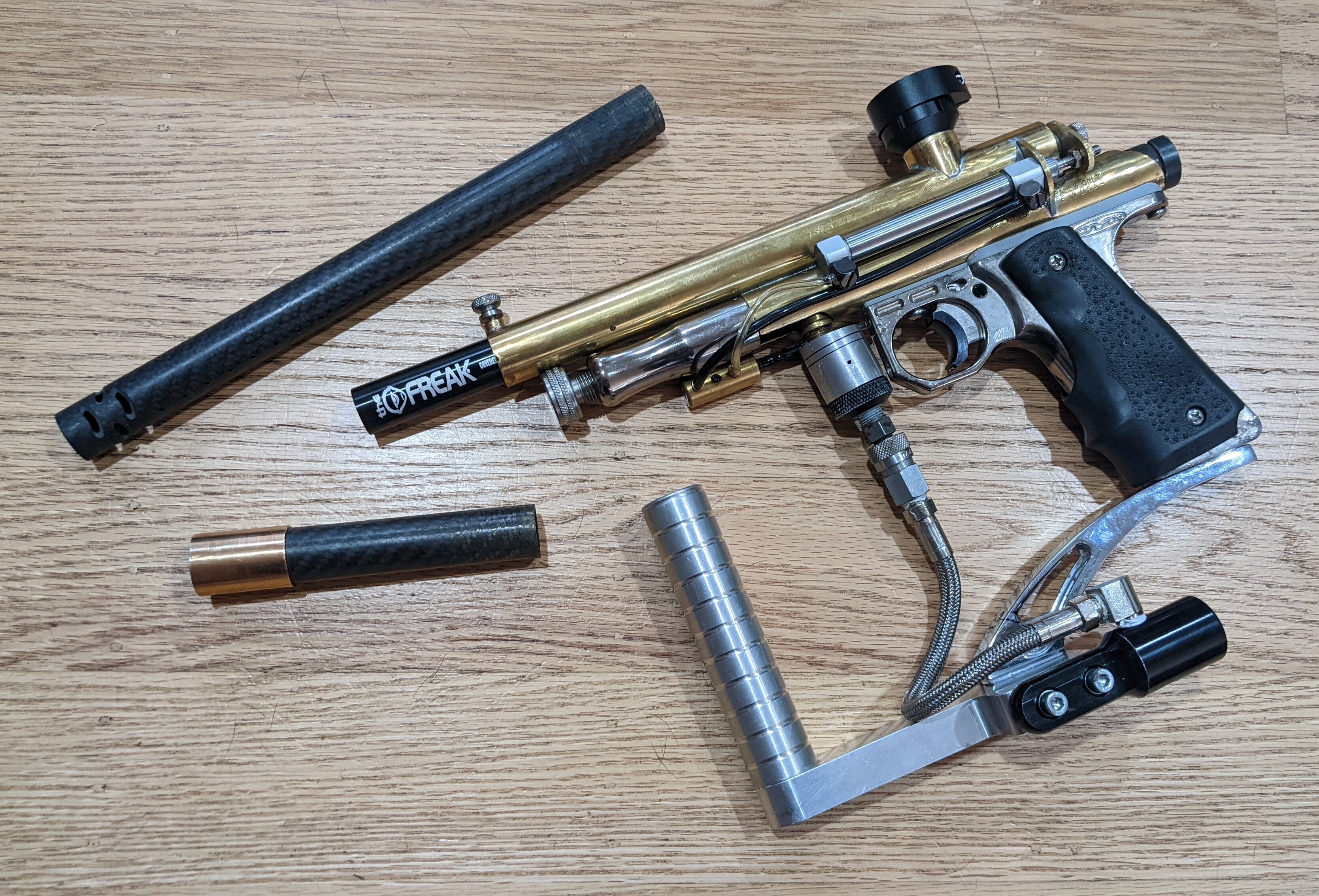

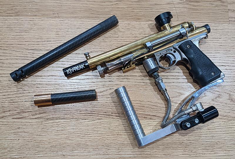

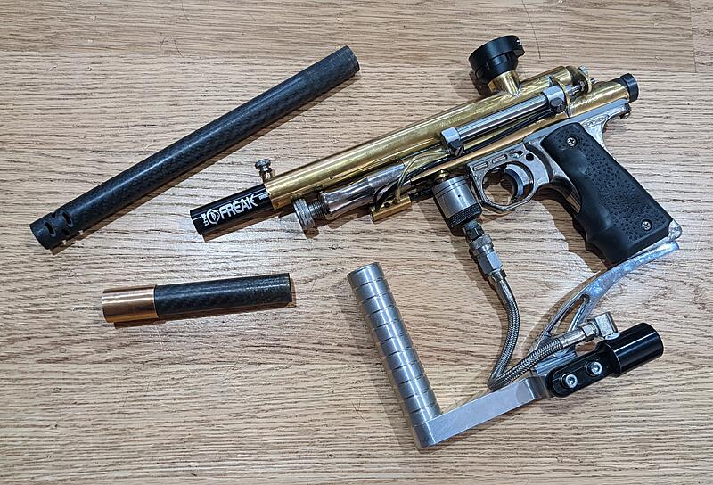

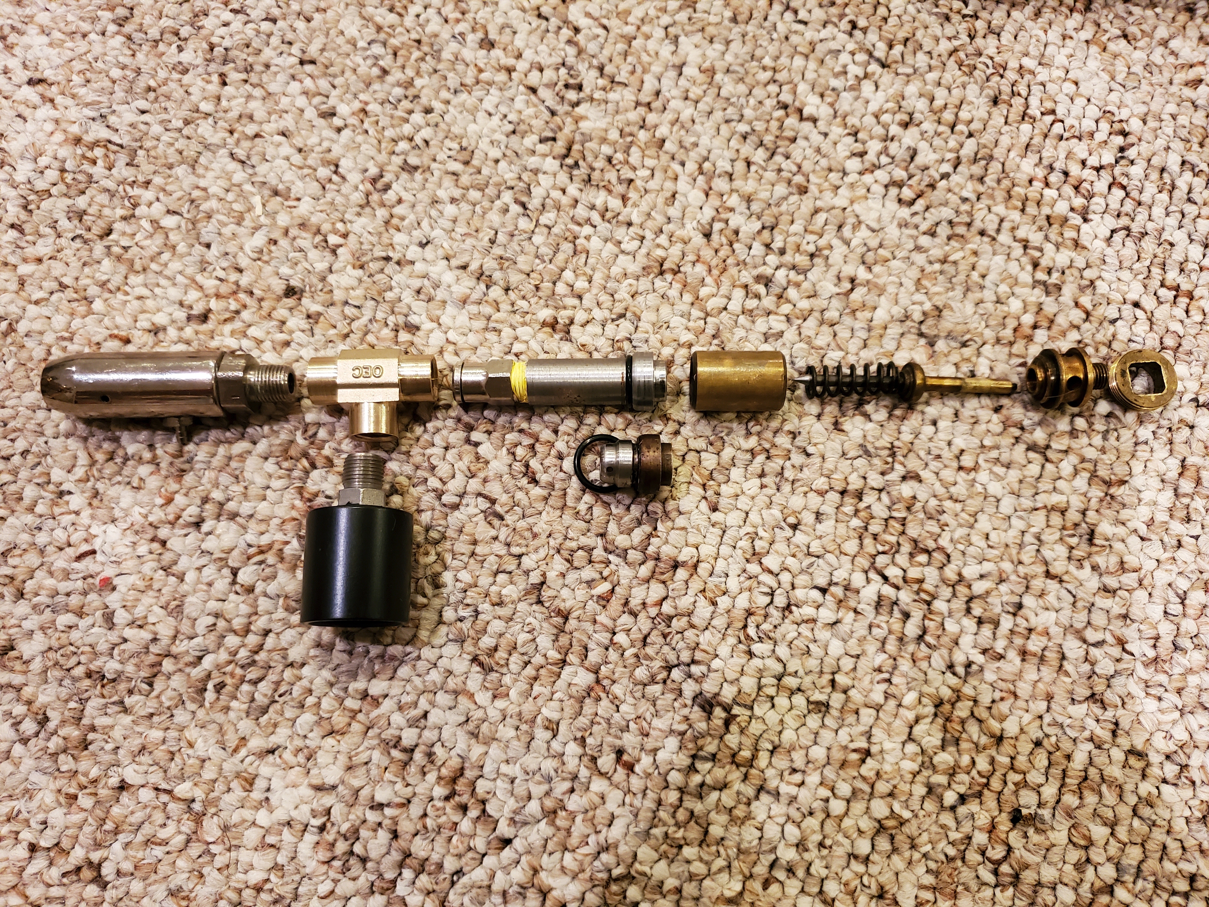

20221208_172338.jpg Thanks for the repsonses. I'm asking to keep my options open for future builds, specifically a double barrel pump pgp. I made a replacement front plug for the component valves thats threaded for 1/8 npt for my current project. I would think hpa sent through a dummy 12 gram would have difficulty getting up to velocity due to the small ports and low valve volume but I don't have the experience to know for sure.
I do hpa direct into my pgp/phantom build and the only changes inside are there is a pps dyna? Valve stem. That’s it
it hits 280 easy.Comment
My FeedbackComment
for side tapping xemon nailed it, and for application I lean towards Jordan's recommendation. I know a dummy 12vie can power a double pgp using co2, no experience with hpaYou do not have permission to view this gallery.
