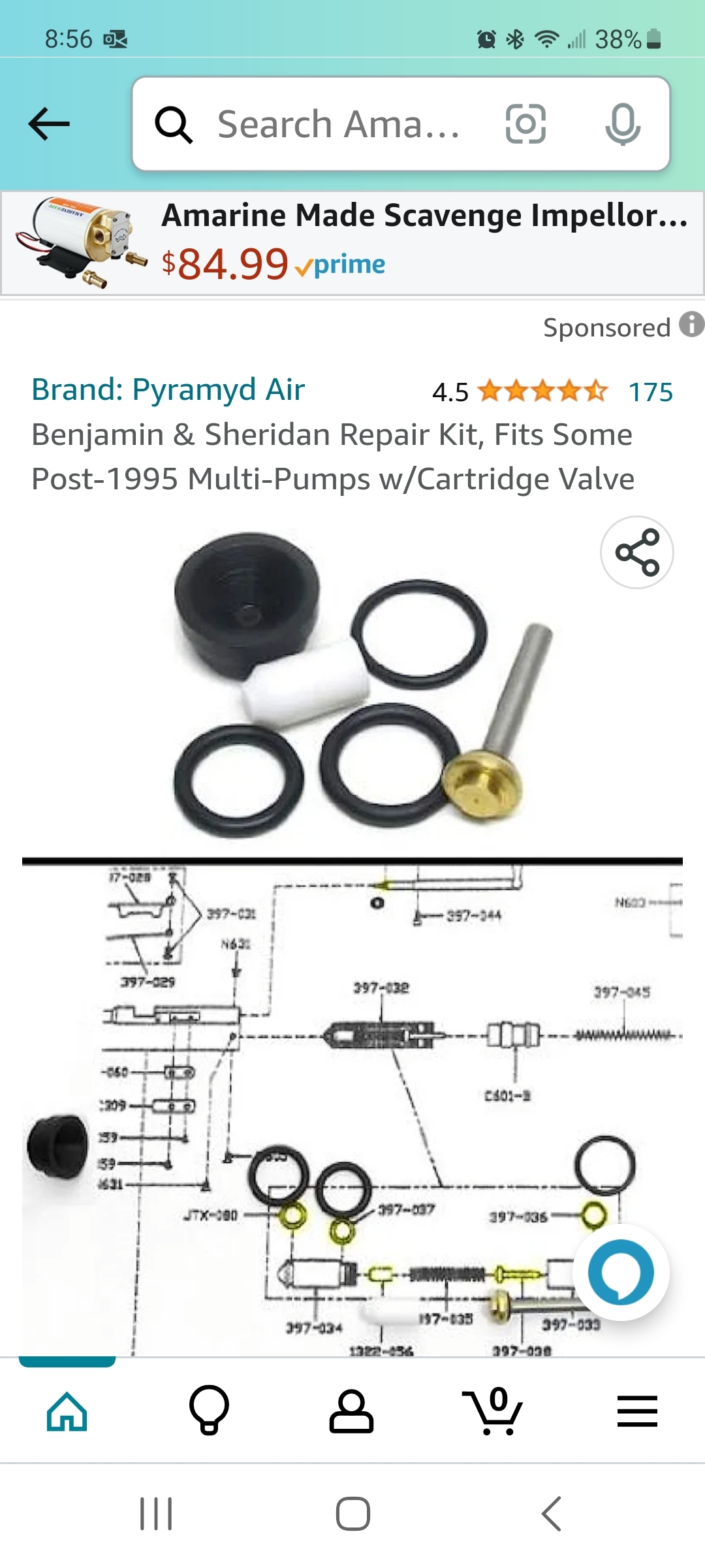

                  Not sure if this will help as well but Pyramyd Air is selling this kit on Amazon
                  Buy Benjamin & Sheridan Repair Kit, Fits Some Post-1995 Multi-Pumps w/Cartridge Valve: Repair Kits - Amazon.com ✓ FREE DELIVERY possible on eligible purchases
