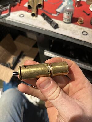

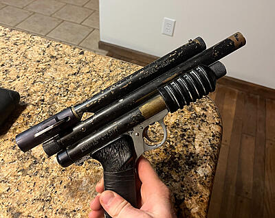

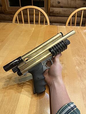

    So when I was at ion last year, paintball dave had a booth set up with project pgps for 60 bucks each, wish I got more, but ended up getting this one and a set of pmi rubber grips for 20 bucks. Finally got around to working on it today and happy to say I got her working/shooting no leaks.
    The cartridge valve was a royal pain in the ass to take apart. Whoever was in there last put red locktite on the pierce pin threads and it pissed me off so much getting it apart that I milled wrench flats on it, so its so much easier to service now.
    I think I'll paint the trigger frame next and that should do it for this build unless I track down a K frame.
    So right now I'm into it for 80 bucks plus about 4 hours labor, not bad in my opinion, now I know how to work on a cartridge valve lol

    Very nice. I think this exact parts combo is how I'd setup a PGP too.

      Looks good. If you haven’t added a pusher to the bolt, I highly recommend tapping the face for a small button head screw. Stock, the transfer port sits below the ball and can wreak havoc on thinner shelled paint
