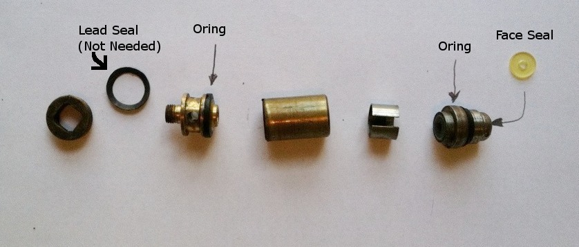

    Guys, I have a PMI pronto long barrel but I have no internals and I don't know what they look like or where I can get any. Any pictures or where I can get an aftermarket internals would be awesome. Trying to convert this into a KP3 autococker. It looks like originate was a 12 gram

    Here is a picture of the internals, as to where buy them, that's a different story ... You might have to make a few of them from scratch ...
    Originally posted by XEMON
    Non cartridge valve:
    Picture credit: MaD
    fetch?id=2352&d=1594587542.jpg ​​​​​​
      Jordan commented
      Everything but the front plug is available at JG Airguns. That front plug seems to be unobtanium now.
      I'm hoping to pick up a mini-lathe this year and start making Instapierce setups that will integrate the majority of those pieces.

    As for aftermarket internals, you could solder on an 11/16 ID lower tube and use cocker parts.
    The stock internals, some of them might be on baccipaintball.com or his Ebay. Happy hunting!

      Oh and talk to Jordan he has more experience with PPS markers and brass cockers. He might have input.
