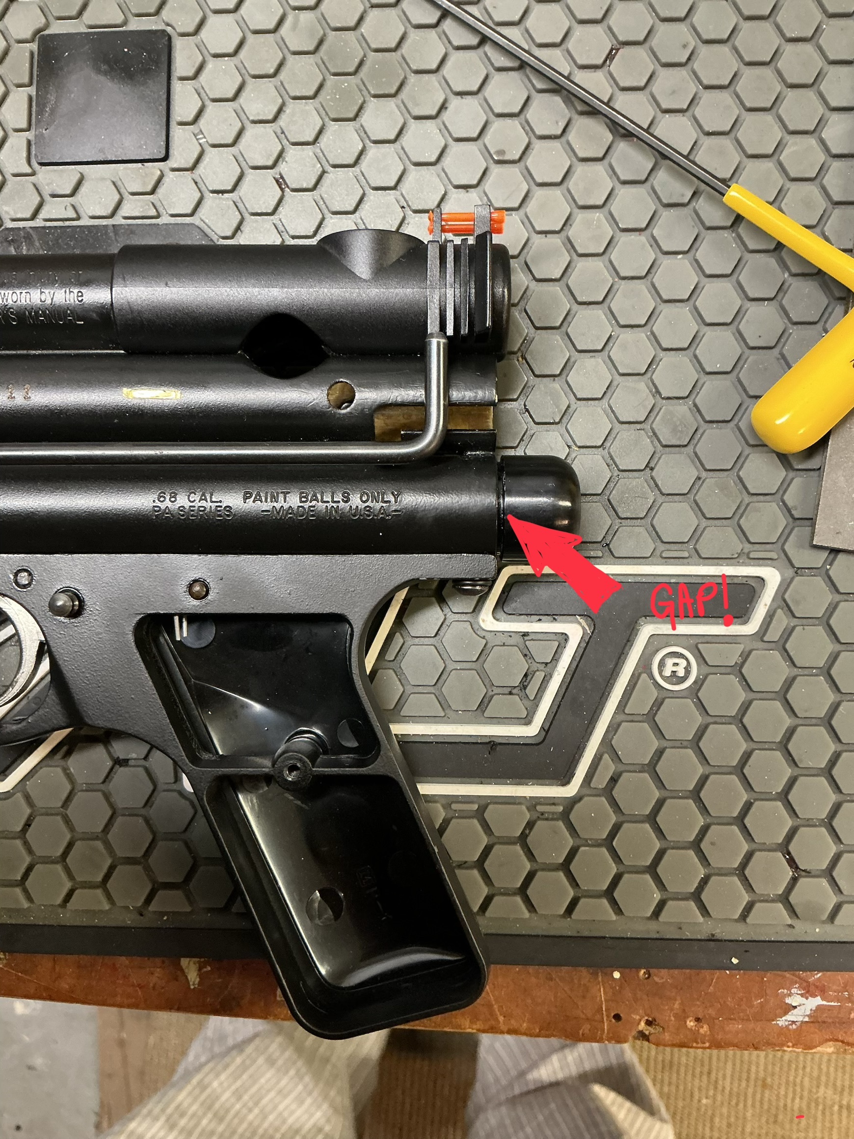

        So Cunha a actually had the answer to this in another thread. took me way to long to find it though - very frustrating! the PGP 2K's had an RVA cap that threaded into the rear body unlike the the older PGP's - if you thread them all the way in its to far. They apparently came from the factory backed out about 2 turns. this resolved the issue. 3 turns and the grip screws become to far apart - at least on mine. I still wonder if a bit of filing on the backside of sear would make it even more consistent and easier to cock.
        2k Hammers also have a recess machined in and the sear can catch on that inner lip early making you think its cocked, but its not. kind of a "2 clicks" and its cocked. I have a spare trigger frame. I may give it a shot and see if it helps. Photo Sep 28 2026, 10 26 27 PM.jpg
