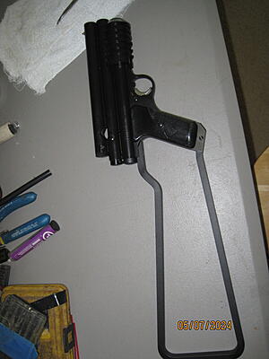

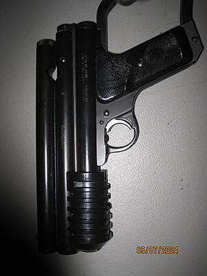

    Thank you for posting the ORing sizes for the PGP....I have a model with the cartridge valve and am looking for the O Rings. I have tried a number of O ring sellers on the web and have to buy a million of them. Can any of you direct me to a site that sells PGP size O rings in small quantities?
    Thanks,,,,love this site.....Jim Aprile
