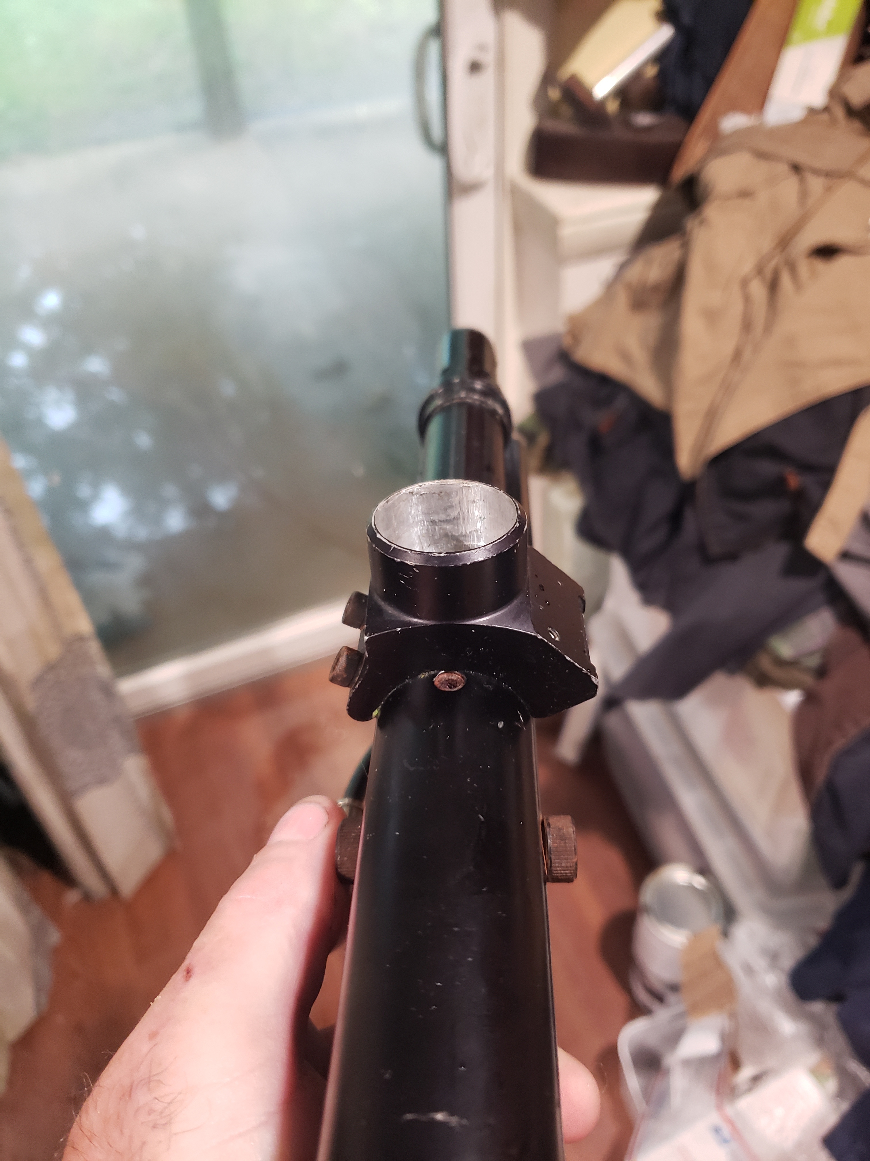

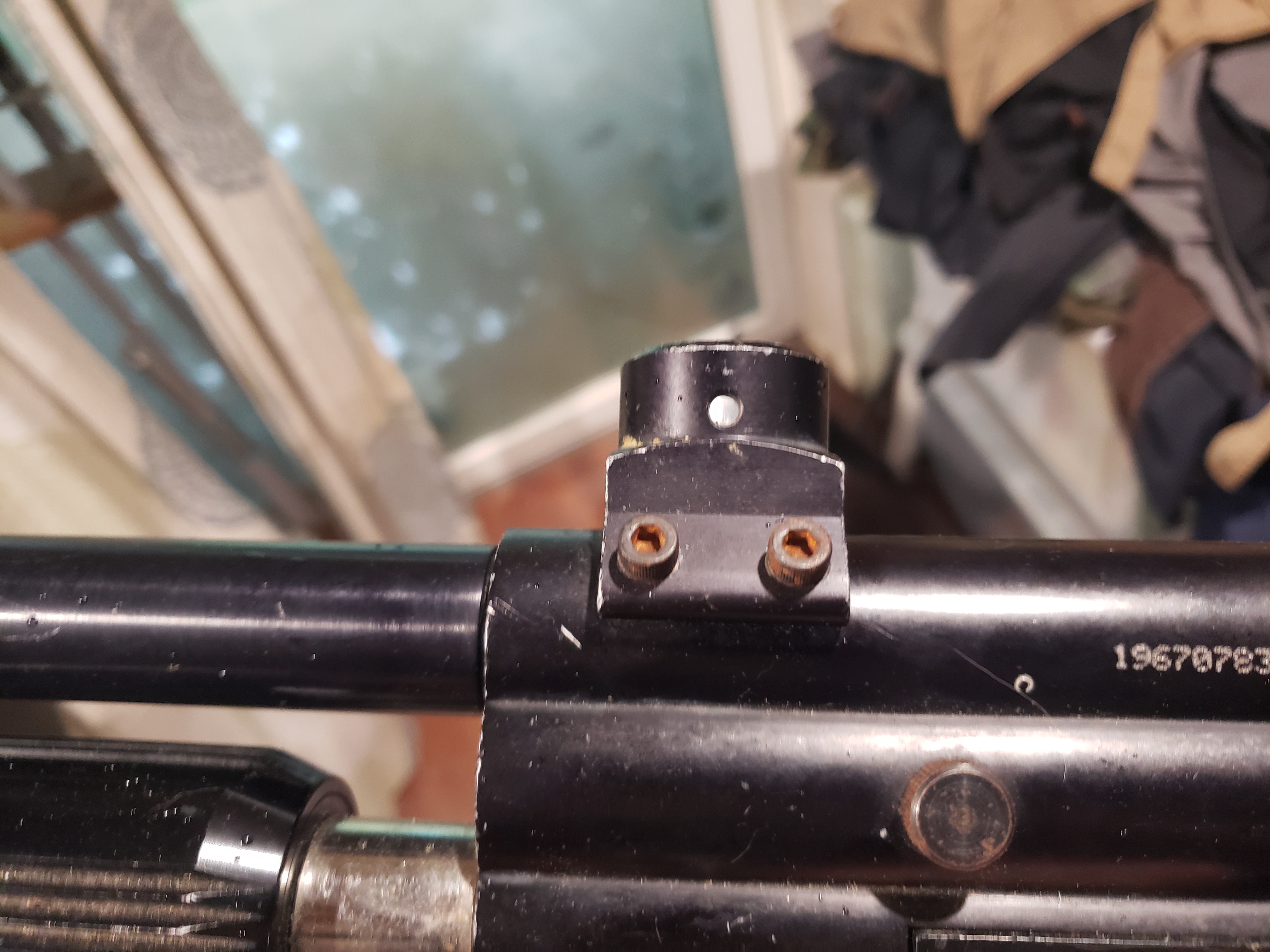

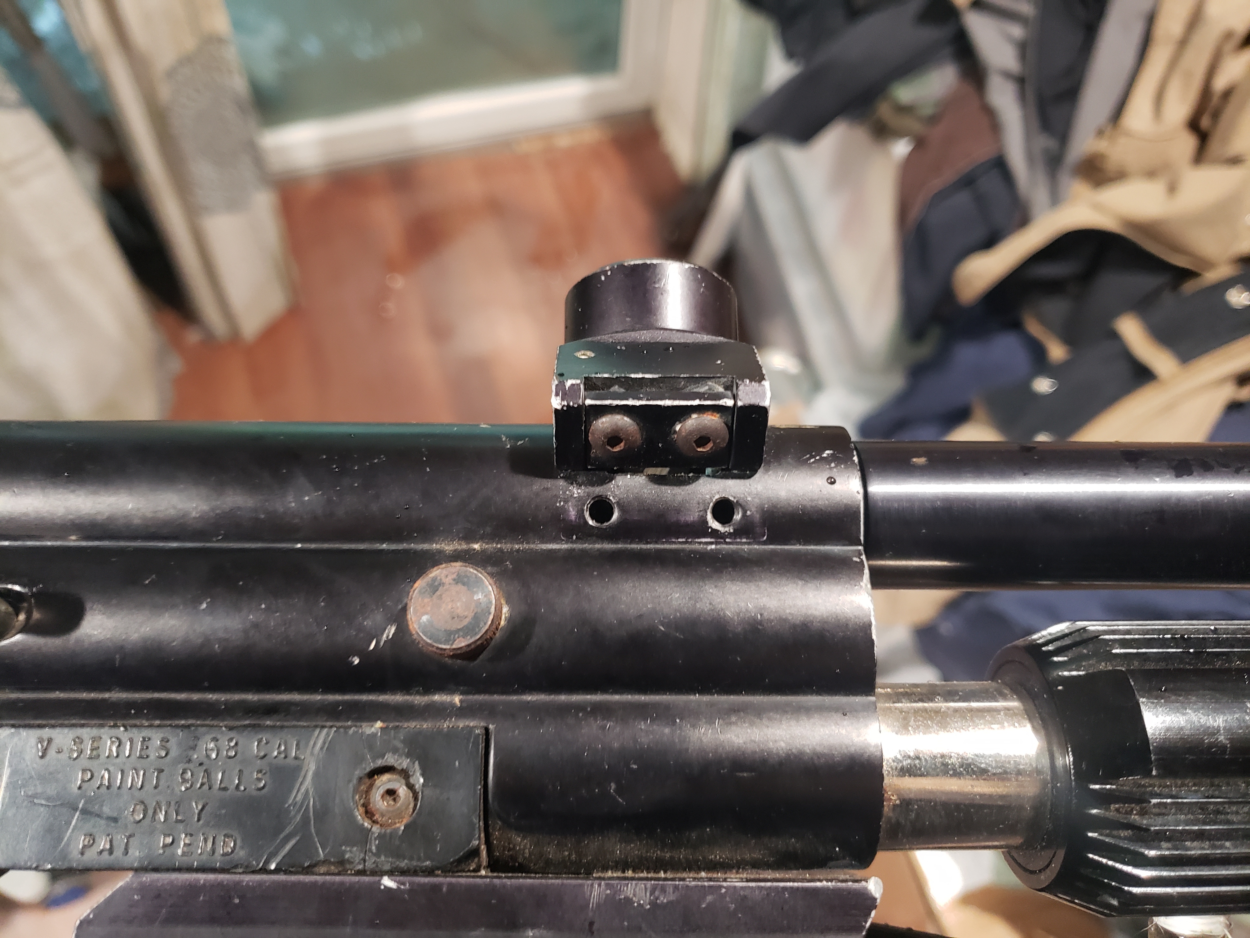

    Brian nailed it, I still have one I 180 flipped and bored to receive a hopper directly.
      Ecapnation commented
      And it's low-rise like the kids like!
    • nicmauro
      nicmauro commented
      Oh, that's the deal, I didn't even think about that and I assume eliminates it being so tall! Any issues feeding, etc?
