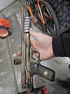

    I apparently went to the wrong topic aea to gather information on my old pmi1.. I'd love to get it functional again, major leak from the co2 adapter area, and probably other areas. I'd guess this hasn't been used in close to 30 years. I'm in a small town in southwest Alaska and am limited on any parts or materials or even general knowledge of this. I was able to take apart and clean well enough for function, but I couldn't go far enough to get rid of leaks. Any suggestions or recommendations for someone who would is reputable and able to work on this?

    What town? I've got a sheridan valve tool and some know how. Maybe a seal kit somewhere. I'm in Anchorage

      Okay yeah Kodiak is a bit out of the way. I would suggest buying a valve tool and o-ring kit and just working through it. Sheridans aren't very complicated. There's only maybe 5 seals in the whole gun and PGPjunkies is offering new cup seals.

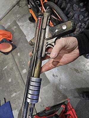

        It appears to be a corrosion issue with the co2 adapter. Also that cool air line may be cracked on the hard 180 bend.
