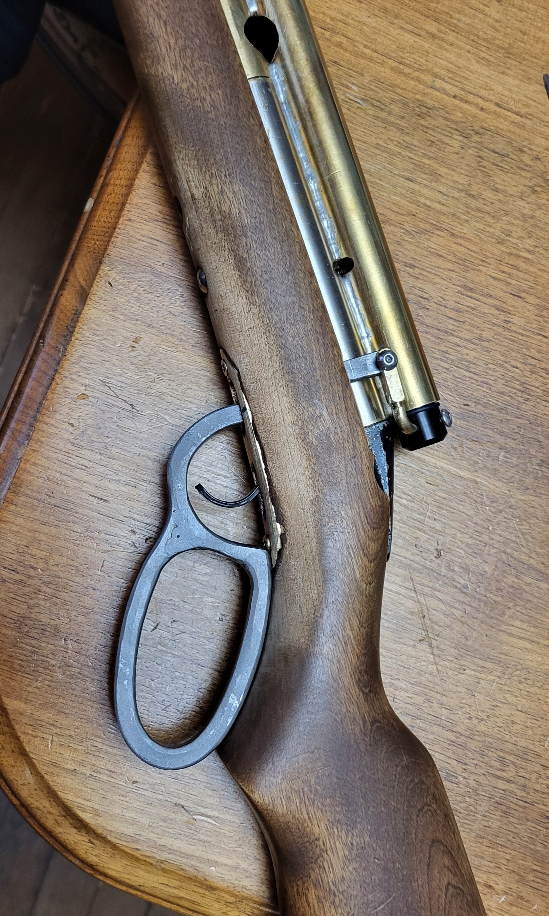

      Lever and arm - done.
      Last thing to do is figure out where I want to install a 12gram changer of some sort... I'm leaning towards a bucket changer in the handgrip portion of the stock.
        Jordan commented
        The lever is one continuous piece (ok - three separate pieces of metal that have been shaped/welded/shaped).

      A bit more work... I'm still tweaking a few things but it's almost ready to start running the plumbing for a 12gram changer.
      I've soldered a feedport cover on one side for now, painted the lever and done a paracord wrap on it, and installed a front blade sight off a Silverstreak.

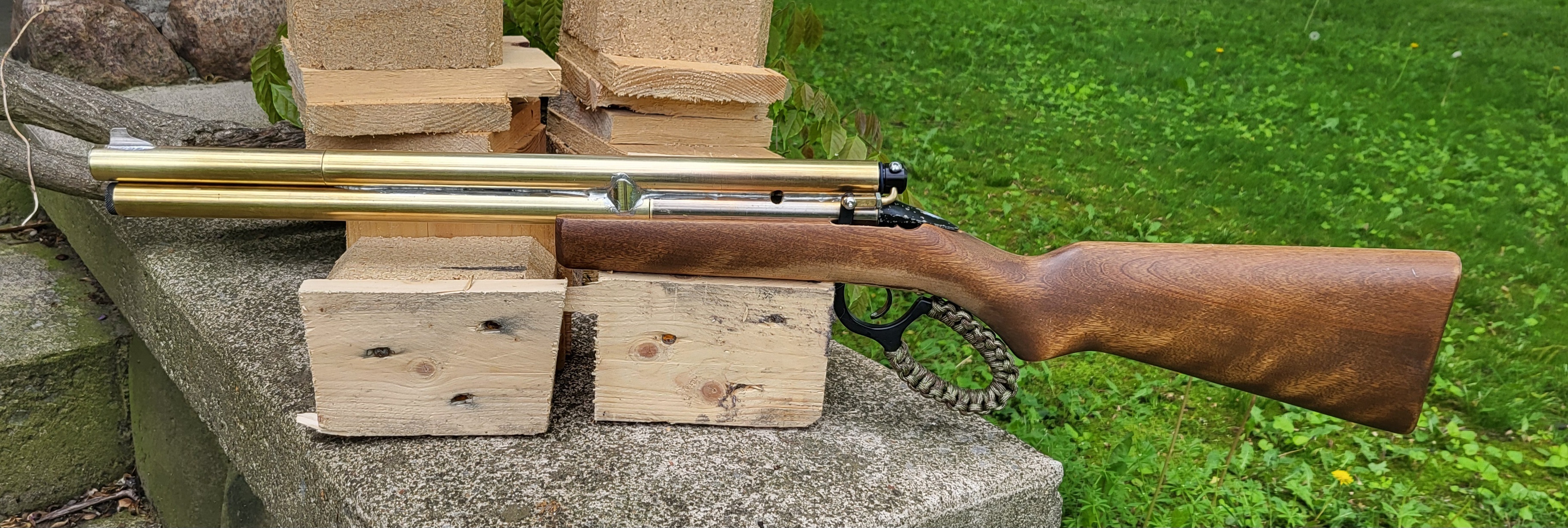

            For Grendel - the double lever lever action. (Twice the lever action, twice the fun! â„¢)
            Almost done - couple little things to tweak or clean up.
              Jordan commented
              Grendel not yet. I'm not finished all the hotwork quite yet, so I just have it mocked up for now.

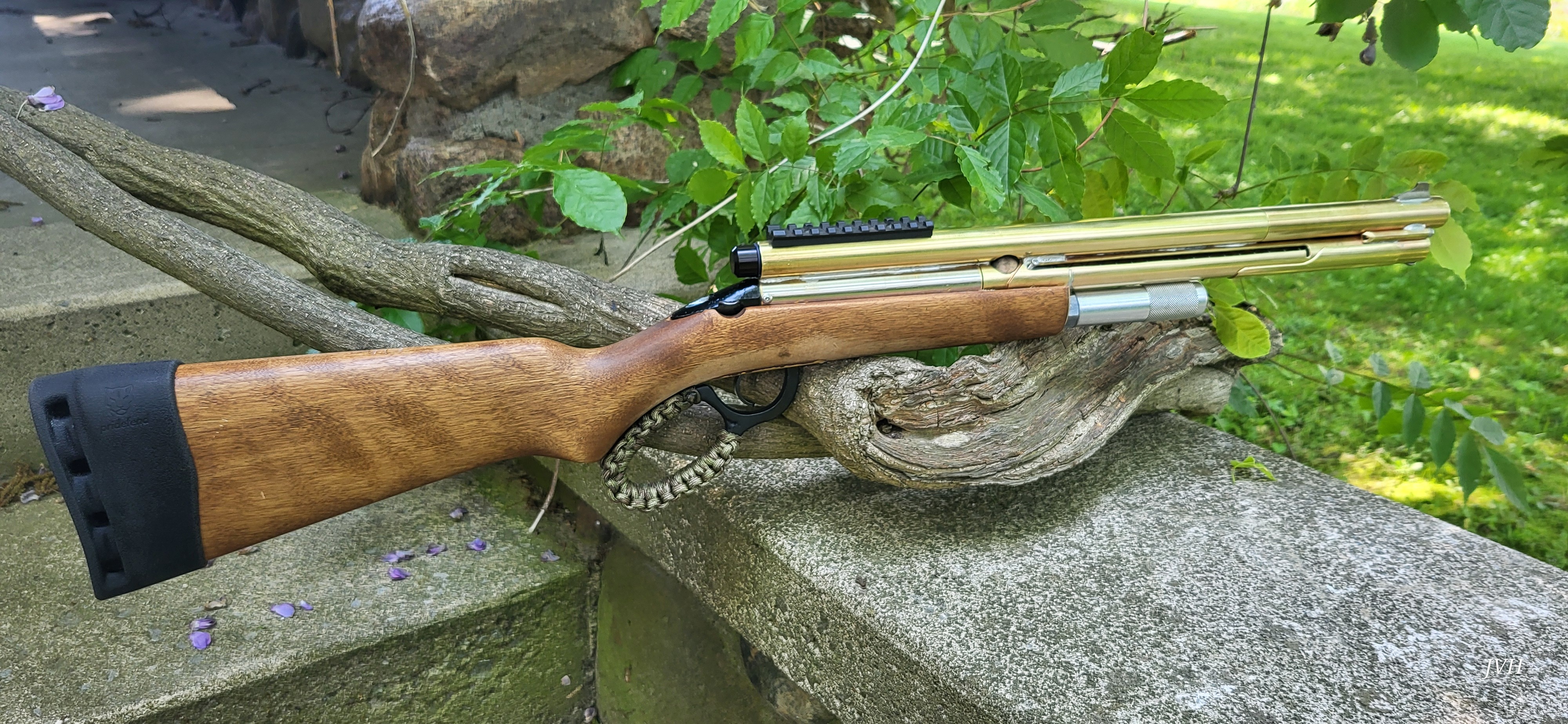

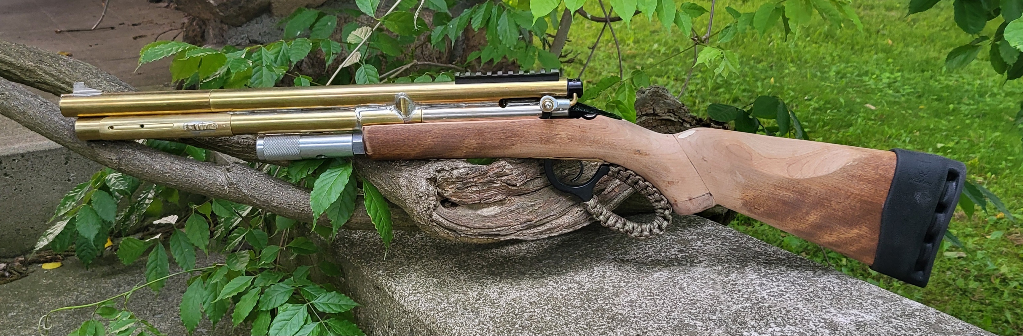

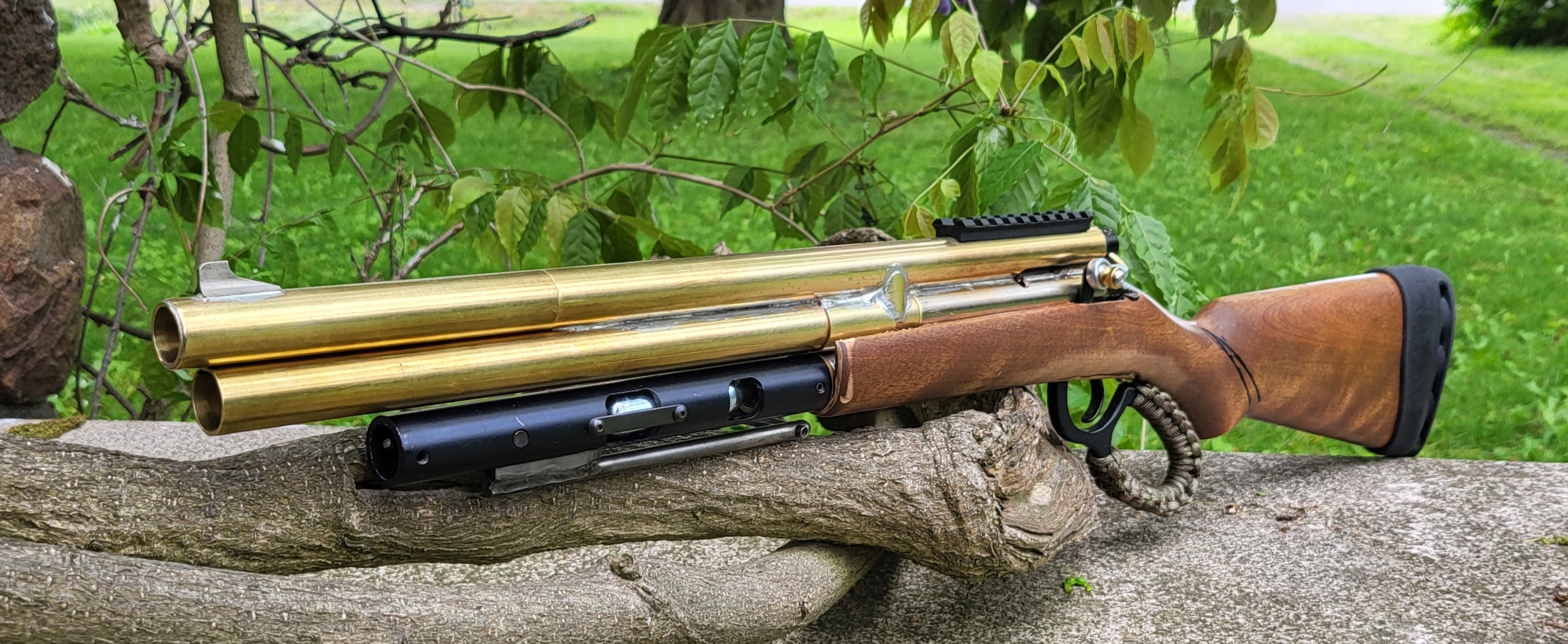

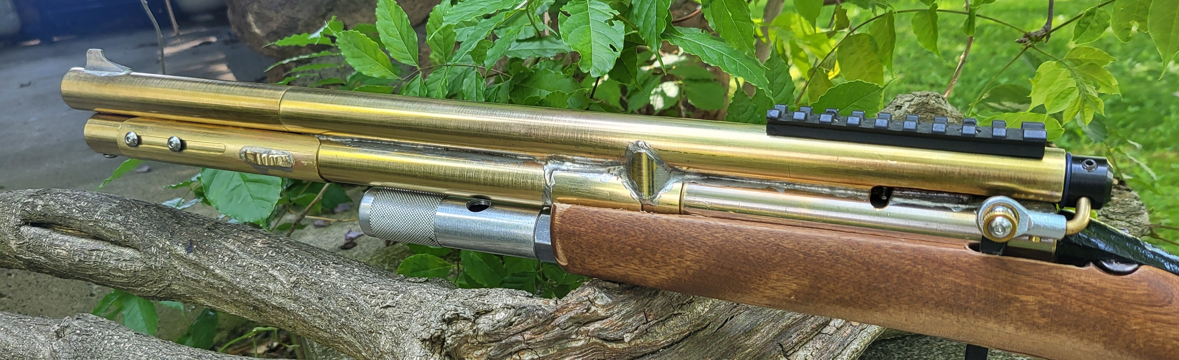

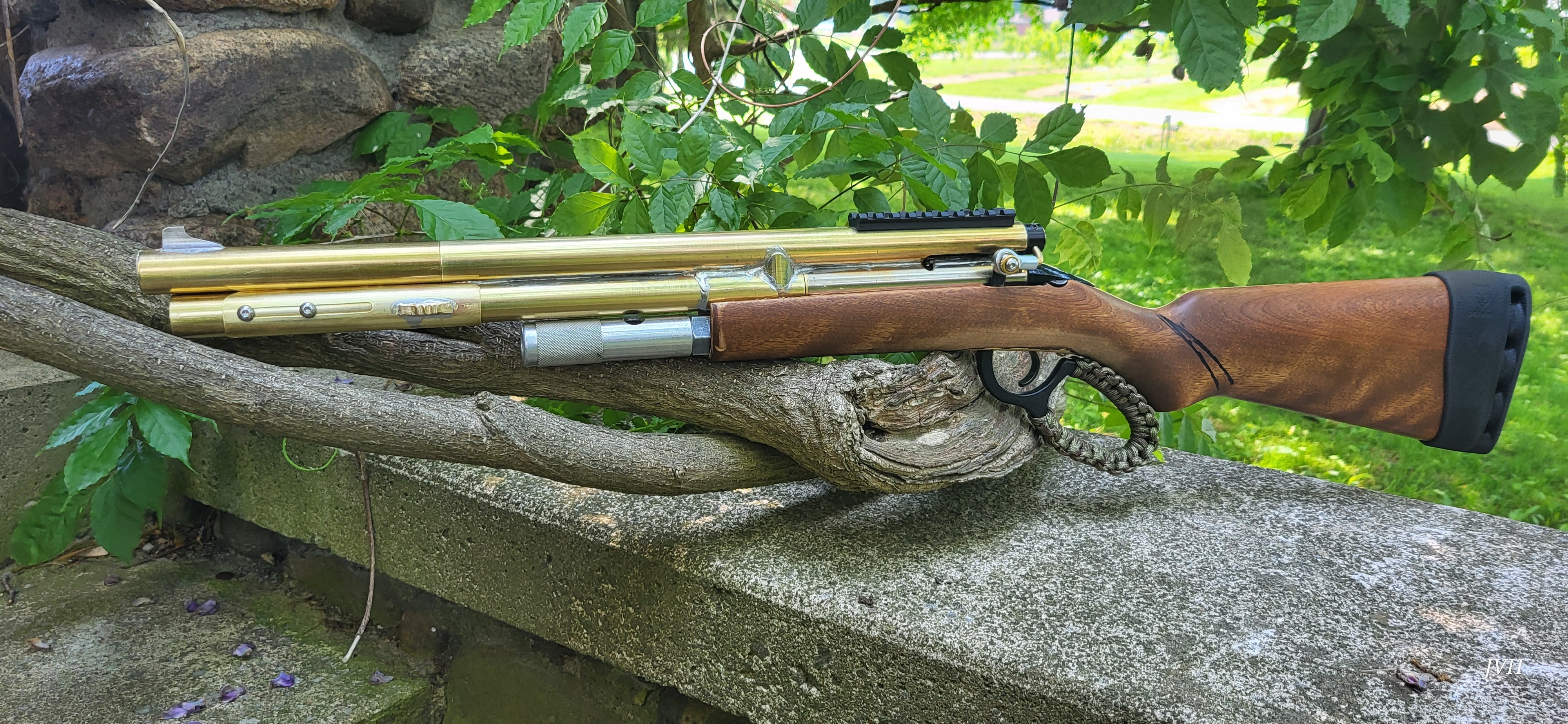

            Preeeeettyy much done now... I'm toying with the idea of a lugged rail along the top, like some of my other builds, but I'm going to leave it alone for now.
            Click image for larger version  Name:	20250607_115410.jpg Views:	0 Size:	2.49 MB ID:	701192
            Click image for larger version  Name:	20250607_115435.jpg Views:	0 Size:	2.31 MB ID:	701193
            I've ordered a CCI bucket changer to replace the temporary BE 12-gram changer on there right now. The MicroCA will likely stay off, it's more bulky than I like (sorry, Grendel 😉).
            Click image for larger version  Name:	20250607_115509.jpg Views:	0 Size:	1.48 MB ID:	701191

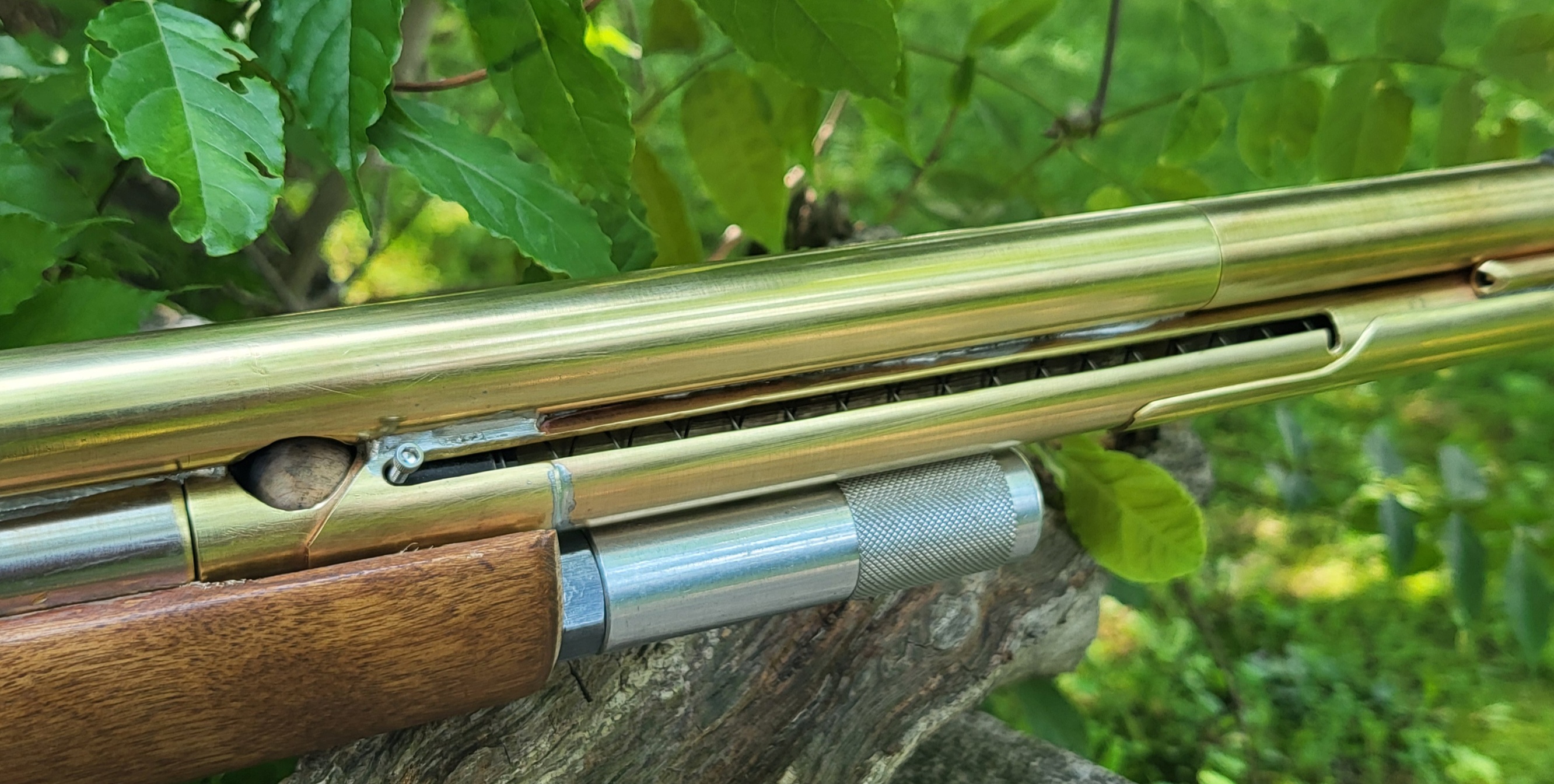

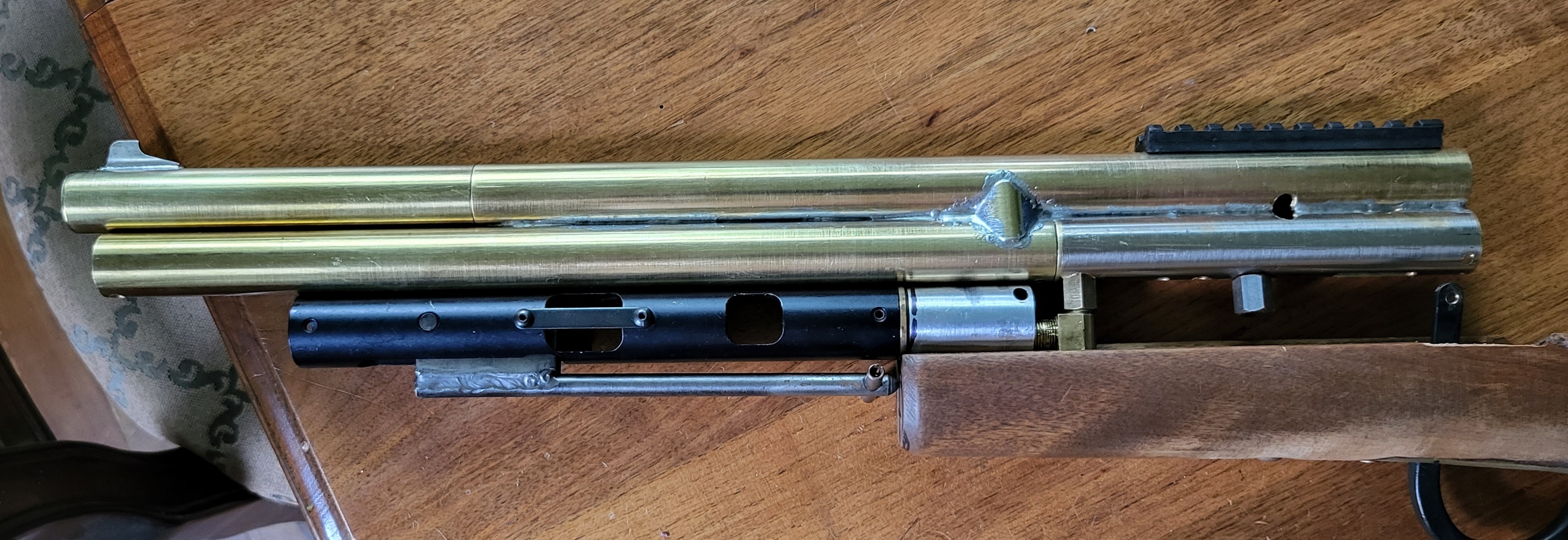

            Feedport cover opened:

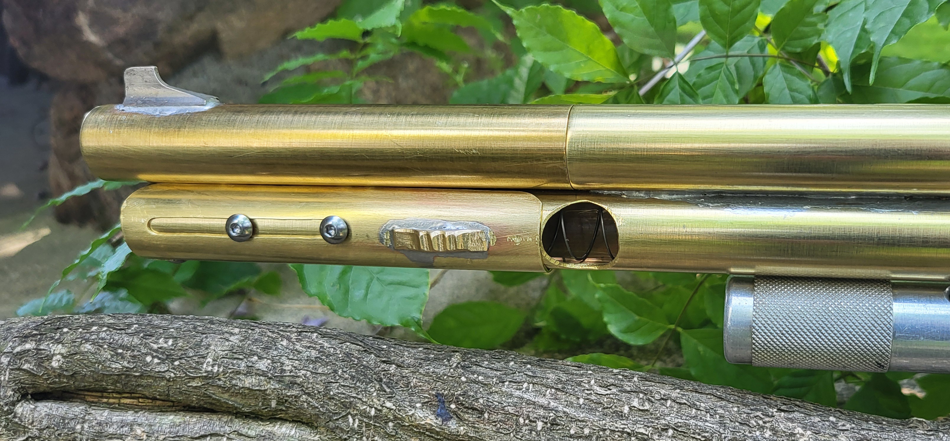

            The springfeed slot ended up on the right, with the feedport and cover on the left... the barrel tip is retained with my usual method, a section of brass tube that's been cut in sections, one threaded for the retaining screw, and both bits soldered to their respective tubes.

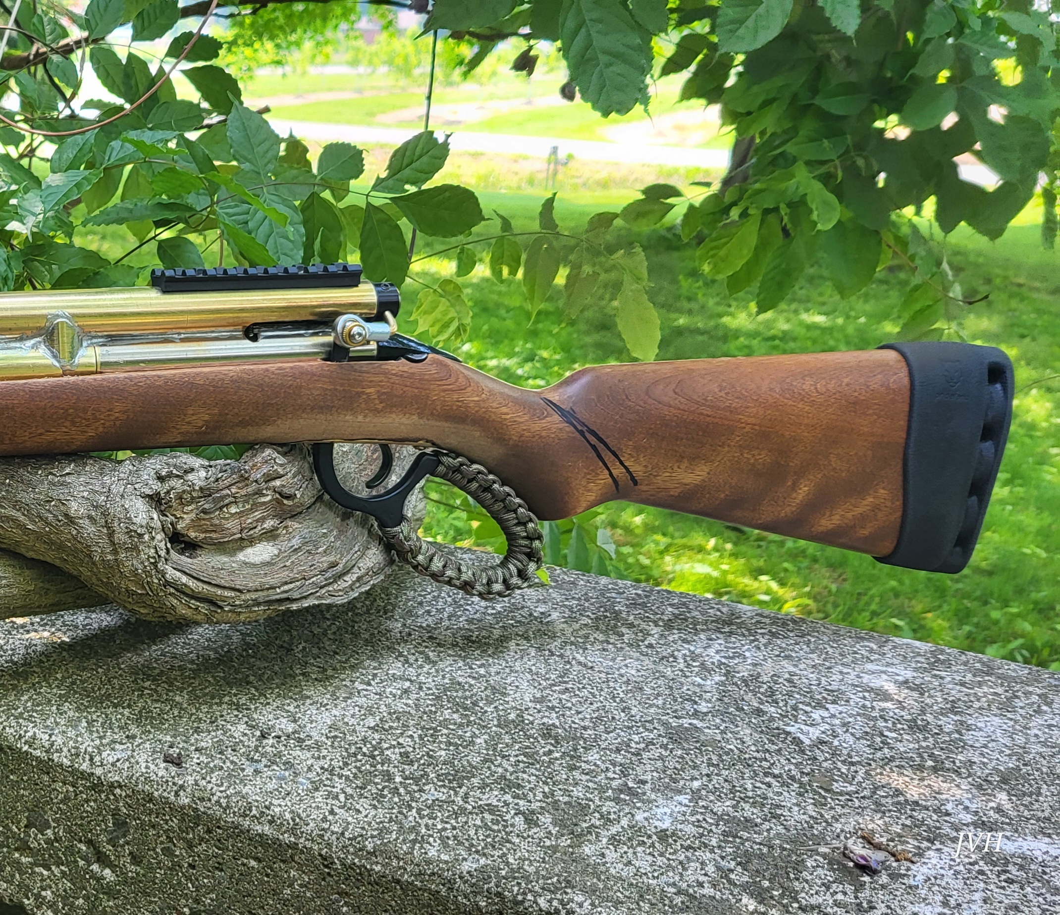

            #26
            I'm going to cut and reglue the butt of the stock as well, so I haven't bothered refinishing the stock yet... you can see the cut lines I drew on the stock, the plan is to cut a wedge out and reglue/pin with dowels to create a drop stock with minimal mods.
            I did something similar to my KP2 and it was extremely comfortable to use once done.
