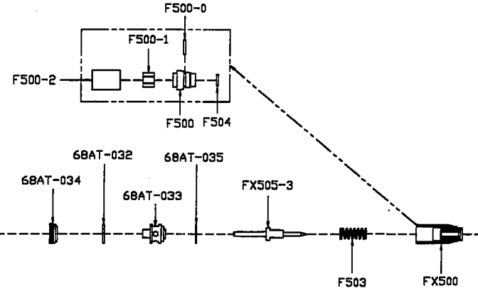

      Frenchy is here!
      • 3064
      • Nor Cal
      Most of what you need to know is on there:

        Thank you for input, found you can remove lead washer while removing the valve assembly. found a couple other issues which are resolved, back together and running.
