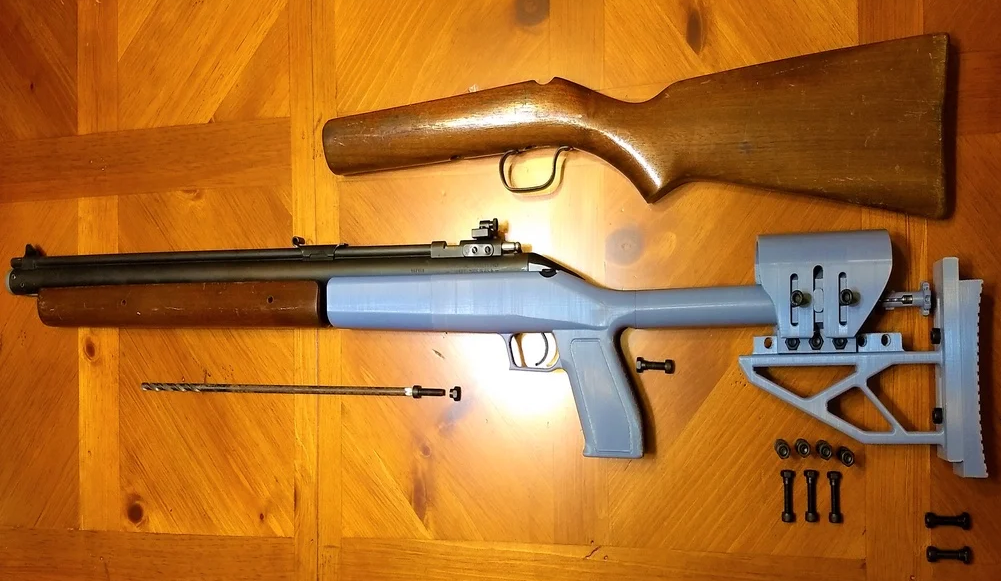

3D-printed Bluesteak lowers- could they work for a KP?
  • The Inflicted
    pǝʇɔᴉlɟuI ǝɥʇ
    • 1553
    https://www.thingiverse.com/thing:3842939
    I'm especially curious if it might be possible to delete the stock attachment point and instead have two recesses at the bottom of the grip for standard bottomline bolts.

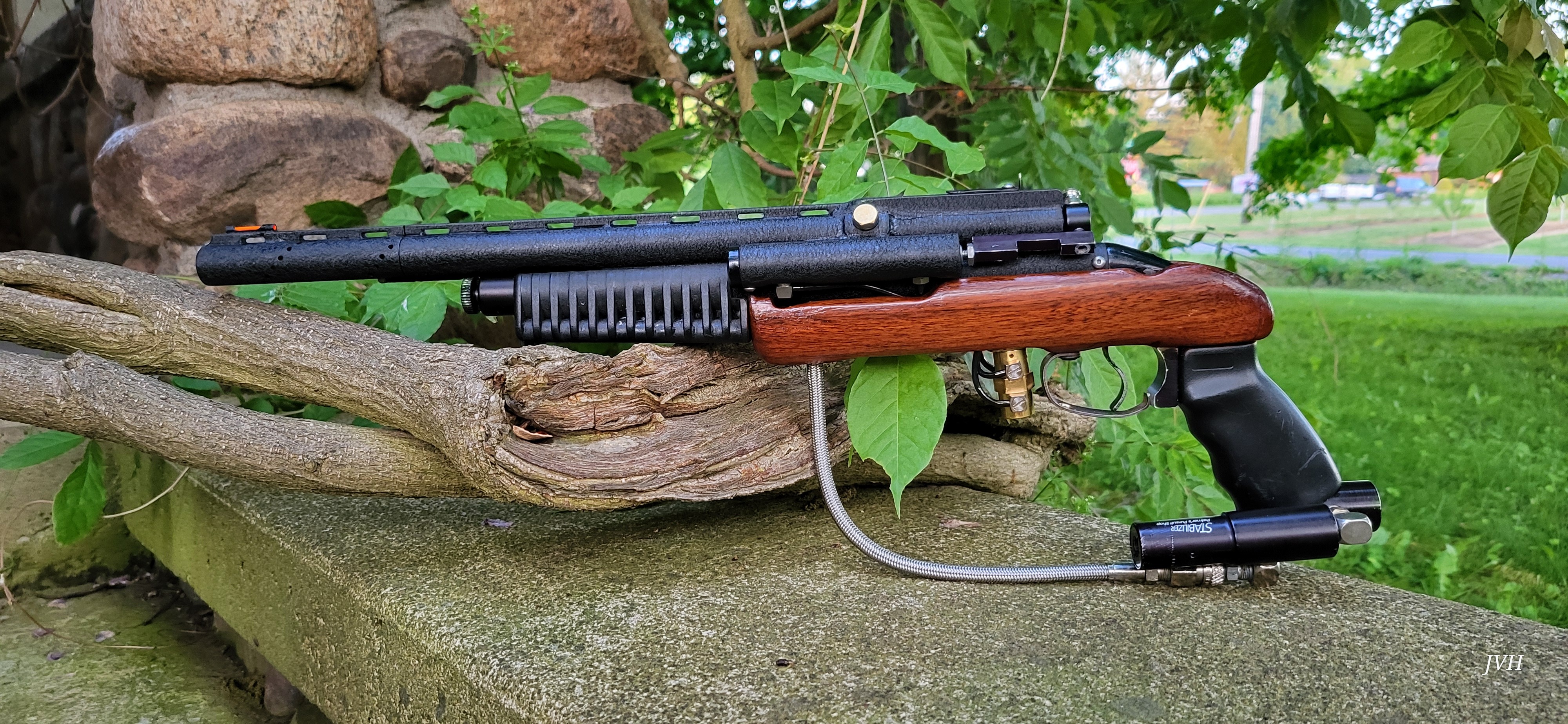

      Like on my Hurricane?
      I used a VM68 mounting lug to install a Eurogrip with ASA.
      I installed a pair of brass thread-in lugs into the stock, both threaded for 10-32 that match the mounting locations for the VM lug. With the VM lug you can now use any Phantom grip blocks - M16, .45, 86°, whatever.
      You can also install a standard Sheridan frame if you use the modified front screw position that Palmer's used on their brass stuff - Typhoon/Houndstooth/etc.

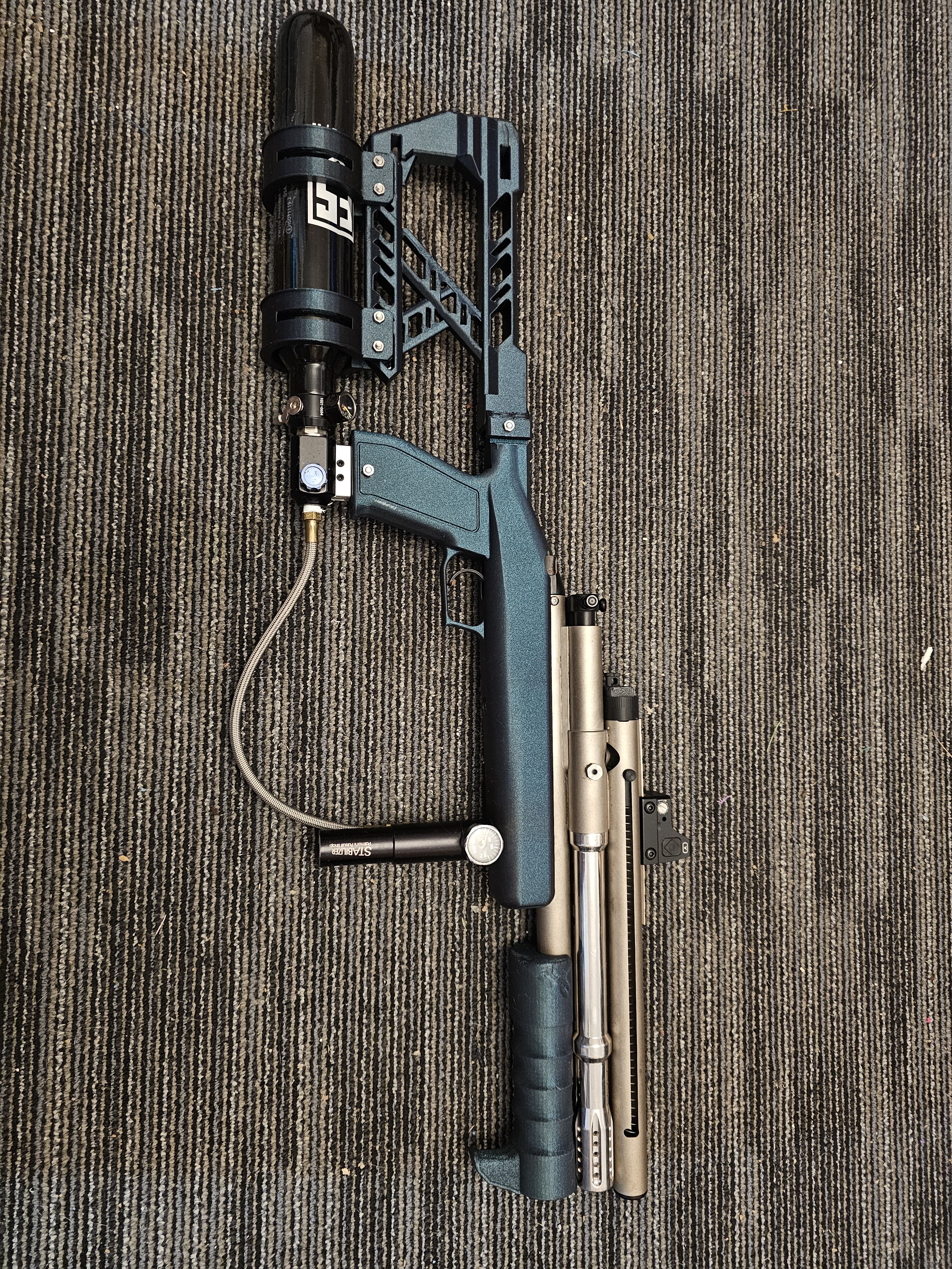

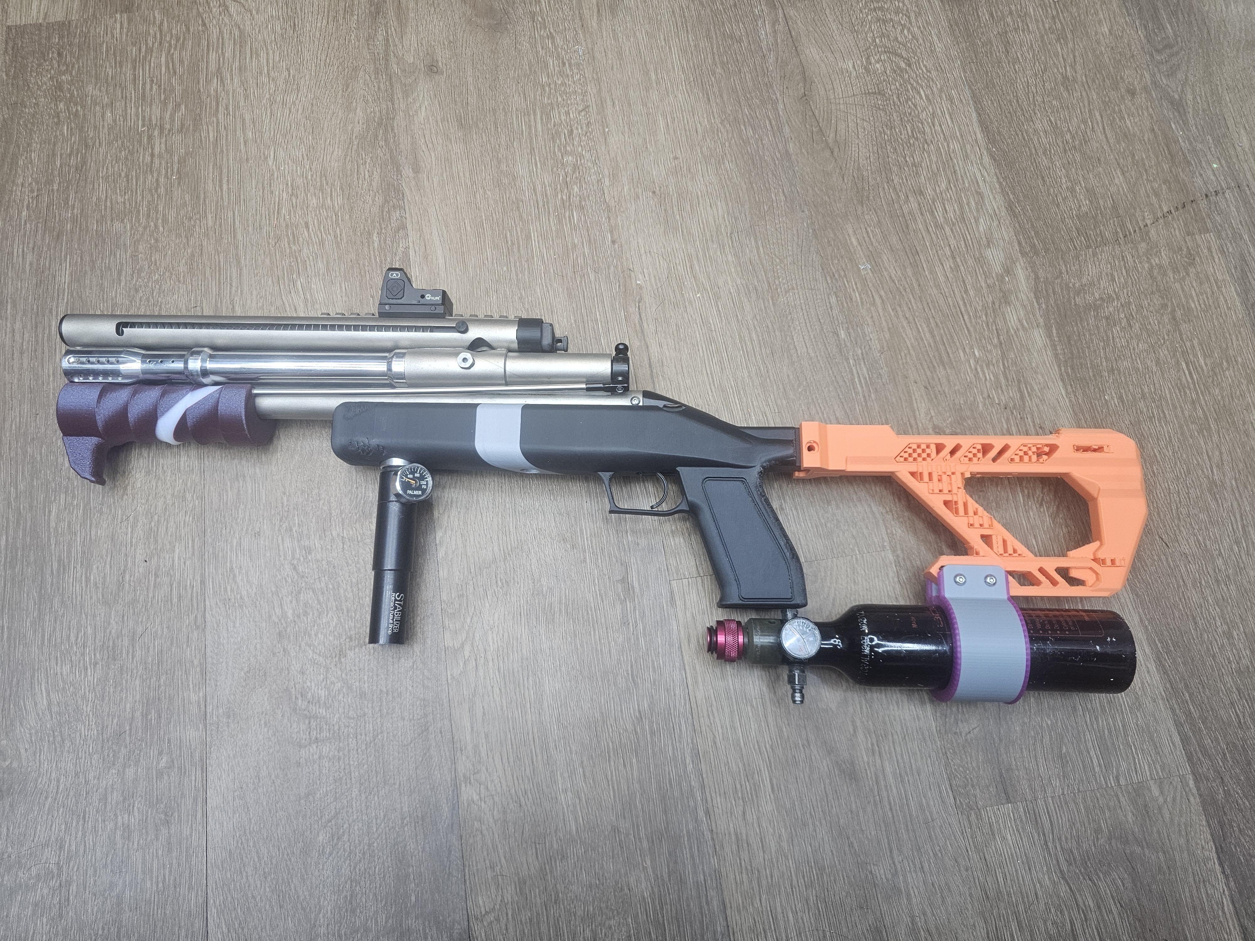

        minor updates. My file has the PIC rail added to the back, the tank ring shown was mine, the stock was modified and hinge removed as it was a weak point, stock braced, pump grip was homebrew specifically in studio with an AR hand stop flipped and pushed forward to act as a hook. The foregrip and receiver were combined as well as creating a hole for the vert air adaptor. I ran it nearly all weekend three weeka back not being particularly gentle with it. the current print was dont with Flashforge ASA

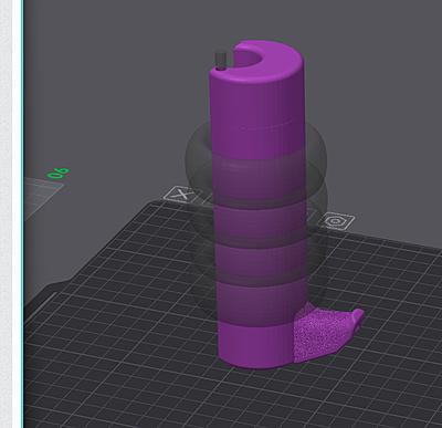

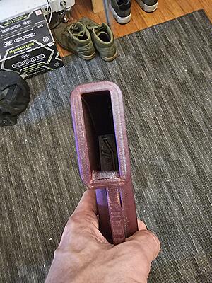

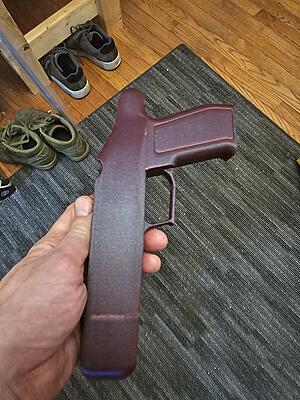

                fwiw Bambu slicer let me do this full pump grip with the exception of the AR hand stop that I flipped backwards and ran forward on the pump handle, I did it so I could hang it up or use it as a hook if I needed to reach something. but this was before I understood drafting/drawing as I do now so inevitably id do it differently now. there are no threads in the pump grip but what it cut. The grip is 8 walls and 75% fill. I do believe in over drafting as I want to be able to depend on the parts holding up. and I think its safe to say that if its working with the nasty painter then it'll definitely be strong enough for a K series.
                • Chemical-x.....ahain
                  • Mar 2023
                  • 526

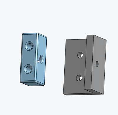

                  take the blue block and mount it into the black using the two holes, Then youll notice a considerable gap between the single holes . that gap is to allow you to drop the two pieces together and onto the bottom of the drip frame and it indicates your pilot hole. when done putt the mounted peice back off, attach your ASA then then drop it into your grip frame, run your bold across to lock it into place.

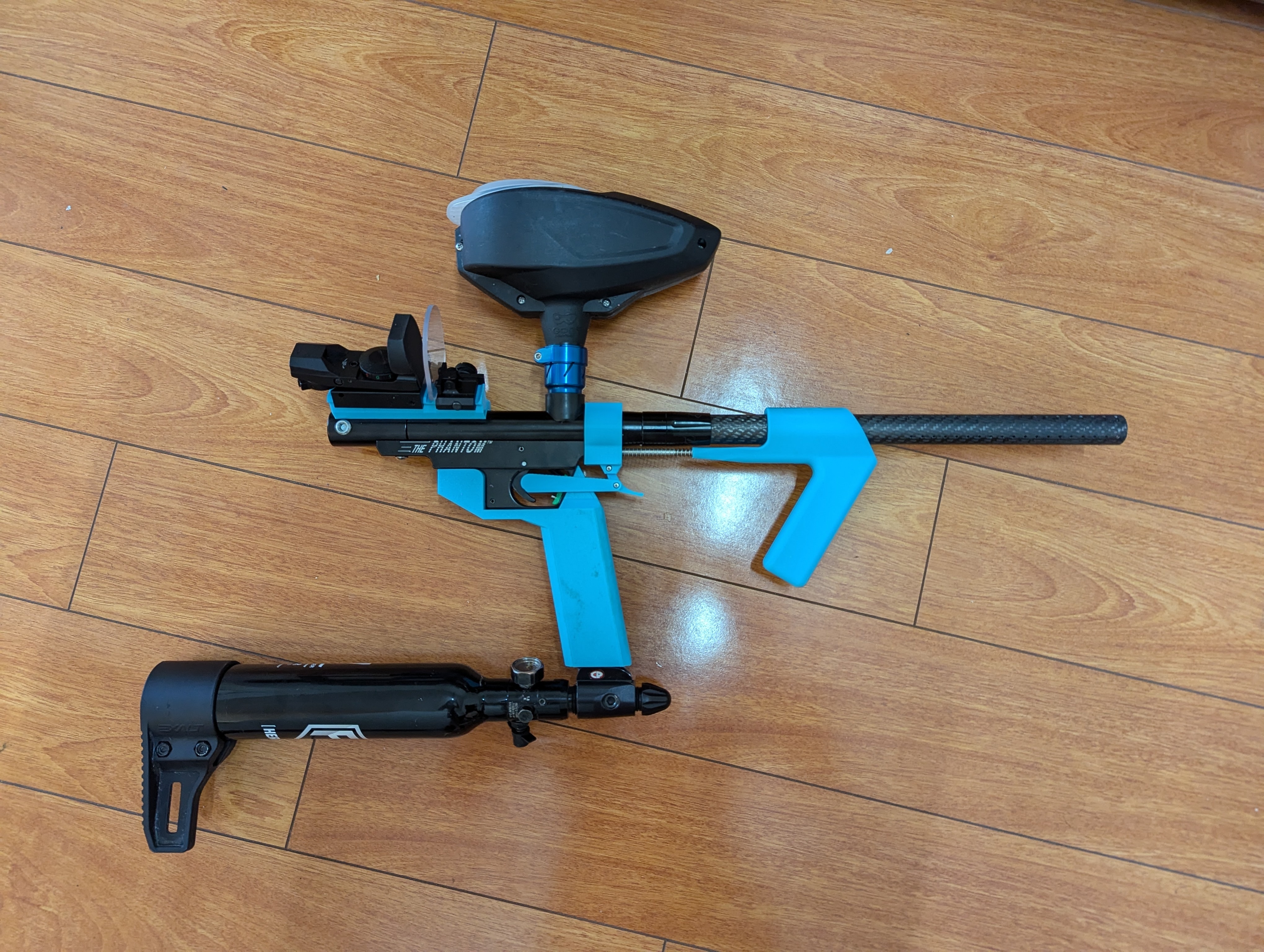

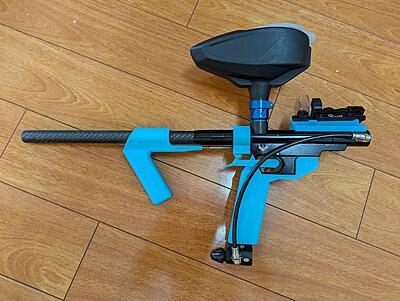

                            The Inflicted for clarification you're wanting to have a bottle mounted like this, kind of... this is from quillcrest 's thread.
                            edit: Here's a link to its file..🎠 CCI Phantom Bullpup Conversion・Free STL File for 3D printing・Cults​
