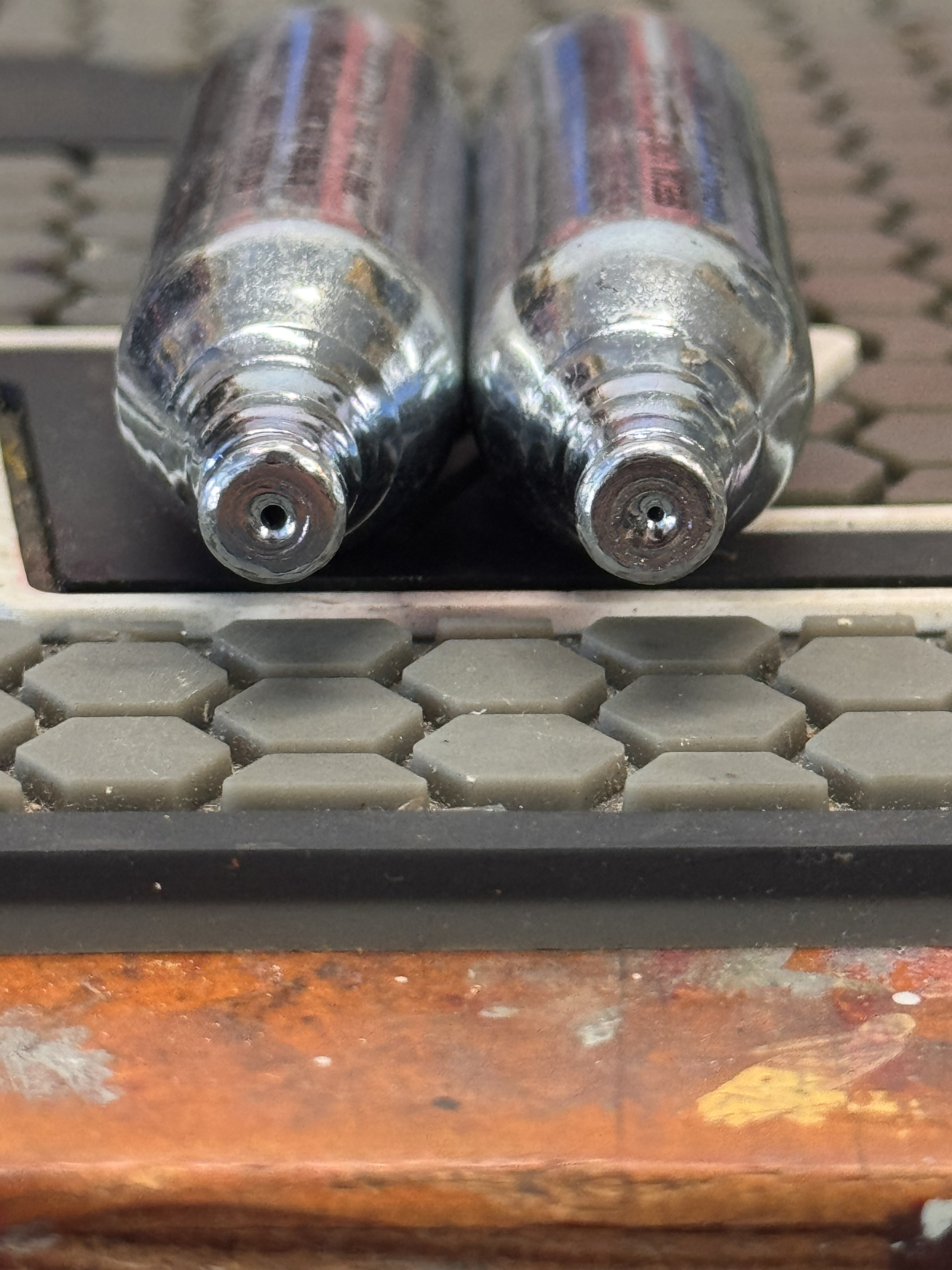

    A couple 12grams looked barely pierced - another 2 had distinct but small - 1/32 holes
    read the threads about de-volumizing..... do need to go down that road? new seal to thick and not enough pierce? valve pin and cup seal fine. no leaks. any ideas?

        Maybe, the more I'm thinking about it though I would probably go after that pierce pin first. Get it to open up the 12g more

          Pgp junkies 12 gram seal is a little thicker and harder than a standard seal. Even if you get the 12 gram to pierce it might be too shallow for good air flow. Try tightening the 12 gram screw a little more before piercing. Obviously it’s easier with a fast change knob. Also using a slightly longer main spring especially if you upgraded to a RVA. I wouldn’t go lighter on the valve spring. A longer valve spring will choke the valve that’s probably why you didn’t see improvement with the lighter/ longer spring

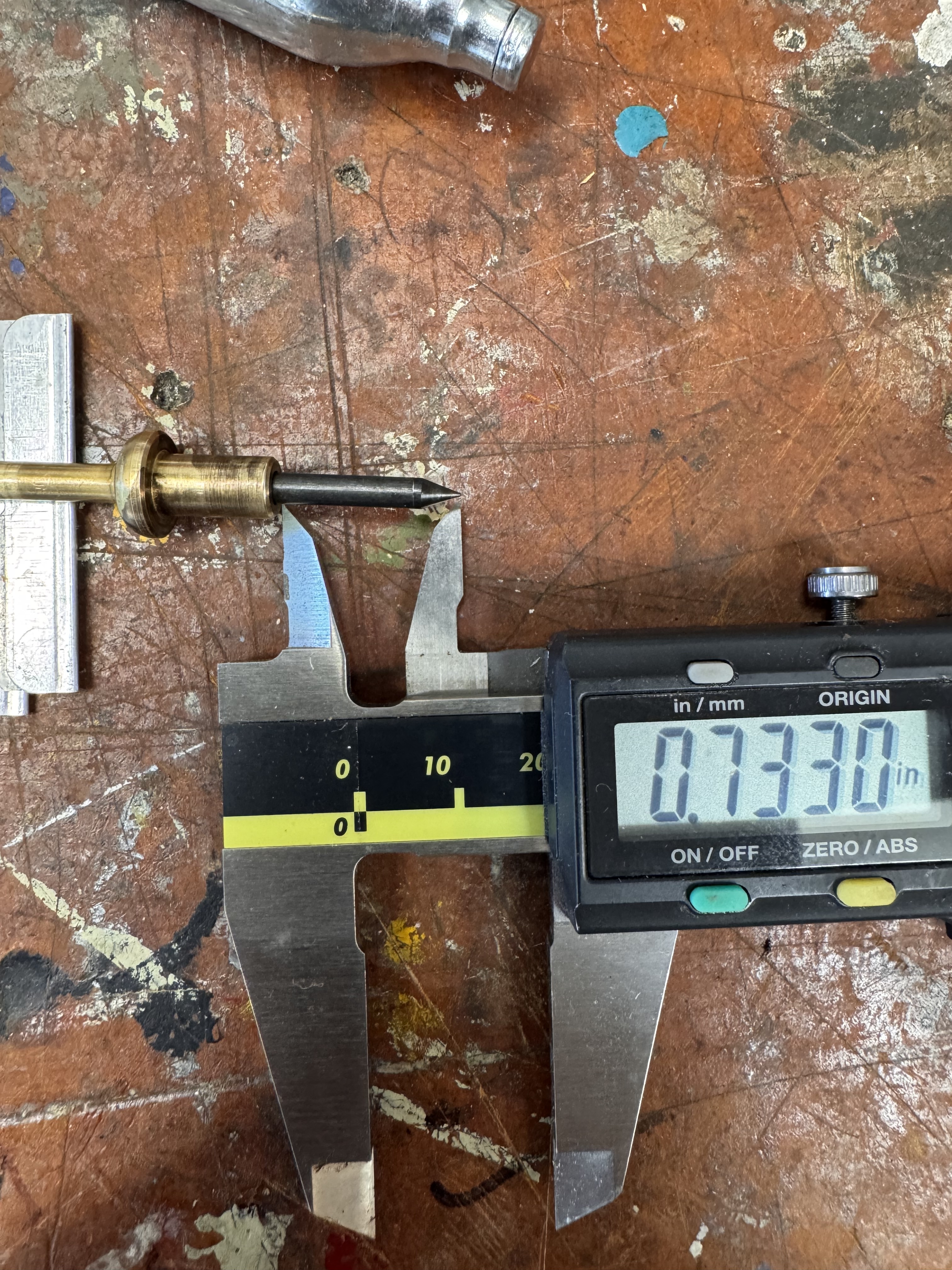

                (PGPJunkies here) Do you have an extra face seal? I would like to know what results you would get with the standard (unshaved) faceseal, now that you have done all the other mods. The face seal thickness was based on the original thickness. But I am certainly open to modifying them. I had one PGP that had trouble with the initial pierce, but when I measured the pierce pin assembly, it turned out to be much shorter that the usual pierce pin assembly. Anyways, thank you for all the data. If you dont mind posting the data, I will send you another face seal for free.

                Yes, I definitely want to backtrack and put the OG springs back in and see what happens. I have extra of the junkies seals so I’ll swap that back out and see if the valve mods negated the need for a thinner face seal. I have another un-touched PGP valve and want to see if there is a difference in pierce pin lengths.

              Myfeetupontheground ok I had some time after grocery shopping and soccer games to swap out the cut down face seal for a new off the shelf junkies face seal. I'm happy to report it appears to not be the culprit in performance. I got 20 shots consistent with my best numbers above. I kept the lighter junkies valve spring and longer main spring in.
              It should be noted that it really barely pierces it compared to a shaved down one. my pierce pin measures 0.73 as shown below
