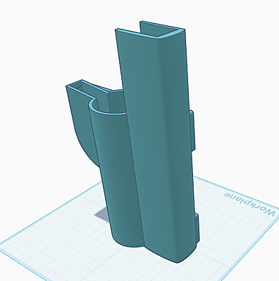

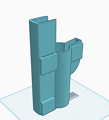

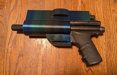

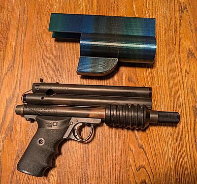

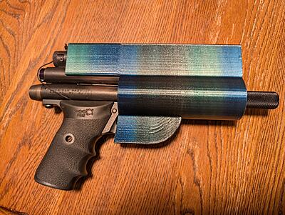

    Nothing fancy and my design skills are pretty basic but I whipped up a holster for my pgp. Still will mess with it more but it's functional at this point. Printed in petg, but only had that color at the time so...

        Either though it still needs some work and while it was built to handle longer barrels if need be but the thing that really keeps it snug is the portion built to accommodate the Pump handle. Right now my other pgp fits into it but is loose, I need to do another one built for the smaller pump handles

        Looks like it would be easy enough to redo that shape with wood blocks and use it as a kydex mold.
        Velcor will save us...
        • Brandon
          Brandon commented
          maybe even print it, gently heat it up and mold the filament like kydex for a more custom less boxy look.
        • Vegabond
          Vegabond commented
          Sort of. The different sizes of pump handles makes it a challenge in a hard shell.
        enter over there..☝
        • 5001
        • ....on the 13th floor!
        I like your PGP style. Classic PMI wraparound grip, RVA, Fast changer and a leash for your feed plug.
        I wonder if the pointy part of the holster. The section that covers the middle tube. Will it poke the body on a bend without the marker holstered? Like crouching into a small bunker or something else. Could that part be rounded verses a 90 degree angle? Is the holster friction fit, loose or more something like a built-in plastic wedgit retainer thing? Just thinking out loud...Sorry, I'll go back to the corner
        Carp 's Feedback
        • Vegabond
          Vegabond commented
          Its sort of a friction fit. The pump handle really keeps the whole thing in place and the length keeps everything in. a hood could be added to keep everything in or the user could glue a velcro strap over the top as well. Right now the whole thing sits right on the hip and its not been field tested yet to see how well it holds up. I'm still trying to work out the best way to attach to a belt and I'm wondering if a drop leg style attachment may be a better option for the pistol considering the size. I'm also musing on if I should just reinforce the side and just create slits for straps to go through to attach to the belt instead of the printed loops. Especially as the loop at the trigger cover sits pretty close to the pump handle portion and makes getting a belt through a bit difficult.

            ok, attempt 4 coming. This time I made it a little less boxy and replaced the attachment point to now take 1 inch straps and added a lower one so it could be strapped to the leg.
