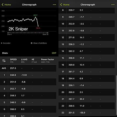

      2k WGP Sniper:
      Stock Valve
      Vertical PPS Stabilizer to Bottom Line Quick Changer
      14" JJ Barrel Freaked ti accept XL, matched to .675
      Quick Change to Bottom line
      One shot was not accounted for as first ball did not load
      80 degrees in Shade, fired once every 8-12 seconds
      After shot 23, 12g released a tiny spurt upon removal

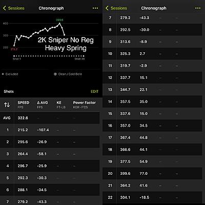

      2k WGP Sniper No Reg/Heavy Spring: 26 Shots above 300 FPS
      Stock Valve
      No Reg - Quick Change direct to VASA
      3 shots taken shooting balls 15 feet
      Heavy Spring Added
      After shot 22 I ran out of paint and dry fired until 26 shots. On Shot 27, 12g dumped out barrel

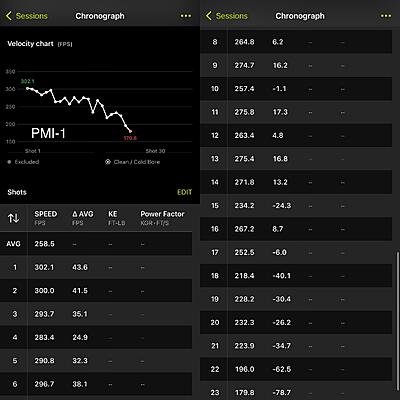

      PMI-1: 17 Shots
      Stock Everything, Fresh Rebuild
      Wedgit Style detent keeping ball in place
      .690 Bore with .675 Paint
      One Puncture shot
      1st Round at 302 FPS
      After 23rd round at 179 fps, big spurt from 12 gram removal

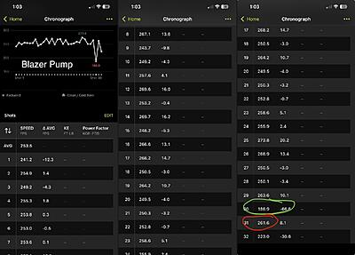

      PPS Blazer: 32 Shots
      Pump Mode/LPR Bolt Out
      PPS 10" Brass Barrel w/Wedgits - .690 Bore and .675 paint
      80 Degrees in Shade
      Green Circle = Double Feed which broke paint
      Red Circle was next ball with dirty barrel
      Final Shot was after cleaned breach and 3 minute pause
