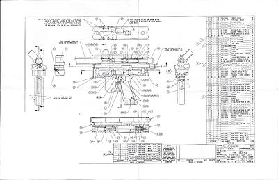

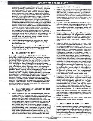

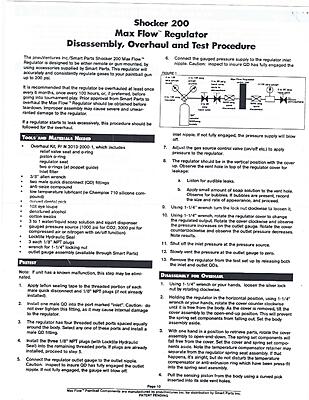

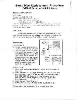

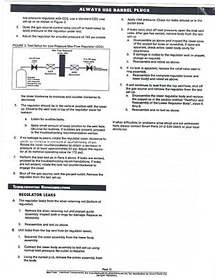

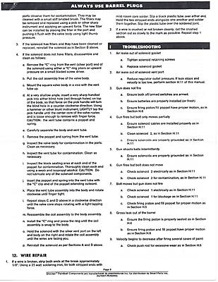

    As far as I know there has never been high resolution scans of the manual. I know this because it was next to impossible trying to figure out what orings I needed during a rebuild. So here you go
