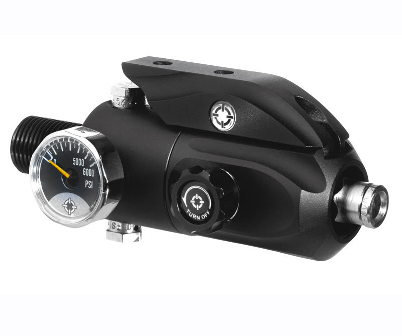

    I remember reading a while ago that micro Max Flos could use Luxe reg seats? Anyone have any experience with this?

    Do you really mean the Micro Max Flo? I'm not trying to be a smartass or anything. I have several and would like to know if there is an easy source for service parts.
      Yes

        I compared the regulator piston from my Micro Max Flo and one from my GoG eNMEy vertical reg. They appear to be identical.
        The part # for the current production reg seat is VRG106 ( $1.00) . The current reg piston is VRG105 ( $5.00).
        Part #s from a MMF manual that I found online: reg seat MFP103 , piston MFP105
        I have a new-old-stock MMF that likes to pop the 1.8k burst disc so I am going to order a piston from gogpb.biz .
        The Shocker RSX , Luxe Ice and GoG eNMEy all use the same regulator piston.
        I spoke to both Kraig ( tech service) and Laurel ( sales) at Gog / Luxe / Shocker PB and they do not have any of the old parts listed in their computers. Kraig said that he would talk to one of the guys that has been there when it was Smart Parts to see what was on the shelf "in the back room" so to speak, but he has never returned my follow up emails.
        I wanted some belleville washers and a shim to convert them to low pressure( 450 psi) output. I already swapped the 5000 psi burst disk to a 7500 psi to use them on 4500 psi tanks as mine were 3000psi regulators.
