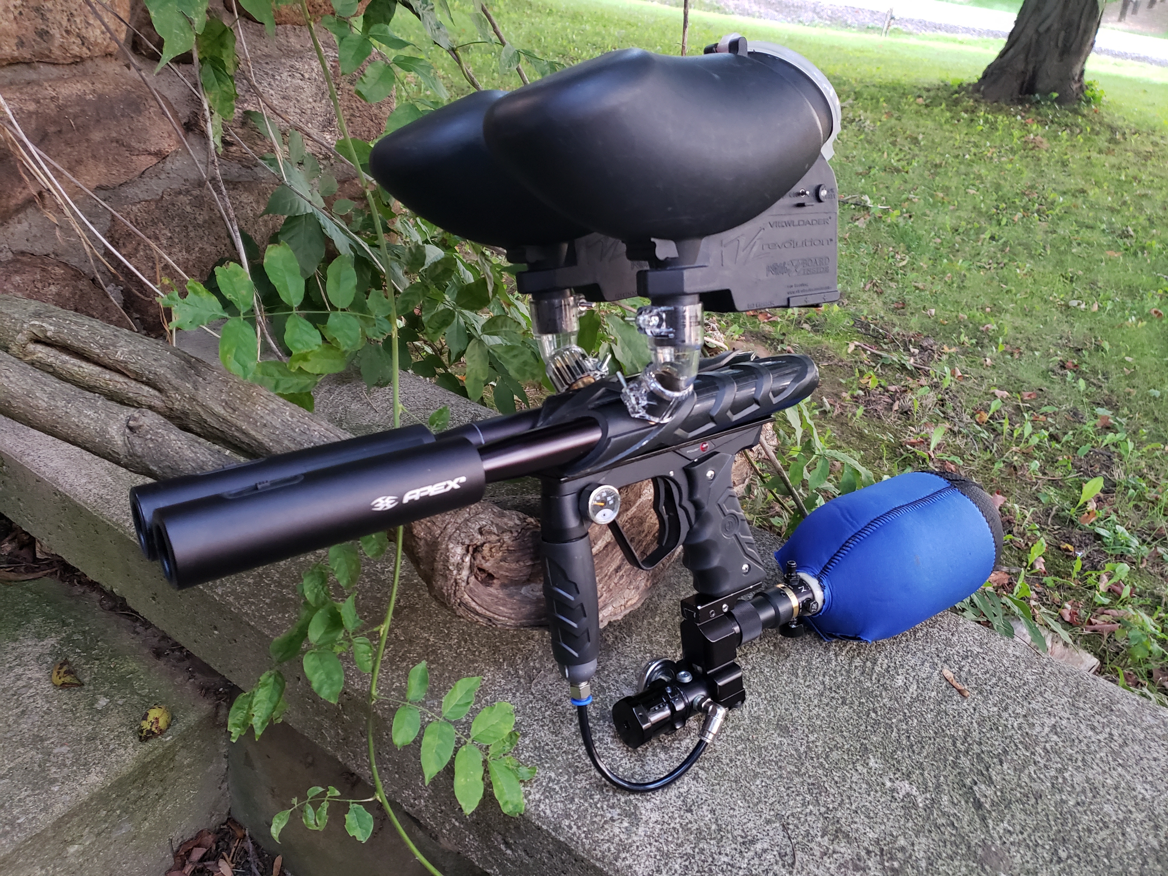

It's done! Well, almost.
    I. Am. Canadian. 🇨🇦
    • 3514
    I think I started collecting stuff for this project almost 10 months ago, most of which came from sellers on here... I bought a Revvy and extra Revvy internals from Alexndl, at least one Ion from Cdn_Cuda, and I forget where I got the MaxFlo from but I think it was euangelion.
    Aside from an annoyingly small leak from a NIP-but-still-probably-15-years-old QEV, it's together, cycling properly, and ready for a test run on Saturday, where I'm sure my arms will give out before it does.
    This is the third version of a dual Ion setup that I've built, and probably the better setup of the three... much easier to service in terms of teardown.
    I may start a build thread at some point if there is interest, I think I've taken enough pictures of the process to create one.

    That thing is awesome! I love that you’re running it with dual APEX barrels.

        Man, those Apex tips really top off this build !! Very cool!

          Great work Jordan, the dual apex barrel really complement the build and add a killer look!
          I would not want to be on the opposite side of the field
          You are running one board and solenoid for both ion body?
          and are you using only the maxflow as the HPR reg going to a gas trough grip?

            Wasn't able to keep it electro, the stock noid doesn't seem to have enough flow to cycle two bolts quickly enough. I might revisit it yet, once I have the leak nailed down and fixed. I've revised the hose routing as well, which might help.... I really wanted to keep it electro if I could.
            I'm running the MaxFlo with a gas-thru grip, stock Ion regs don't work when you're filling two fire chambers simultaneously, at least not anything over a couple BPS.

              OH my, and she's mech to boot! Very well done build. A Nasty Mech Ion, how very MCB
