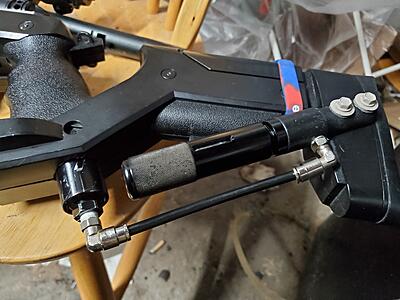

    I guess I'll share my moment of embarrassing stupidity. At one point I wanted to drop my rifle off and run with my PG since I was too close for first strike. Well I un clipped it from my shoulder strap, but I forgot to unhook the air line. So I literally dragged this through the mud today. It held up great, no wobbles or anything loose still, just some scratches from dragging it 30 feet. It's fine I wanted to paint it anyway.

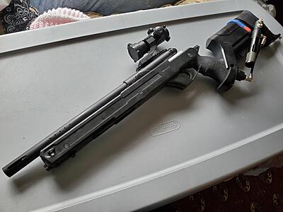

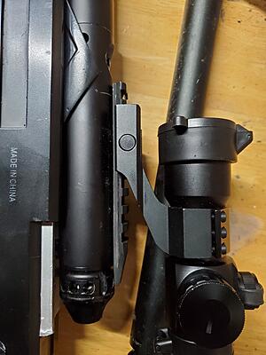

      So I have added a sight rail up top, now I can run a red dot. Where one of the screws is on the rail is a slight problem as I over estimated the thickness of the chamber, so some epoxy was needed to get that sealed up. I also added a 12g quick changer. I can get 25+ good shots per cart, and now I don't have a remote line and a tank on my back. I'm free to set this down and run at any time. I had to put my cut down Ion body on for a spacer to keep everything nice and stable and to close up the eye and detent holes. I'll get the final build pics tomorrow. This thing is super fun. I added a short barrel from an SP8 and it's the perfect length for the forward marksman style of play I have when using this setup. It's ultra light and maneuverable, plus it's whisper quiet and dead nuts accurate. I'm very happy with this build. And all in I didn't really spend anything on it, as I had everything lying around.

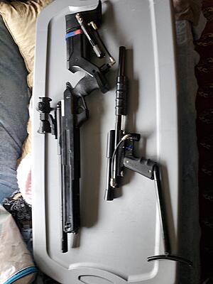

        Here it is. It might get painted after the season. Not sure yet. It's only slightly longer than my Phantom, so you can see how short it is for a rifle.

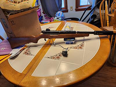

              I know it doesn't look like much, but there is progress here. The trigger system is in, and I have an ASA mounted with brass inserts. I still need to mount the regulator somehow, plumb it, and make a faux magazine that will cover the airline and SMAV3 sticking out by the trigger. I might even fashion a trigger guard for it. This feels like it's going to be even better than the first version.

              i like it. is that a 10/22 stock?
              • JeeperCreeper
                JeeperCreeper commented
                Yep, used to be. I plan on stripping it down and refinishing it at the end

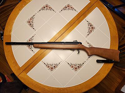

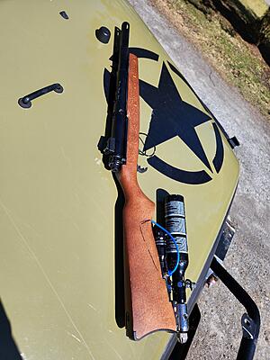

              100% functional. No leaks, shoots great. I'm hoping the macro fittings keep holding up, so I can run that 12g changer on it. Now to make it pretty.

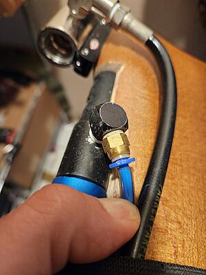

                  Can you post a pic of how you went from the hpr into the banjo fitting?
                  • JeeperCreeper
                    Multi-purpose
                    • 2104
                    • Western MA
                    #30
                    ironklad I used a fitting that was 1/8 NPT to push connect for the 4mm line, then it runs through the stock to the 3 way. I also used a bigger piece of hose around the exposed lines for durability.
