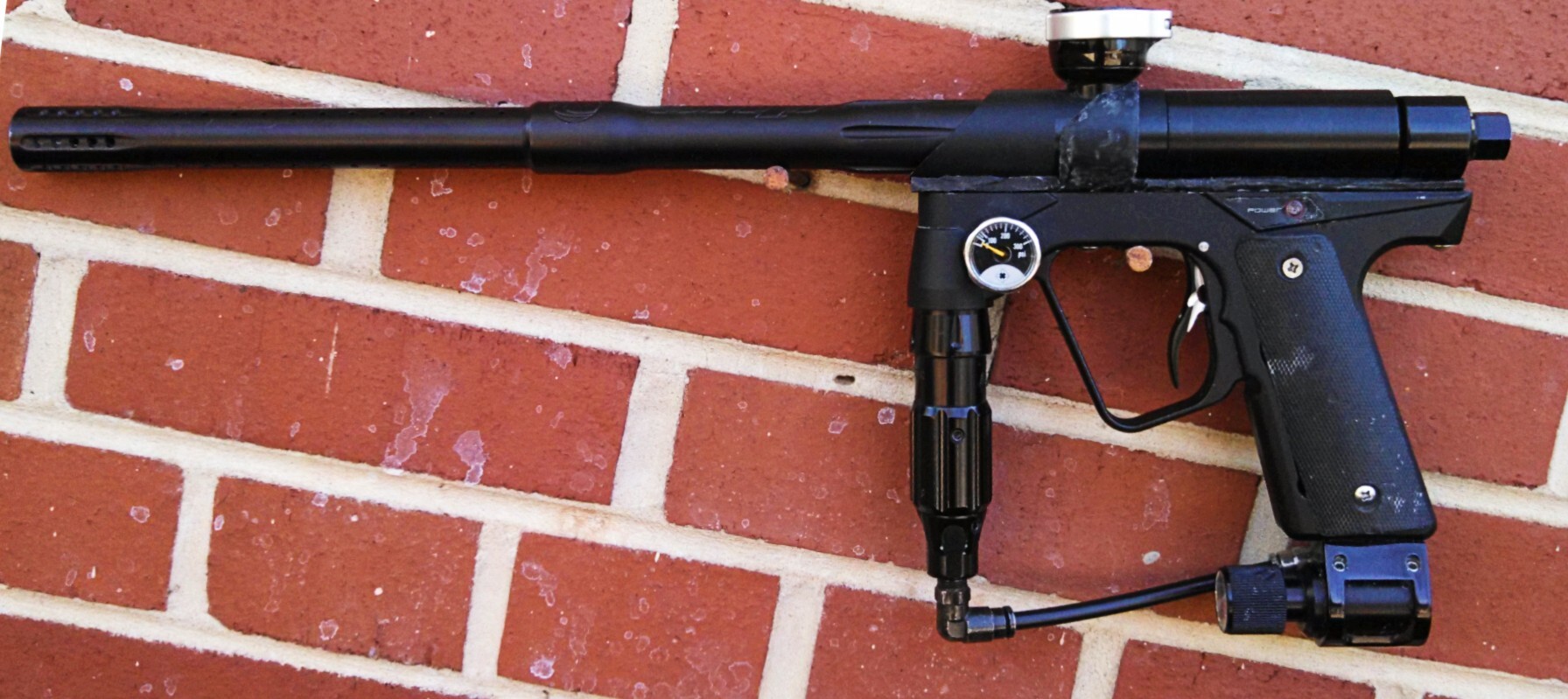

      I have a bodyless ion. Meched, a piece of spring steel holds the detents

      • The Inflicted
        pǝʇɔᴉlɟuI ǝɥʇ
        • 1548
        • spikeball
          spikeball commented
          Sweet deal. Is that a 3skull trigger as well? I like the shape.
        • The Inflicted
          The Inflicted commented
          Possibly? I got it from ANSGear for like $5 when they were getting rid of most of their Ion stuff.
