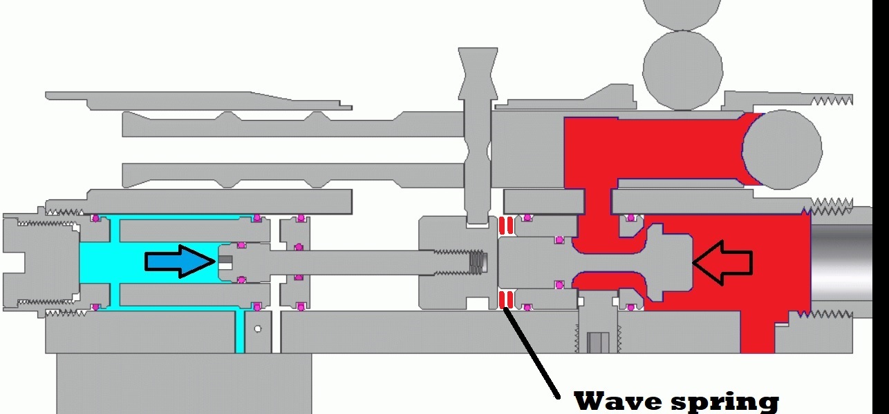

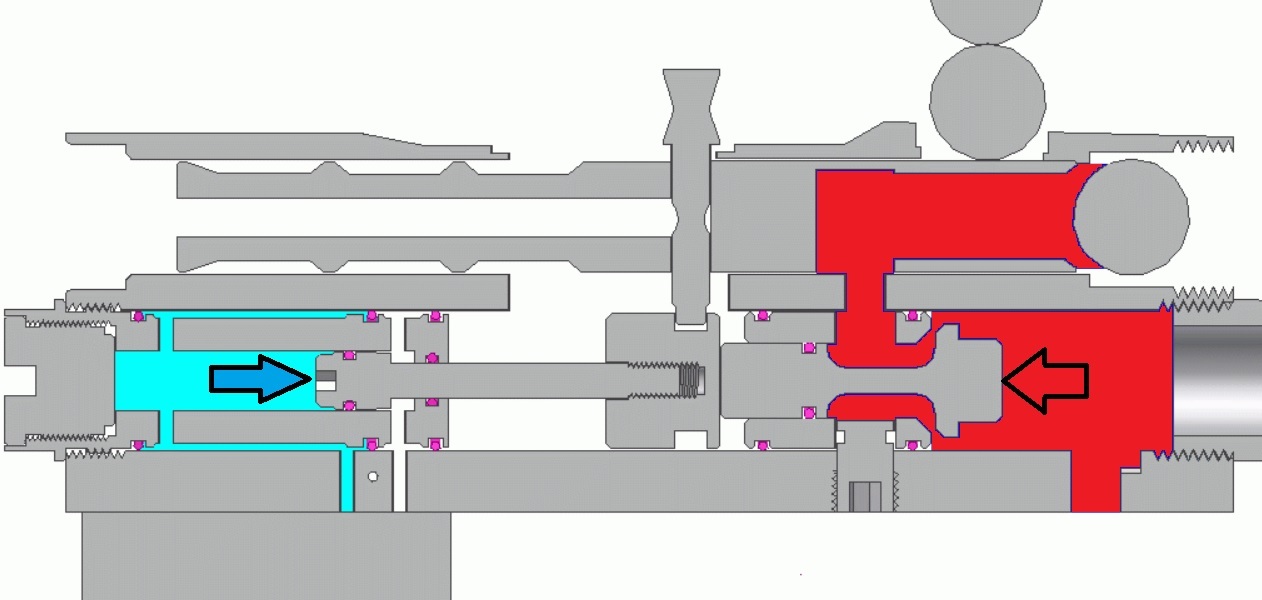

            Wave spring assisted ram return to prevent farting with mech trigger valve. Solves the dwell issue entirely. It will still oscillate, but the intent is to keep the valve pin from being part of that oscillation so that it doesn't waste gas - and prevents the loud farting sound. The ram and wave spring may still oscillate creating a 'ting'-ing sound like a fast metal rattle. And this is only if you hold the trigger down - which keeps the ram held forward.
            To be clear, this mechanism is not ideal... it will be difficult to find the right balance of wave spring and pressure settings.
            Last edited by Siress; 12-15-2022, 08:02 AM. Reason: adding more details and figures.
            • JCC
              JCC commented
              This idea could keep ram/hammer from holding valve open, but would be very hard to find right balance. Also, this sets max dwell not minimum so a trigger pull that was shorter than required dwell would be a low velocity shot or a partial cycle even. Seems likely to be wildly inconsistent and chop paint from partial cycles if really on the trigger.
            • Siress
              Siress commented
              You just described short stroking. That has everything to do with the trigger group and nothing to do with the firing mechanics - unless they're integrated, which here they are not.
            • JCC
              JCC commented
              Short stroking would be if you do not pull the trigger fully and the valve is never fully opened. A setup like this you could pull the trigger fully, but pulled it so fast that the valve was not open long enough. Similar but different phenomenon the short stroking. End result is the same is you would end up with a situation where hammer would not open valve long enough so velocity would drop. Could be as bad as gun cycles, but does not fire then you end up with multiple balls in barrel before firing which is instant mess.
