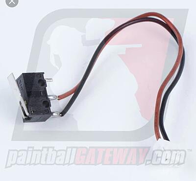

    Has anyone modified the original micro switch to a wired micro switch like pictured? Now I've never did this before but I do a bit of soldering. So would this be something I could do or send it out?

      When I ran a Morlock board in my Shocker I installed a micro switch.

      I've done it different ways - converted a DS board to LS with a microswitch, and done a frame swap and wired the microswitch up with wires from the frame to the board.
      Yes, it can be done.

        That's exactly what I'm trying to do.

      My board has the micro switch but I want to do a wired one because I'm ditching the stock frame.

        It'll work fine.

      Now does it matter what wire goes where or is there a certain one negative & positive?

        Not in my experience, but you'll need to use the correct terminals on the microswitch - they're marked. You'll want to use the center post and the one marked NO.
