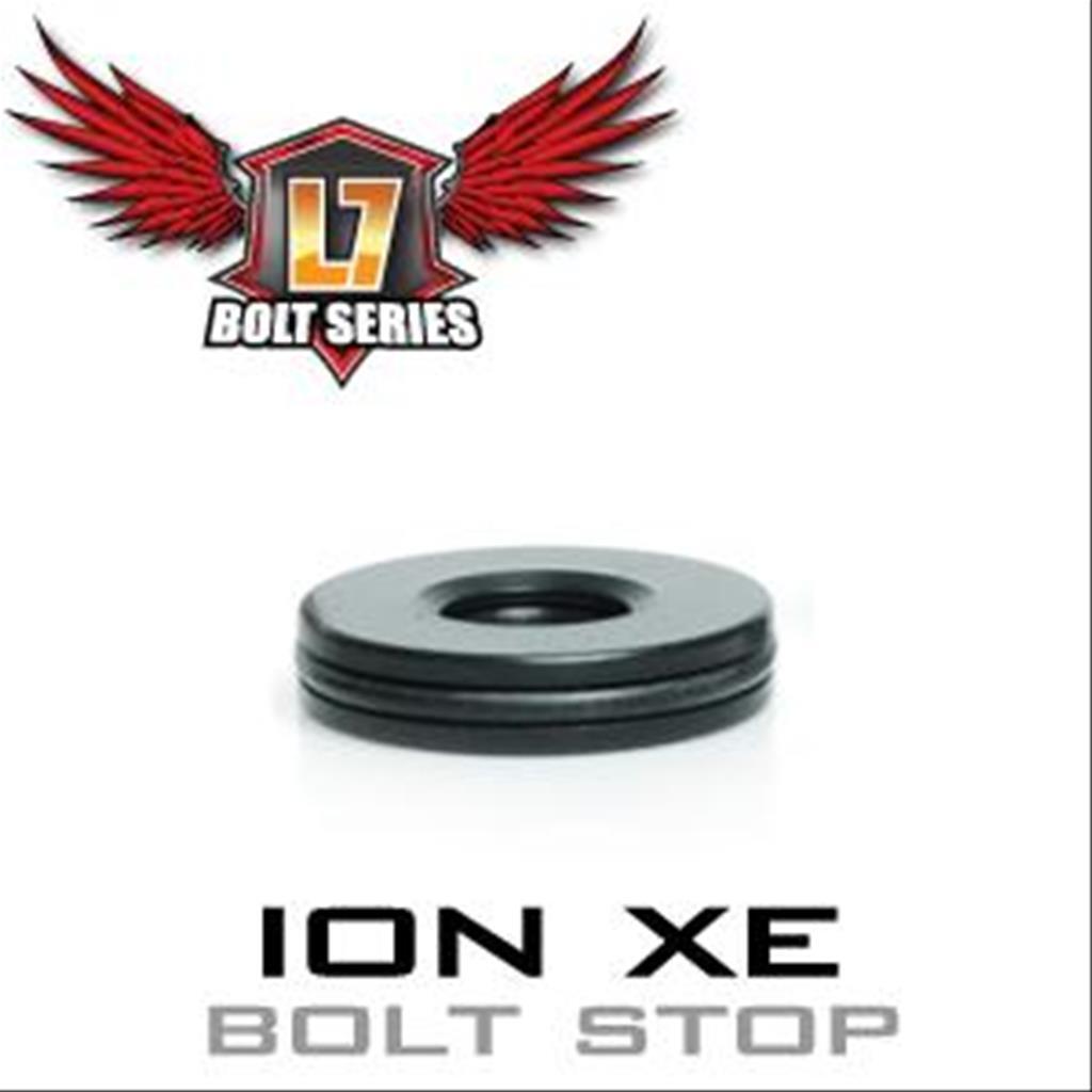

      Do you have a picture to explain this?

        Yes.
        Ion bolt stop:
        Click image for larger version  Name:	images.jpeg.jpg Views:	0 Size:	6.4 KB ID:	373593
        Notice the "step"? Ion XE bolts, and every other Ion-based marker that uses the bolt out back (BOB) style system, uses a slightly shorter bolt stop that doesnt have that "step". That's why XE/SP1/etc bolt kits say they won't fit an Ion, it's because the bolt stop included in the kit doesn't work on a plain Jane Ion. The bolt will work fine.
        XE bolt stop:
        Click image for larger version  Name:	ThumbnailHandler.jpeg.jpg Views:	0 Size:	46.3 KB ID:	373594

          Very educational. Thank you for the information
