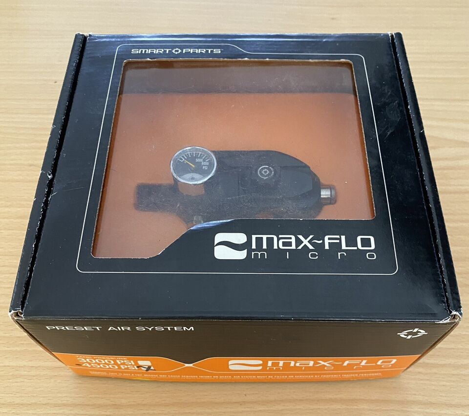

    I got a brand new, old stock MaxFlo Micro with the rail and everything. I bought a rebuild kit specifically for the micro with all the internal parts I need to rebuild it. The kit is also older, so I bought it for spare parts, not the o-rings. Maybe that was dumb, but what I'm wondering is... is there any part of it that I need to re-grease/oil besides the orings to make sure it'll hold air? I'm going to get all new o-rings from my big ole kit, so don't worry about that. I haven't used a maxflo before, so I want to know if there's anything I'm going to run into that causes issues or something to do that's preventative maintenance before I put it on my gun? I have the PDF from zdspb, but I wanted to hear some opinions from other users.
    is this in any way outdated and bad to use? It's going on a pretty hybrid nxt until I find my grail sft.
    i forgot to mention that I have to replace the gauge as it was clipped by the rail during shipping and has a tiny crack. Gauge is ordered, but I haven't replaced a reg gauge before either. Anything different from changing one on the vasa?
    Thanks!

    The only part I'd be concerned about other than orings is the reg seat. Iirc it is the same or very similar to modern GoG/Luxe seats.
    • SupremePB47
      SupremePB47 commented
      what would be your concern? It's brand new, would that change anything? I'm assuming it gets loose or something like that?
    • Toestr
      Toestr commented
      The reg seat is urethane iirc. It degrades with age. I've seen urethane reg seats and orings either crumble or turn to goo and extrude under pressure.
    • SupremePB47
      ah magnificent.
