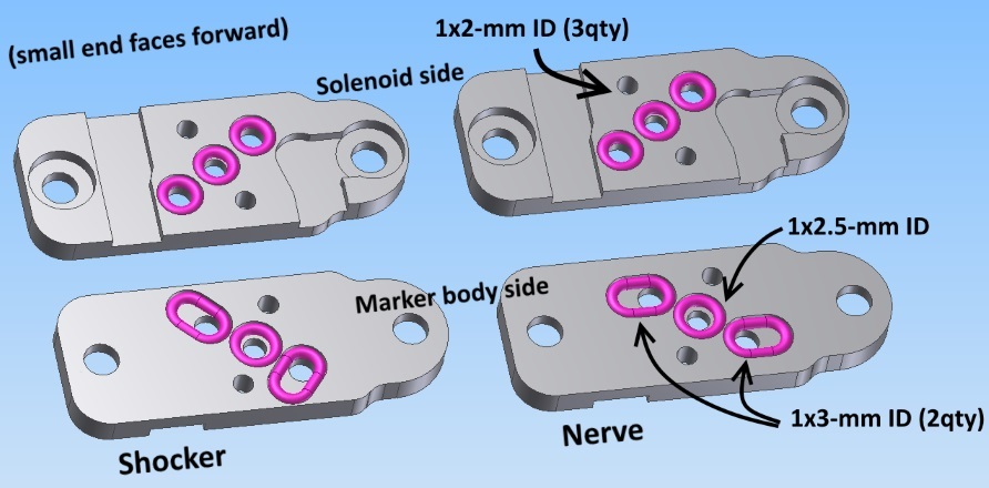

    I'm rebuilding two SFT's and none of the oring kits I'm seeing have the tiny solenoid insert orings or the weird oval-shaped orings inside the manifold. One of my guns has a slight frame leak which I doubt is from the solenoid, so I want to start replacing those seals and if that doesn't knock it out then I'll start hunting a noid.
    I plan to just order a bunch of the individual orings but can't guess the sizes. Can anyone help me out with what sizes I need to look for?

    ZDSPB will most likely have all of the answers to your shocker related questions. I would agree with you that your leak is coming from one of these 6 O-rings.
    https://www.zdspb.com/tech/mguide/sh..._solenoid.html

      While it would mean you would need to buy more then you need you can get individual sizes from the O ring store
      https://www.theoringstore.com/store/...oducts_id=1778
      Minimum: 50 Cost: .06 Total: $3.00
      https://www.theoringstore.com/store/...oducts_id=1777
      Minimum: 50 Cost: .04 Total: $2.00
      That meets there 5 dollar minimum and with shipping makes the total $14.95
      That is of course assuming that the orings are Buna 70 and not 90 or something else.
      • nighthunter
        nighthunter commented
        so I guess the 3mm ones just kinda squish into the oval channel? They must cause I'm having a rough time finding any that are just oval-shaped.
