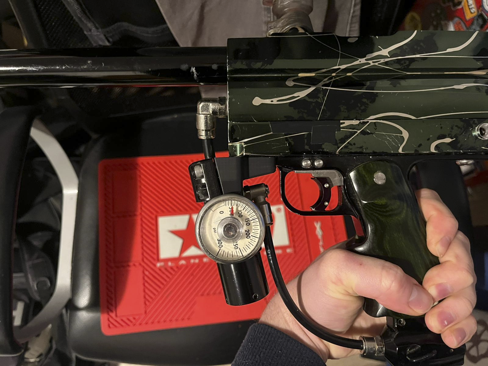

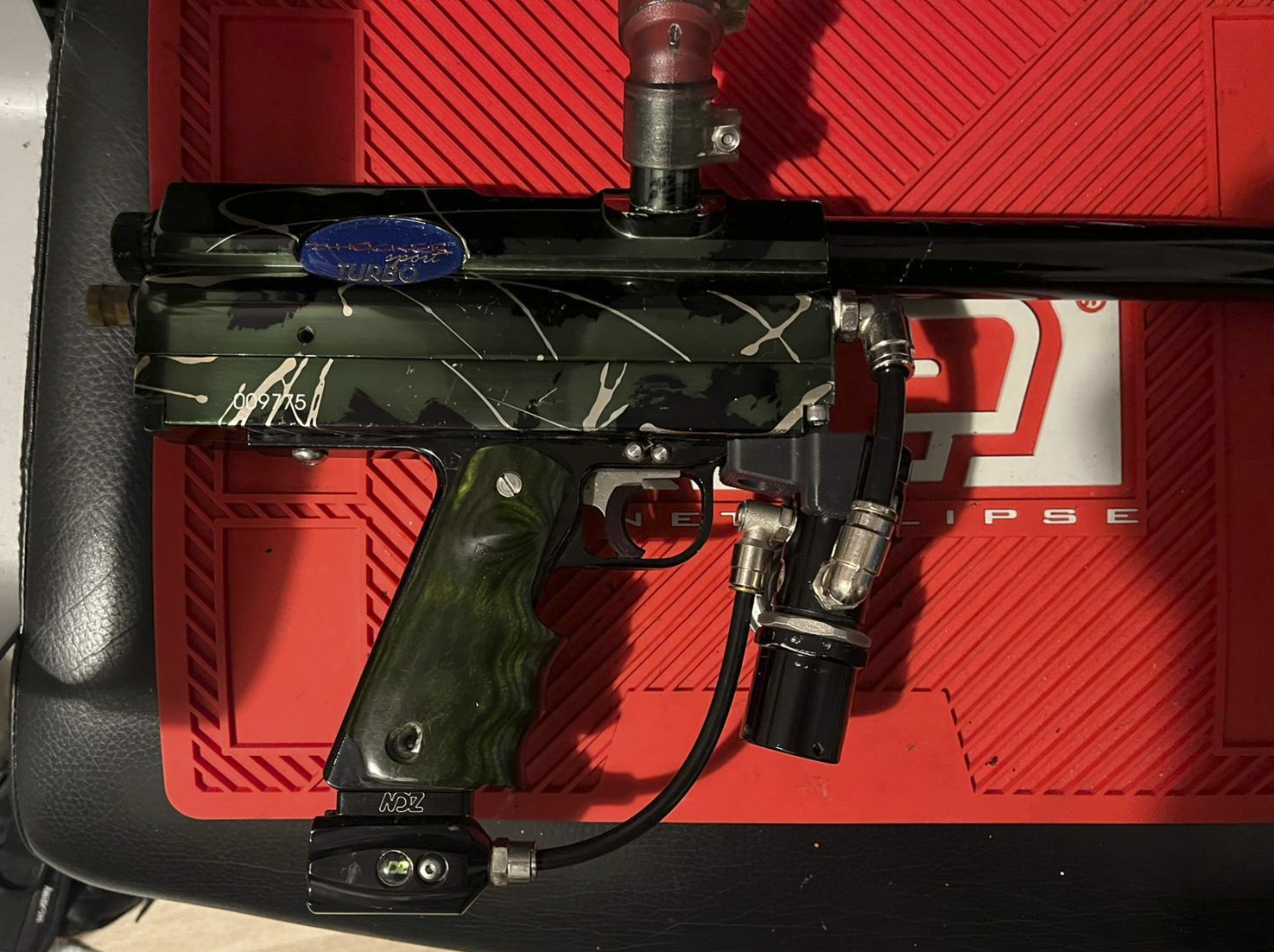

          Managed to Relocate the Max-Flo with a printed Bracket.
          I have not seen any angled mounts so this might be unique. If i go for a straight mount, i could probably have one machined at work, but for now printed is fine.
          Still some work to do, but I got to air up the marker for the first time and it seems to run just fine. Kind of odd to have Ramping on a marker this old. The Trigger is extremely sloppy and the safety pin doest restrict movement enough to actually render the marker safe.
