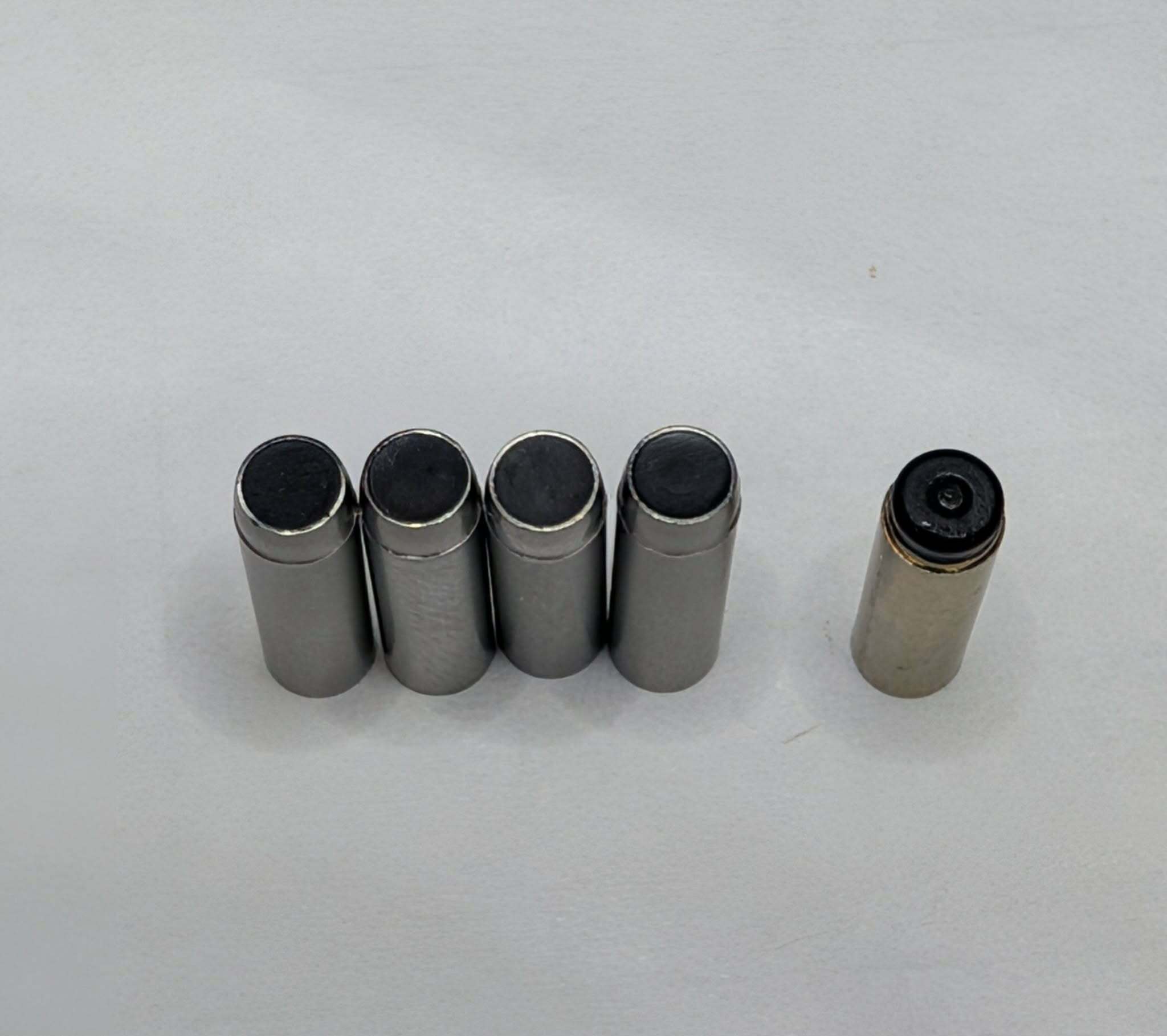

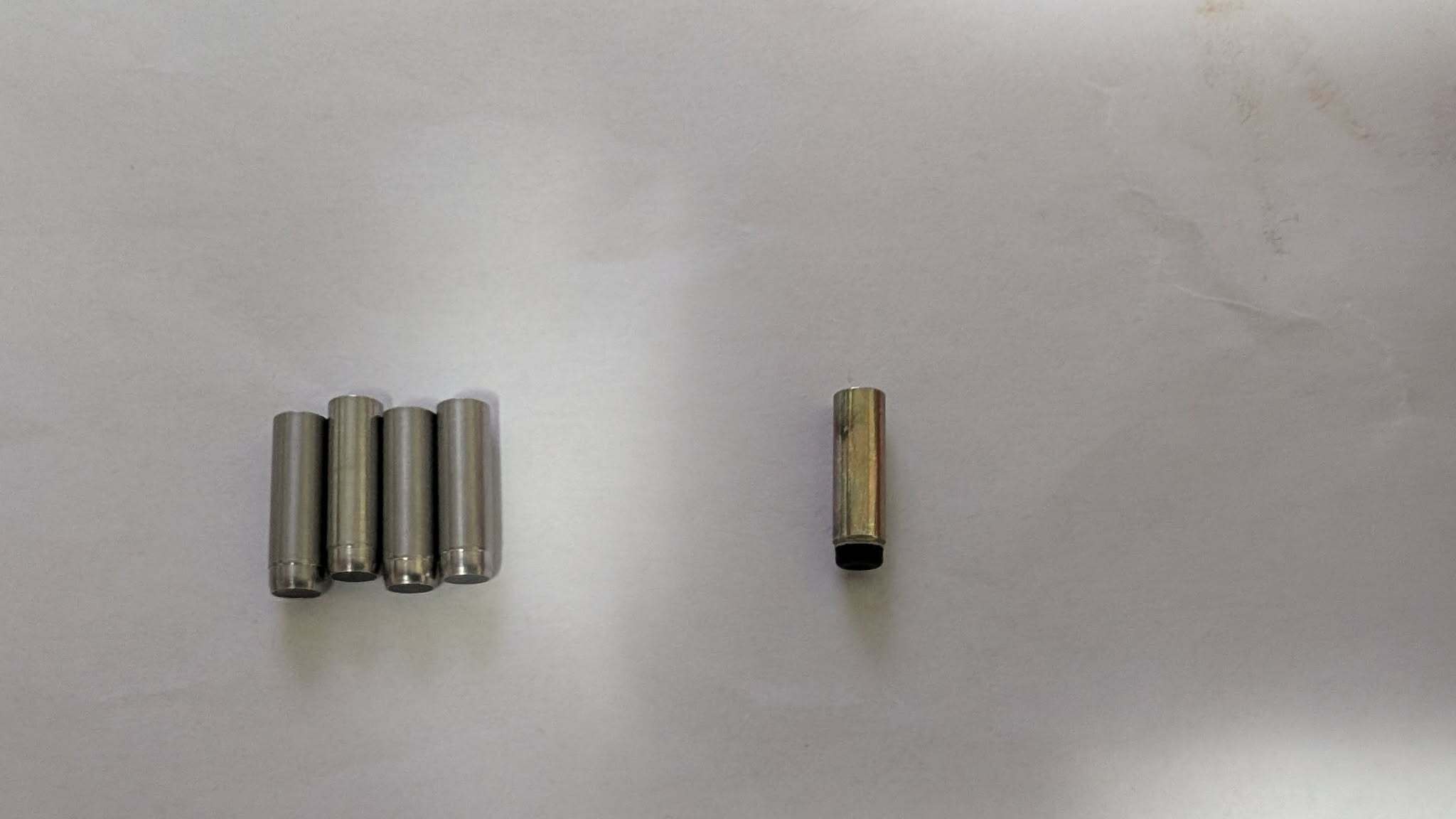

        I ended up buying four Doss Armatures. The seller was super easy to work with and he shipped them quickly for a reasonable price.
        Unfortunately, I'm not a fan of the design. I tried two of them out and neither could seal the bottom of the solenoid. They are a different design. The factory and the the Doss design are very similar, if not identical in regards to the top: a simple dot of sealing/padding material in the center of the face. The bottom face, the most important part, which seals against the solenoid vent hole.could almost not be any more different.
        I dissected an OEM model some time ago. The bottom seal is actually over-molded. The rod has a T-Profile at the end and the seal surrounds it. The Doss armature is bored out at the sealing end, and the sealing material is inside, and doesn't protrude at all. At best, it is flush with the lip that surrounds it. At least one of them, the sealing surface is below the edge of the lip. In my case, neither of them seal. And I don't mean a slow leak, the air rushes out the bottom of the solenoid.
        I worry about the body of the armature digging into and wearing the interior bottom of the solenoid.
        I really hope Doc gets to making some Armatures.

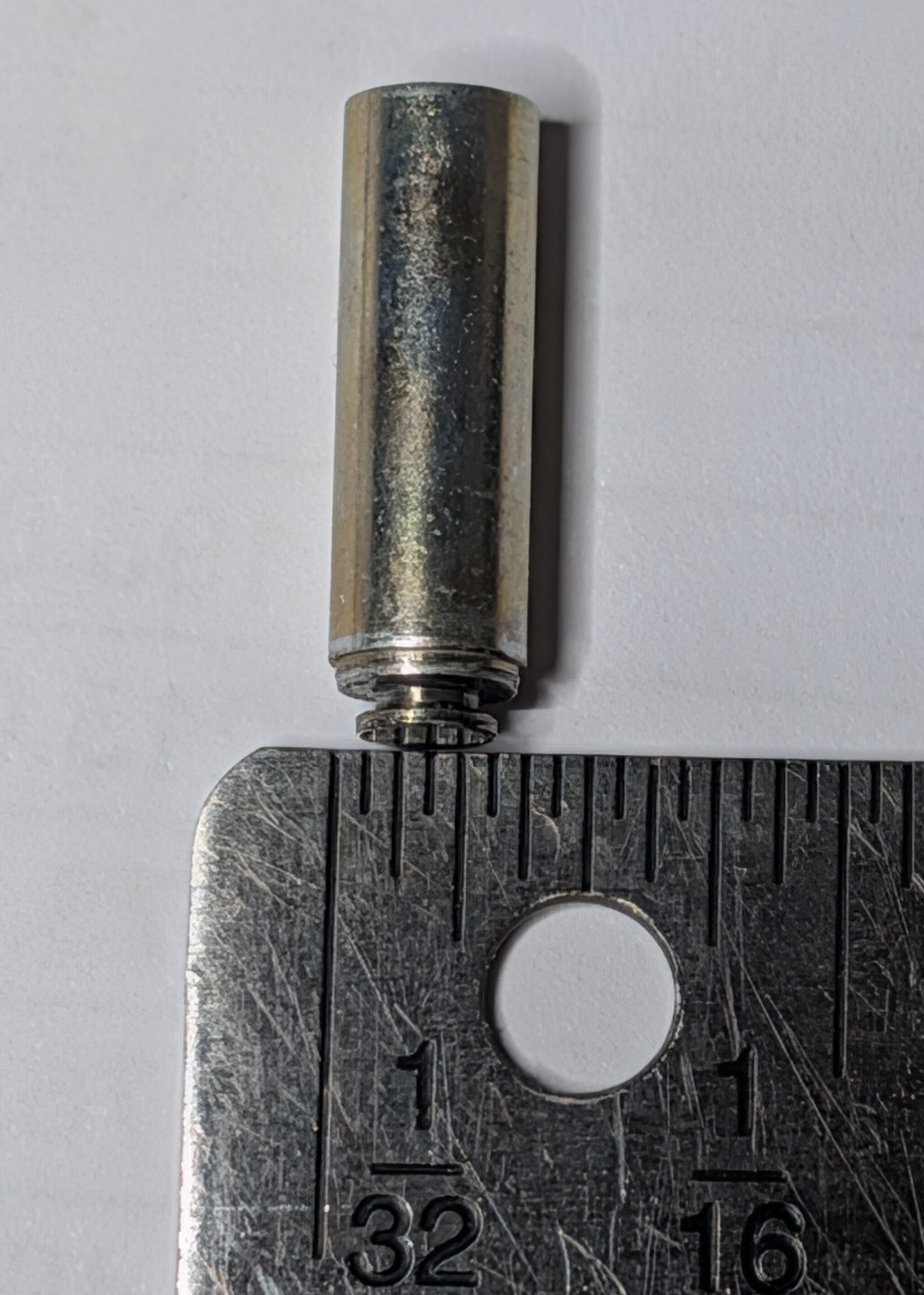

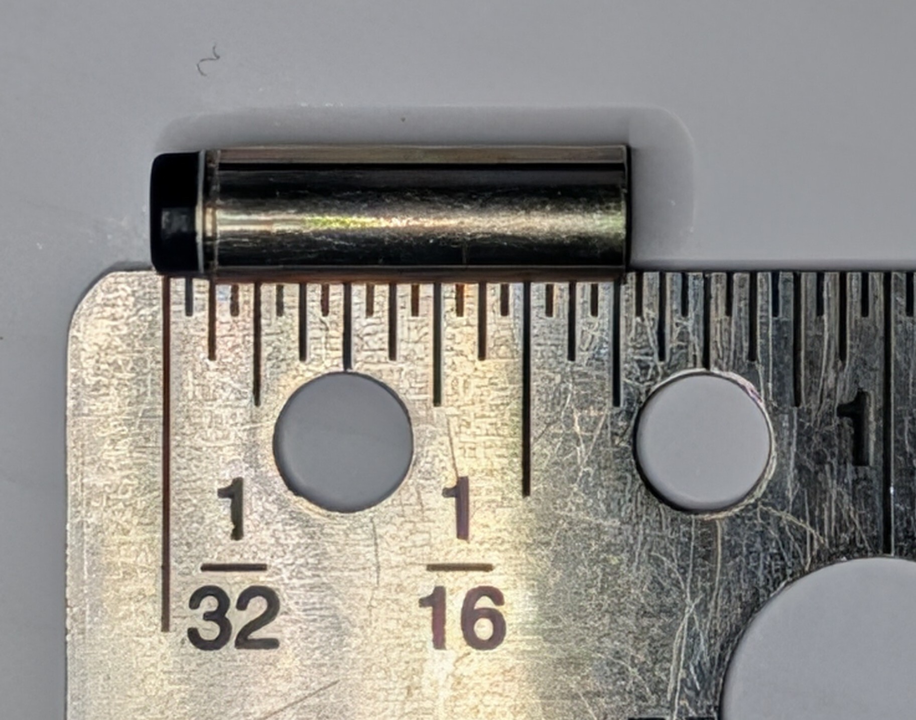

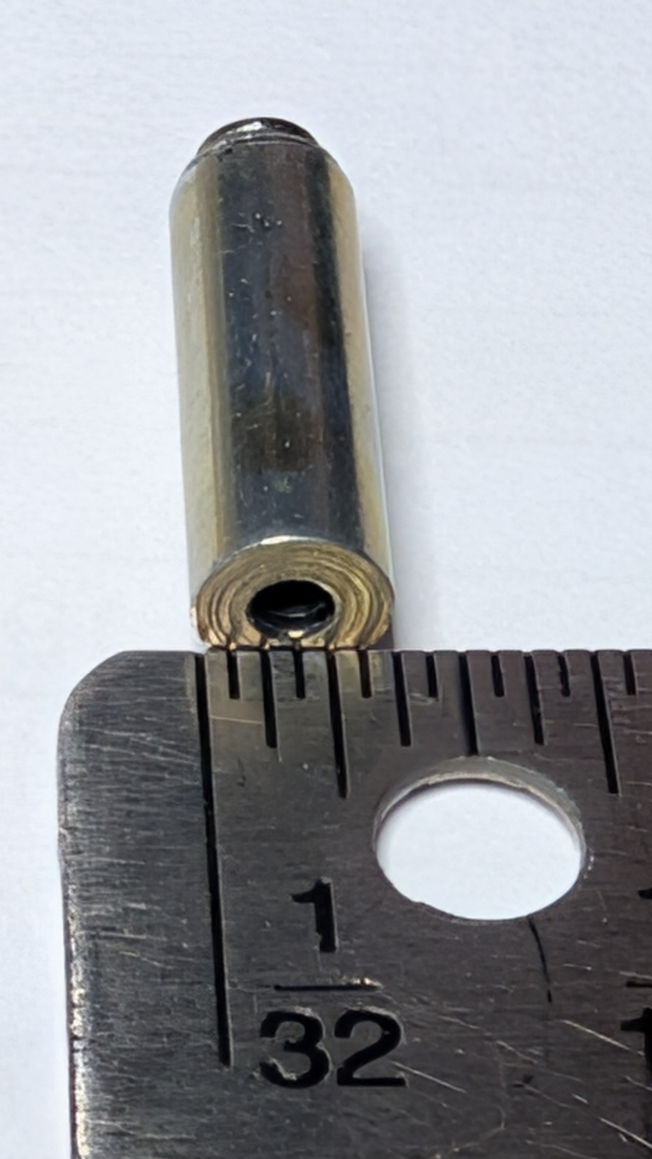

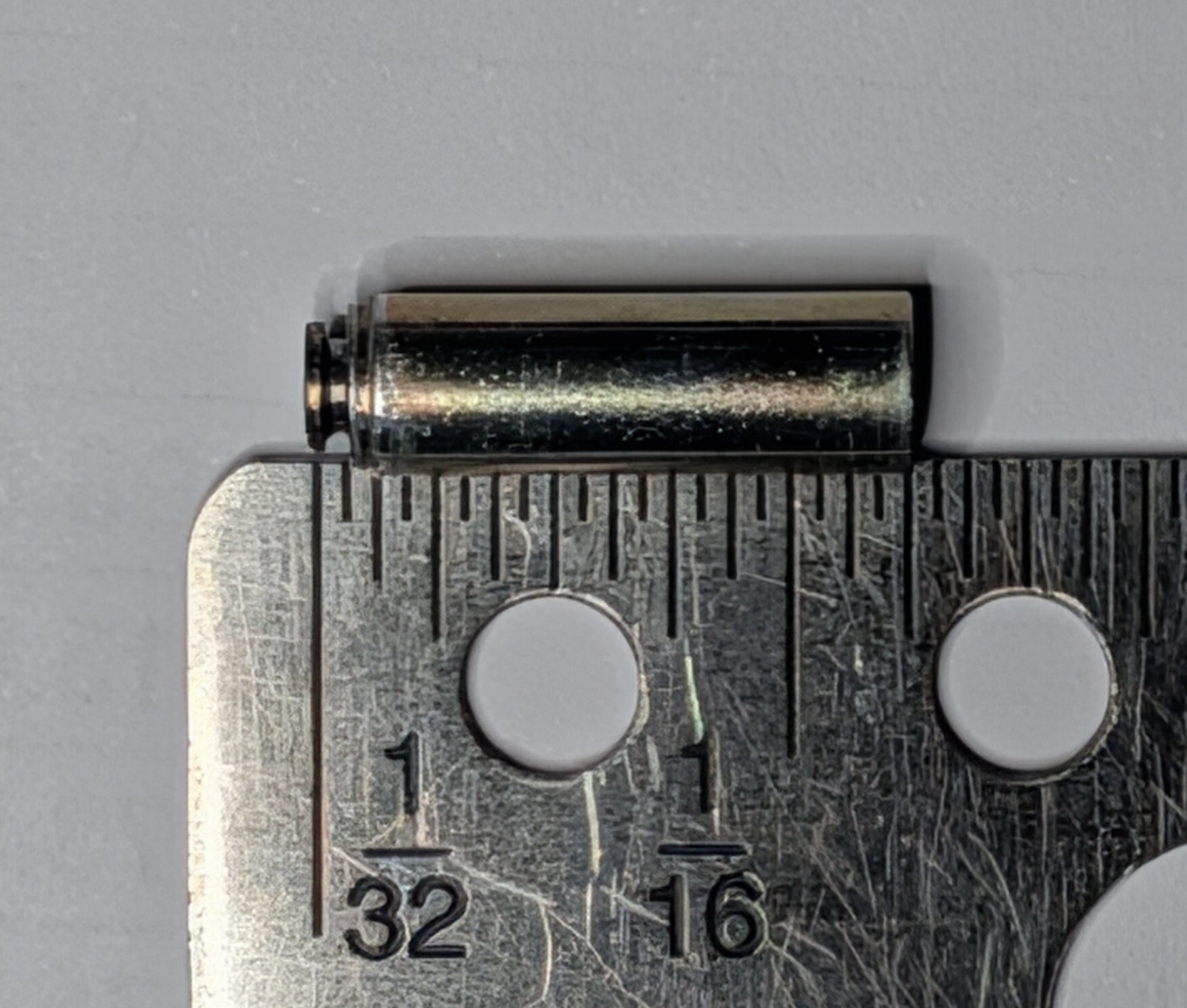

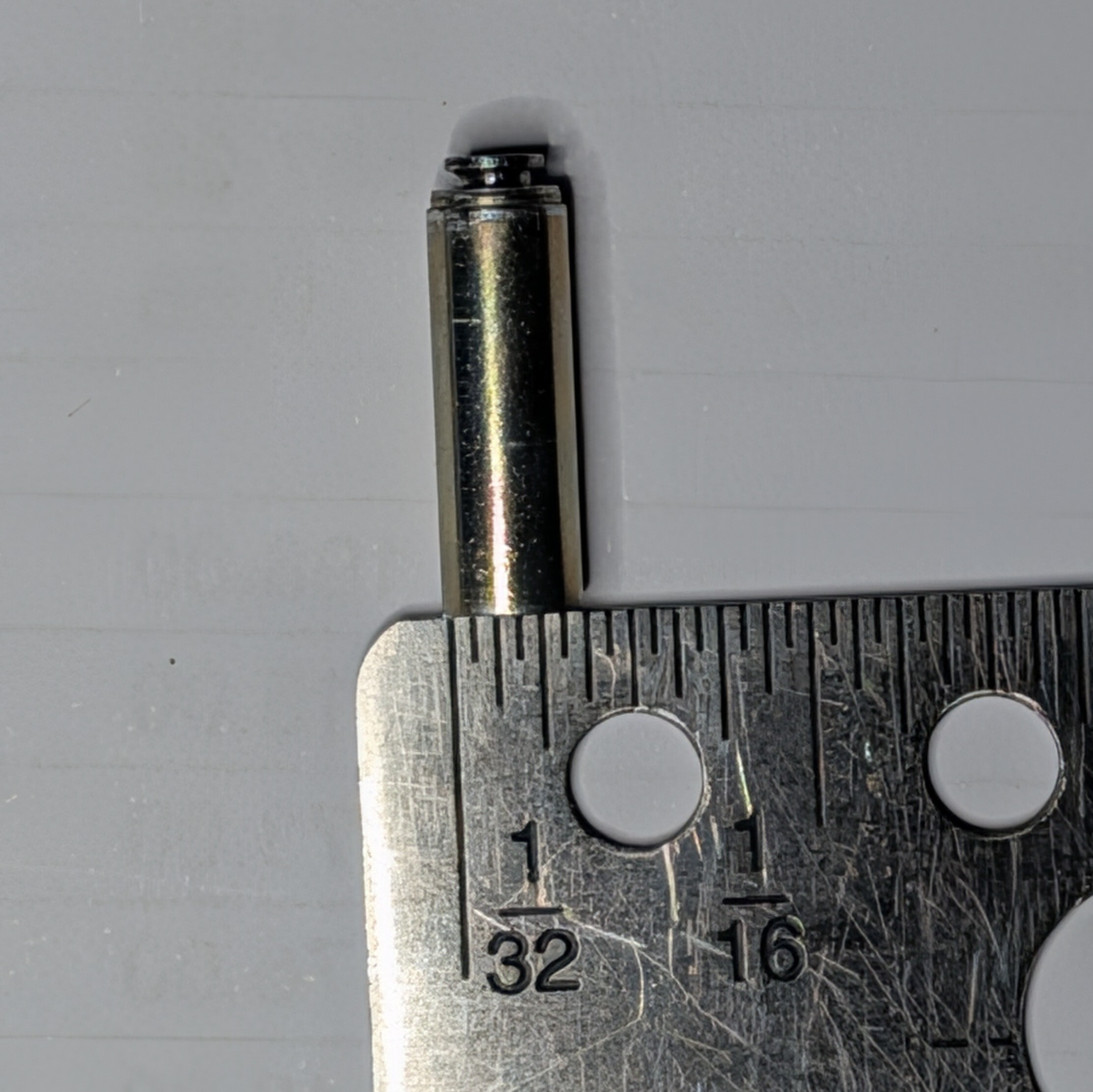

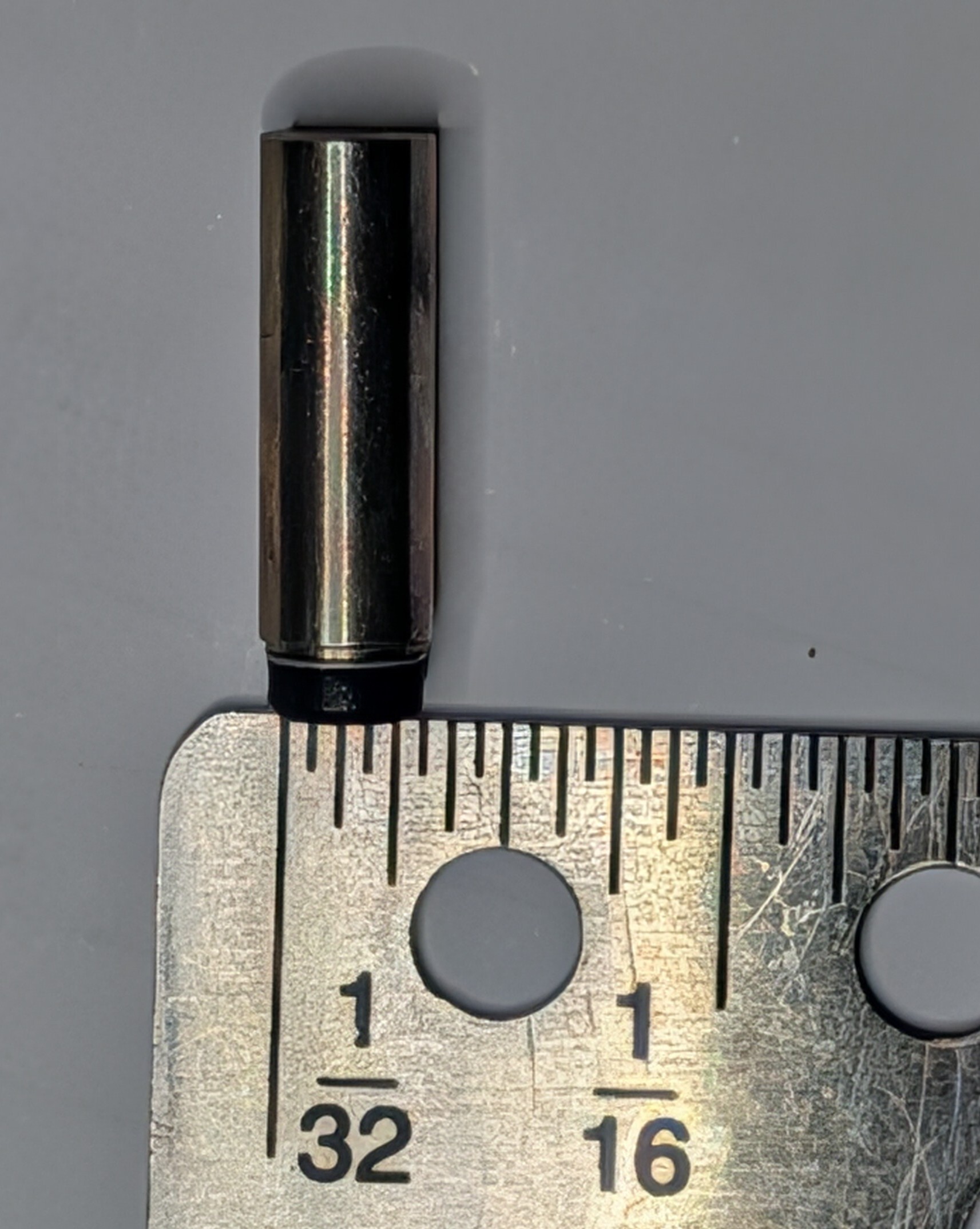

            As promised, here are my pics of the "dissected" solenoid along with my new old stock piece that is too sticky.​
            With my micrometer, the stripped armature measures:
            Length: 0.6365"
            O.D.: 0.1955"
            Groove Width: is somewhere below 0.0315"
            Flange (top of "T") width: 0.1380"
            I.D. (hole at top end): 0.0615"
            Hole Depth: ~0.1420"
            Other relevant solenoid details: The Solenoid inlet, is a very small nipple facing the armature. I believe that the top of the armature is meant to at least restrict the flow if not shut it off. it technically doesn't need to seal since the the exhaust of the solenoid is what allows the bolt to move forward and dump the fire chamber. Therefore, I believe the material at the top of the armature is meant to just provide padding to protect the solenoid inlet. The Solenoid Exhaust (hole at bottom of solenoid body) is actually 'countersunk' meaning it is a wide hole that narrows towards the exterior. How wide, I can not exactly say, maybe 60% wider than the bottom end? Definitely smaller than the diameter of the pad.
