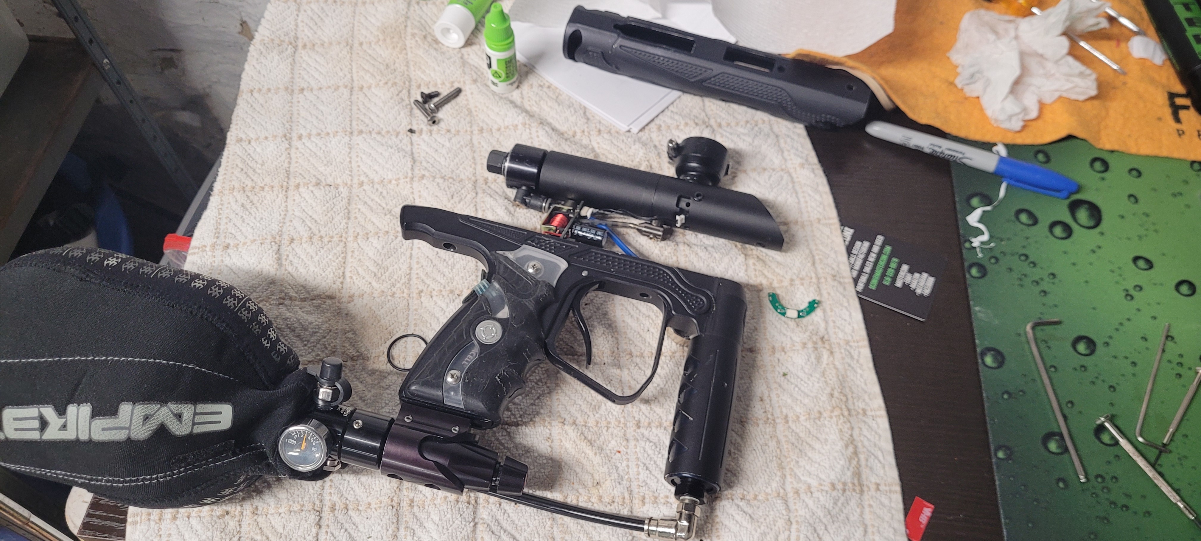

    Well I've got this Ion that's leaking down the breech. My generic o-rings aren't doing the trick so I've got a rebuild kit on the way with the right sizes. Let's see if that does it

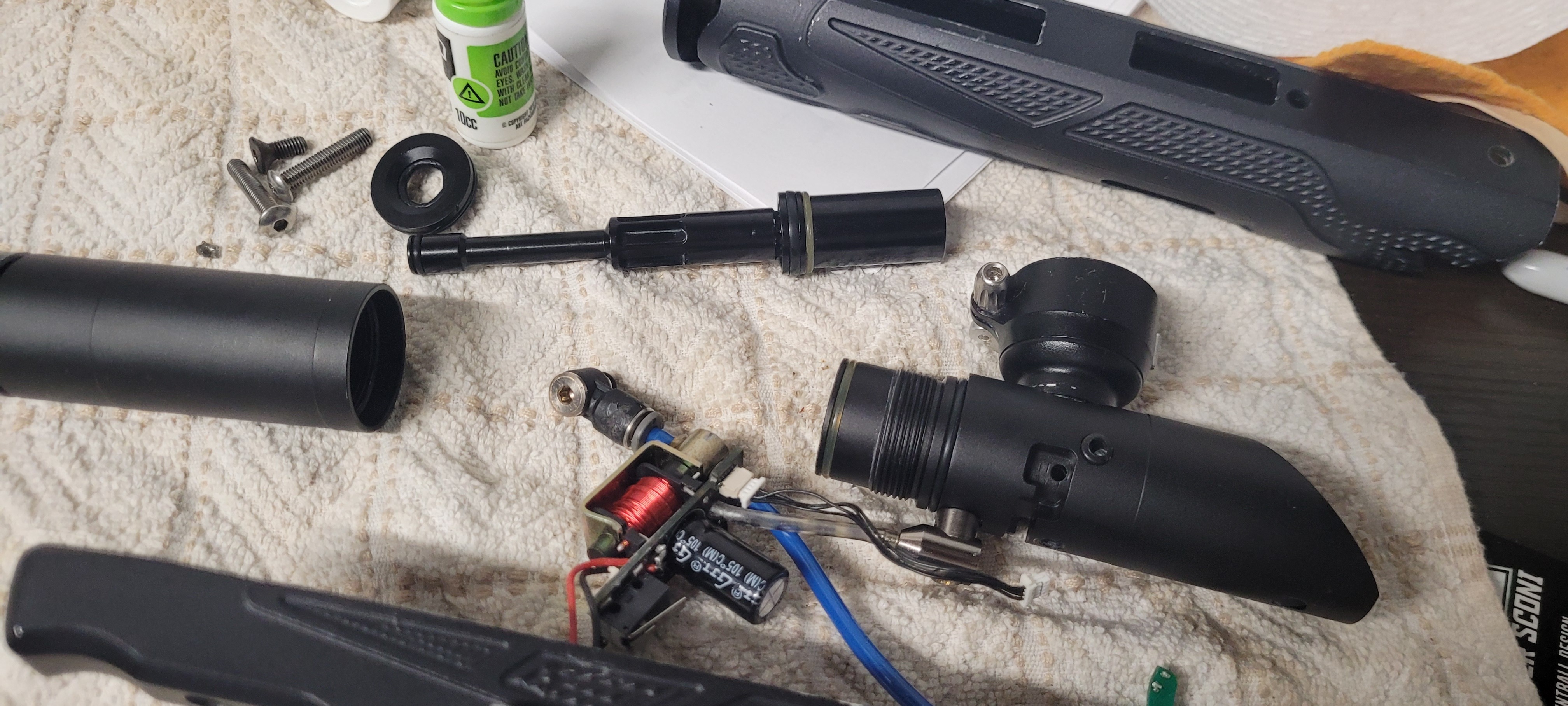

    So, I got the o-rings in and reassembled....still blowing air down the breech 😑
    I re-read the troubleshooting guide https://www.zdspb.com/tech/mguide/io...neumatics.html
    • Replaced every o-ring with the correct sizes
    • Verify that the tip of the bolt and the middle section of the bolt are both unscratched.
      • Nothing too bad from what I can see
    • Verify that pressure is indeed moving through the solenoid while the marker is idle.

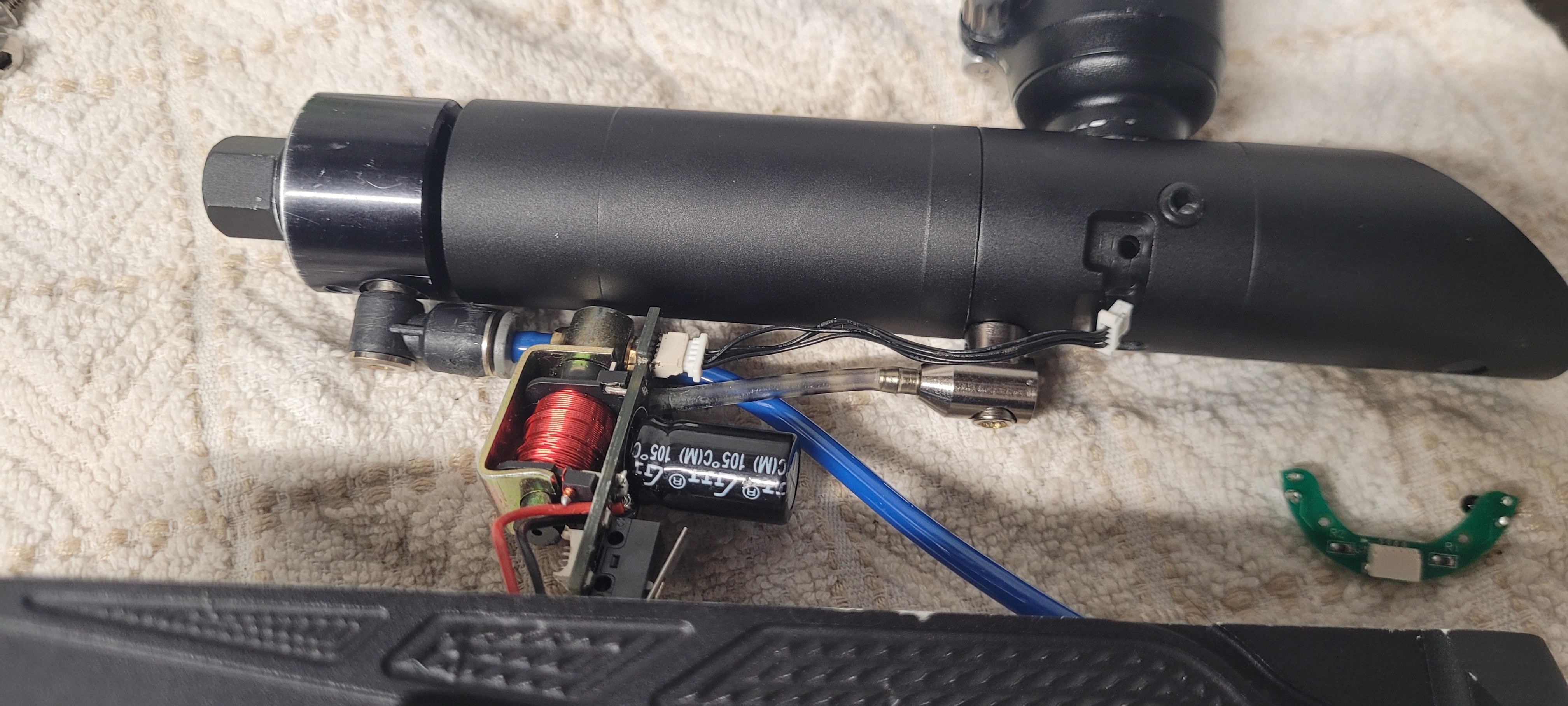

      • When I pressurize the marker, air is blowing out the middle banjo...so my solenoid or board may be damaged?
    I took the solenoid apart and didn't see anything too telling...it's also a virtue board if anyone knows anything further I could troubleshoot ?
    I've got a stock board I'll put in to see if I can confirm its the board/solenoid and not just poorly fit o-rings...
    I've also used up all my air so I gotta hit the field and get them refilled!

      Did you replace the 1.5x3mm orings on the banjo bolts?
      • Sdawg
        • 436
        Try replacing the middle fitting. You have a 360 QEV, and if the diaphragm goes bad, it could vent air continuously.
        Replace the hose/tubing. After 20ish years, the tubing may fail under pressure.
