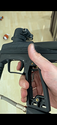

    Found a fitting that may work. It has a male 10-32 threaded end with an o-ring to seal it against the vertical ASA, and a 5/32 push connect end that matches the OD of the tubing I currently have.

      Nice, yeah I was thinking it would be cool to find a push-to-connect fitting for the front. Also not a bad price. The operating pressure is a bit low but from what I understand that's typical of all fittings in paintball.
      Depending on how much space there is, it might be worth throwing a washer on the upper portion of the valve, so the trigger has a slightly longer pull. YMMV, but I always find a super short trigger to be slower than one with a bit of travel.
      • gnarlynick
        gnarlynick commented
        I did have reservations about the operating pressure as well. I believe these markers are operating close enough within that range that it likely shouldn't be an issue. I have found an alternative fitting with a higher pressure rating should that be an issue. We'll see.
        Regarding the valve placement, I believe any more adjustments up from the trigger frame toward the upper body would require some mounting fixture to be designed to allow for that. As it is currently, there are probably 2-3 threads showing through to the grip area for the nut to screw onto, not much wiggle room left. I could probably grind down the end of the actuator pin a bit to add a bit more distance between the trigger and the pin contact area. I'm also planning on modifying the trigger a bit and printing a new one for this, so perhaps that's where that distance can be fine tuned a little more. I won't do anything until I can pressurize the system as it is right now and see how it cycles.

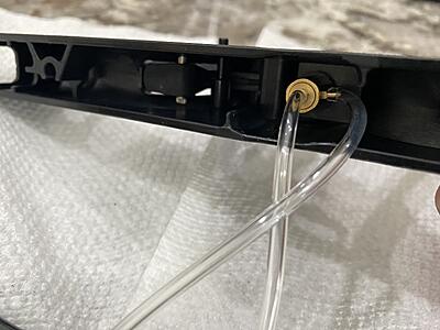

      The ASA fitting arrived today. Screwed it in finger-tight which is why I believe it's leaking in the video, but did a quick proof of concept. The hose lengths need to be adjusted to get everything to button up, hence why it's all pulled apart.
      https://youtube.com/shorts/W1MMbGlk2...fajDMQOn8LF5ao
      Update:
      Now with no leaks!
      https://youtube.com/shorts/EMVWjEcS8...vN8sQXWXwWngJt
      Had to shave off a thread's length to get it to fully seal against the o-ring. Also added a bit of thread seal tape. In the process, found that the over pressure exhaust is in the most unhelpful location for troubleshooting a leak in this exact area. Apparently the reg seat I put in the other day already went bad? Anyways, progress. The tubing that came with the SSC kit is cut to size for an Ion and it doesn't quite work for this. I may look into ordering some more and cutting it all to length.

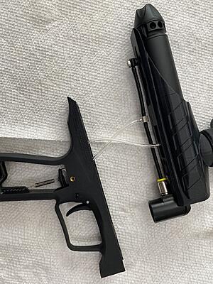

          Holy hell this is getting frustrating. When trying to close everything up with the body on the frame, either of the two lines on the SMAV-3 barbs get knocked loose and come off when I pressurize it.
          While trying to play with different configurations of placing those two hoses when putting the two halves together, the reg's overpressure valve starts exhausting air again. Not sure why I'm going through reg seats on this reg like I am, clearly something is wrong. I dialed it in to around 150 PSI. I'll swap some of the pressure/velocity adjuster parts out with some other spares I have. Maybe the piston spring?

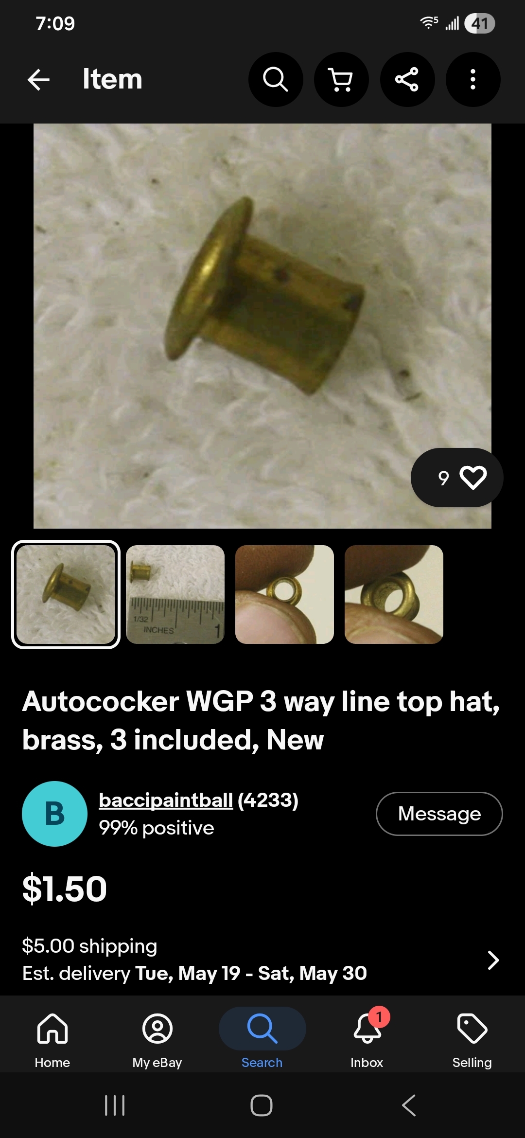

          Are the old school tophats used in autococker 3 ways still around? Might be just the thing to mechanically lock it.
        • gnarlynick
          You think the SMAV-3 is 6-40 threaded?
          Disregard, I thought you were talking about the barbs that screw into the three ways.
          Do those tophats just slide on and hold everything together or do they need to be crimped?
        • Calvin
          Calvin commented
          IIRC, you place them over the hose, push the hose onto the barb, and then back the tophat over the hose on the barb. It wasnt crimped, and was reusable.

        Probably a certain type of brass grommet. I cant see those being manufactured for that one use.

          I ordered some top hats to see if that'll remedy the 1/8" hose fitment issue. Not sure on an ETA for those at the moment.

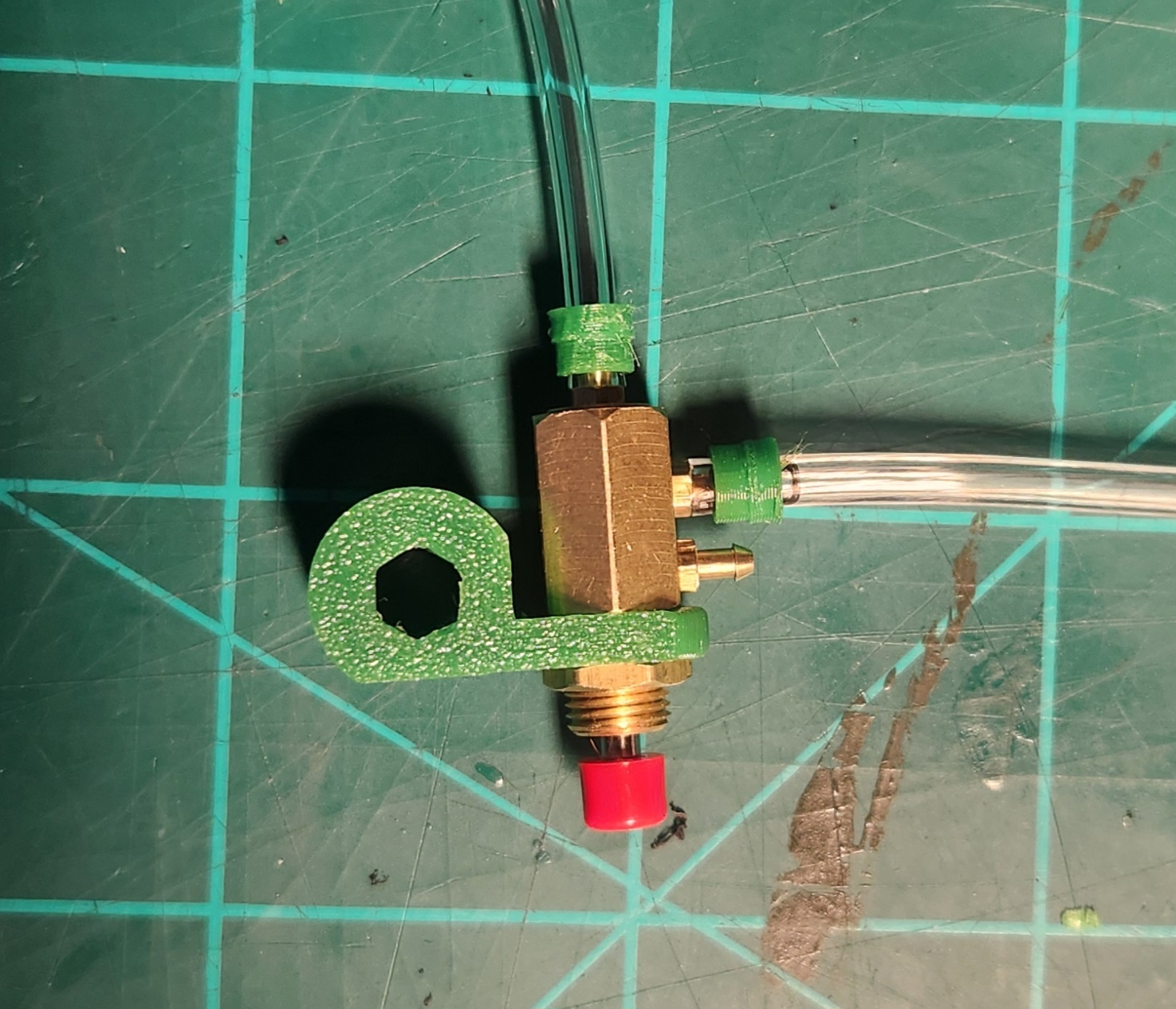

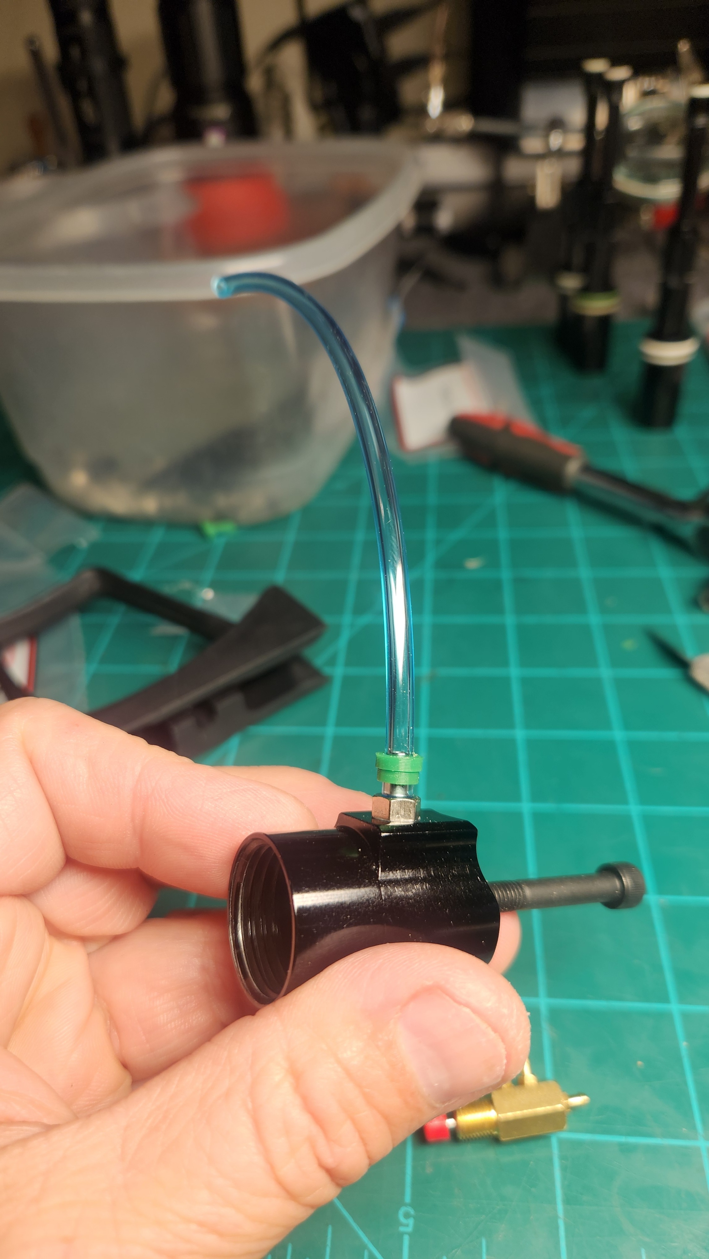

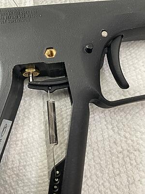

          I just got my order of Clippard parts for this project. I am working on a SMAV mount for the Envy trigger frame. While I was at it, I made up some tophatesque hose clips to secure the hoses. Took a couple tries to get the fit just right, but the larger hose size is done. Will get the smaller hose clamps done after dinner before working some more on the SMAV mount.

            SMAV mount and 1-16ID hose clamps completed. I am quite sure these will retain the hoses on the barbs. Sadly, I purchased three Smart Parts QEVs not realizing how huge the barbs are. I installed two of those QEVs to my two Enmeys, and ordered three Clippard MEV-2 with a 10 pack of 10-32 to 1/16 barbs. What's another week of waiting. 🤷‍♂️

            In addition to the tophats, I had also ordered some autococker 3-way hose and that material seems to be more rigid than the (I'm assuming) silicone hose included with the SSC mech Ion kit I had. This allows it to get a better grip from the hose barbs on the SMAV-3 and it's in there pretty good now and I don't believe requires the tophats. Takes quite a bit of effort to pull them loose.
            I was able to close everything up and do some test fires. The trigger certainly needs redesigned as it currently resting right against the SMAV-3 actuator makes completing a cycle inconsistent. I will try and carve out some time in the near future to modify the trigger model and see what works best with this setup. The part of the trigger that contacts the actuator needs to be brought downward quite a bit.

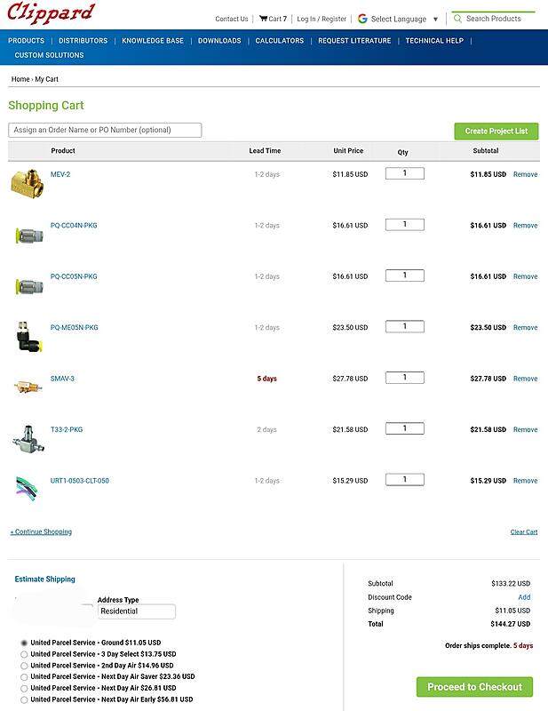

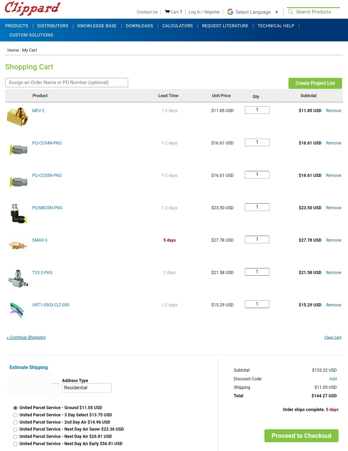

            Once I get it all sorted, I will likely do the same to the other eNMEy I have from the POP build. I believe this cart screenshot should serve as a sufficient BOM. I'm opting for all quick connect fittings so separating the body from the trigger frame is a little easier. You can sub those out for barb fittings if you prefer. Note, the 1/8 OD hose isn't in this list as I'm using the autococker hosing.

            Thank you for this post. I ordered the parts from clippard and got it together the same day. I was able to use the stock trigger with a spacer under the SMAV to keep it as high as possible. I didn’t end up using the QEV since the barb was way too big for the 1/16 tube coming from the SMAV. I like the idea of a push-connect fitting, but it required grinding the first 2 ribs in the trigger frame to fit. I have my SMAV ports facing away from the grip boss so no grinding needed there, the tube does a 180 in its routing to the upper which adds some strain relief during disassembly. Overall it seems to work pretty well trigger pull is definitely snappier and shorter than stock.
