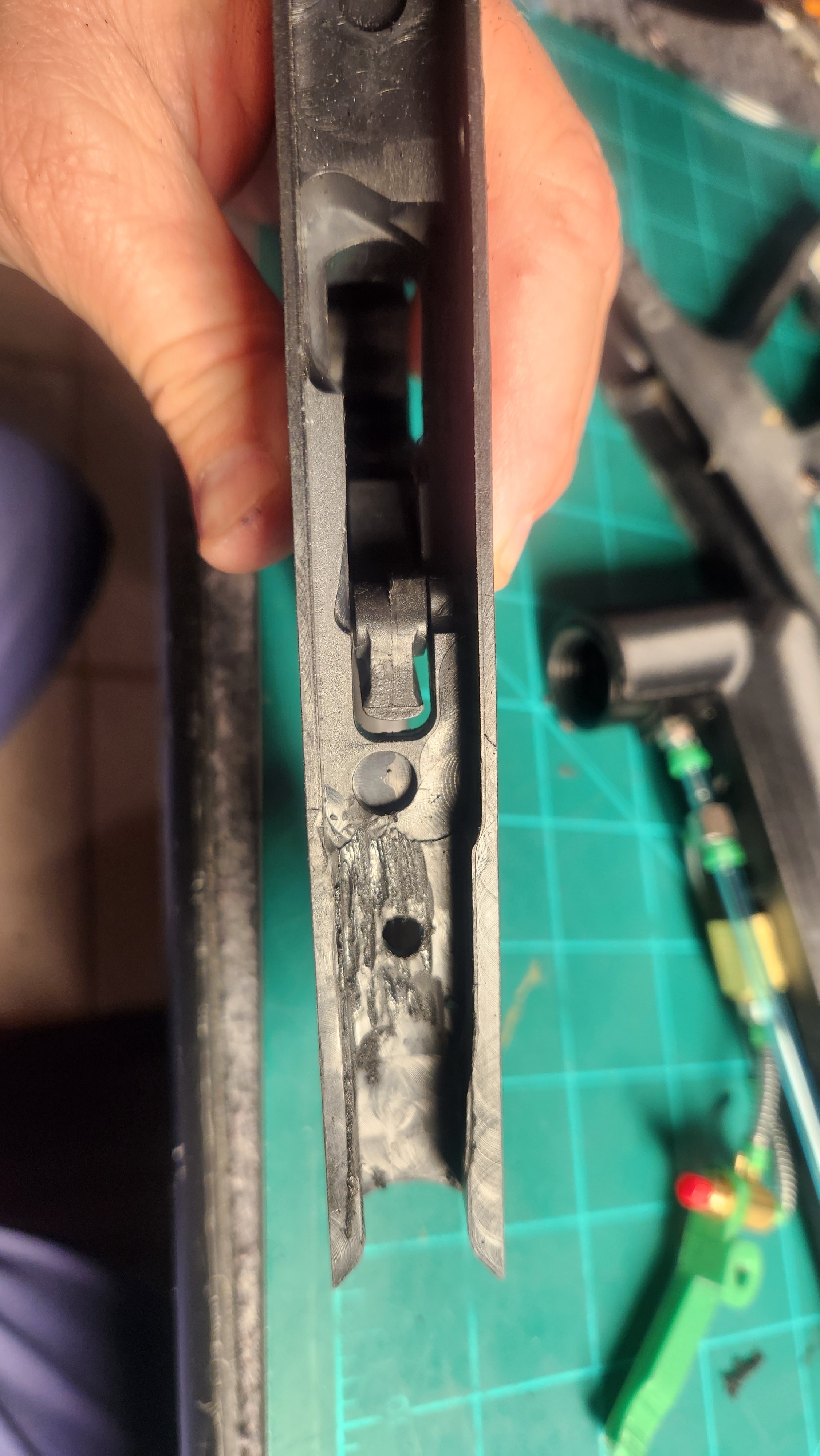

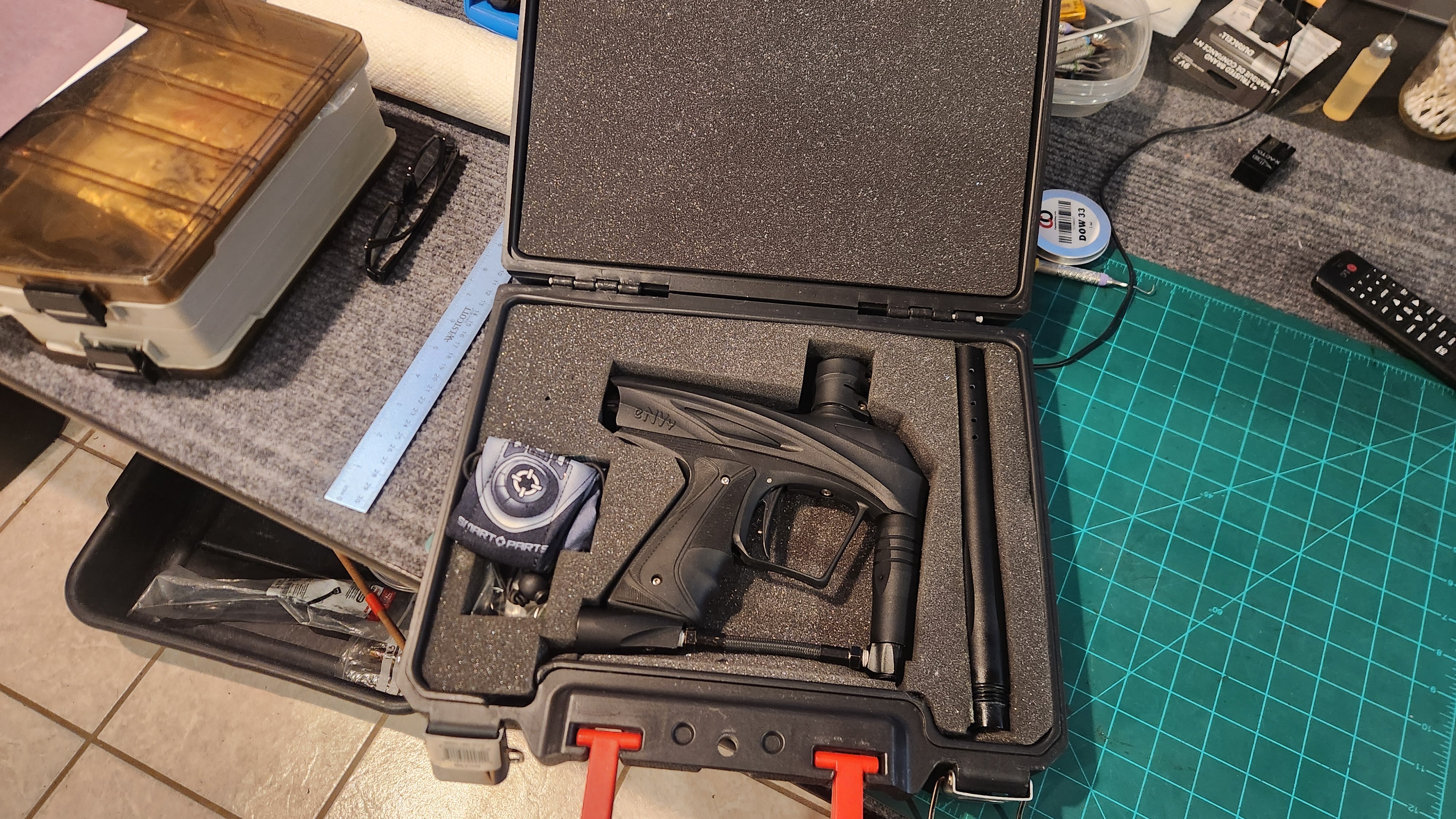

              I received the first two Envys.
              Envy 1 was great looking on the outside. Didn't have a spec of paint on the inside of the body, which is a weird buying experience for me. It had a blackout board and eyes, which is kinda cool. The aluminum body fits right into my printed external body with no issues. My printed detents also fit right in. The board powered on, the eyes worked. Everything was going great. The reg adjusting piston was frozen, which is never good. I put one of my known good maxflo regs on it and aired up up after cleaning and greasing the bolt and putting new orings on the banjo bolts. The solenoid was leaking badly, but the gun cycled just fine. Inspection showed a crack in the solenoid cap right behind one of the screws. I ordered 2 Dye Proto Rail solenoids immediately so I can do the repair.
              Click image for larger version  Name:	20260428_103850.jpg Views:	0 Size:	886.7 KB ID:	830778

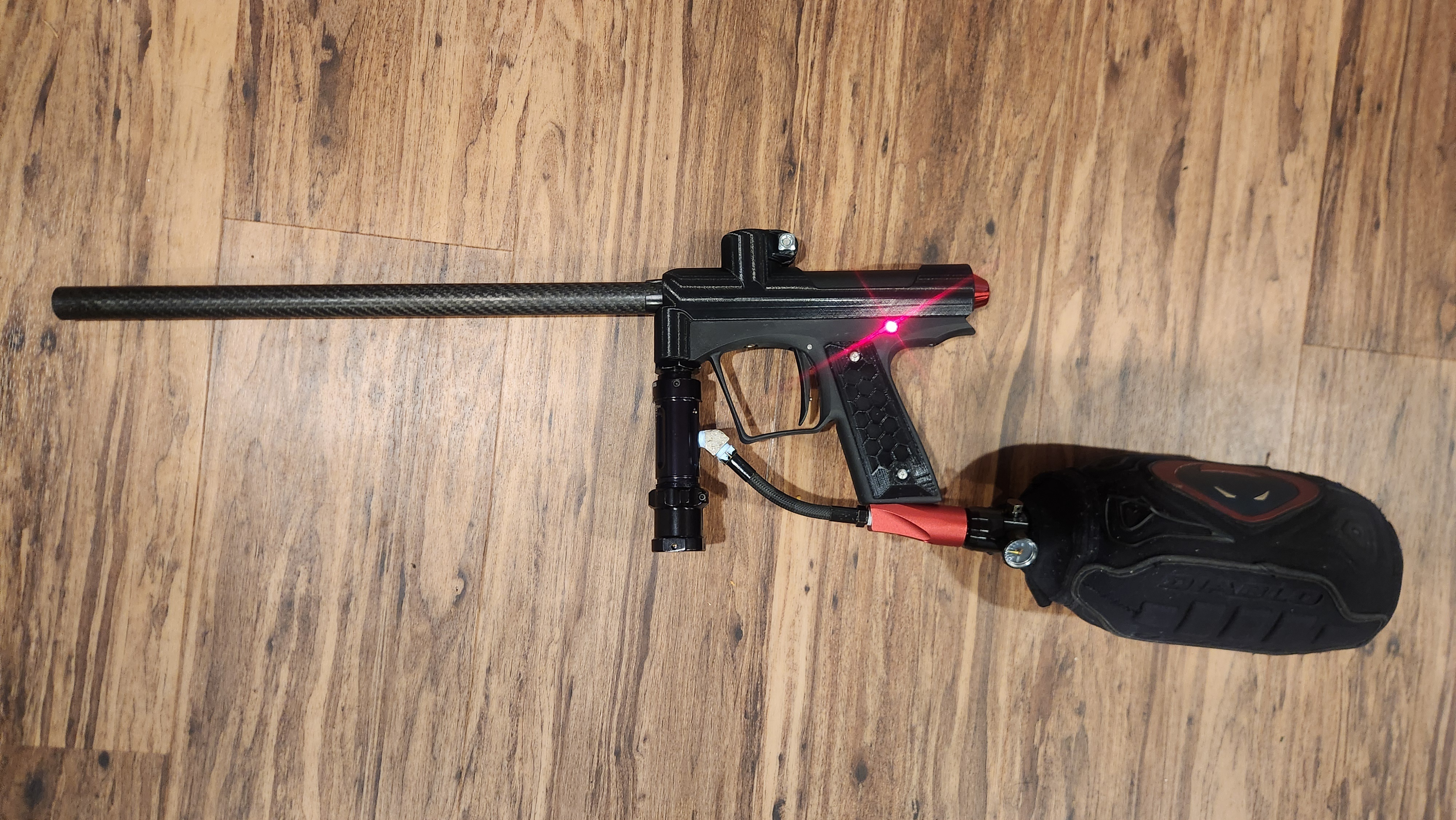

              The second Envy showed up today. It also looked great outside.
              Click image for larger version  Name:	20260429_140134.jpg Views:	0 Size:	2.77 MB ID:	830780
              It was absolutely full of grease, so I washed the bolt and body and relubed appropriately. Even the reg seemed to be fully functional. I turned it way down, in case it had been set too high by the previous owner, finished my checks and aired it up. The marker held air and cycled. Hot damn! I finished getting everything together and took a pic.

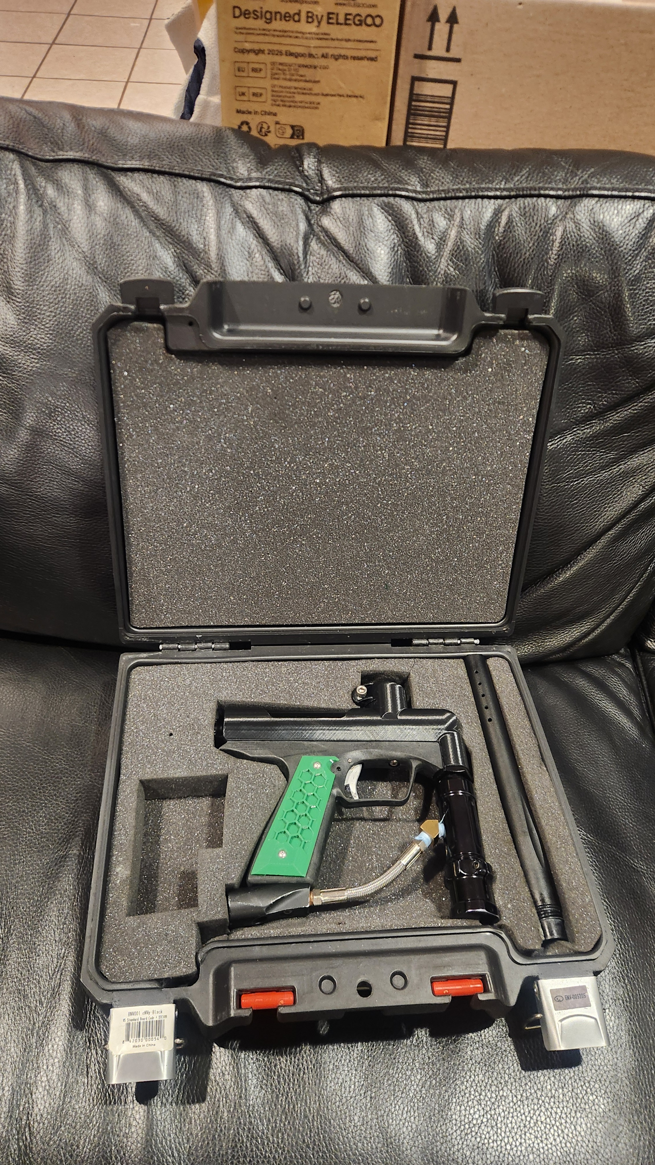

              Click image for larger version  Name:	20260429_154831.jpg Views:	0 Size:	1.94 MB ID:	830777
              I am gonna love these things. All the modes were working. I put it in select fire to experience the 3 round burst and full auto. Fantastic! Put it back in semi and went out to chrono. It was firing 290 in no time. I came back into the shop full to the brim with excitement. I had been to the mountaintop. I had seen the promised land. As I sat down, I started to hear a faint hissing. Cursory listening indicated it was probably the solenoid. Breakdown and airing up without the grip confirmed it. Probably the same crack as the first. 🤕
              What I can confirm, is that I will like these once I repair the solenoid cap. They swap out bits easily with out Emney build parts. I have a 3rd coming at some point. If it also has a bad solenoid, it will be getting the Smav-3 conversion treatment. The one difference externally between the Emney and the Envy is the spacing of the banjo bolt holes. They are a little closer together on the Envy, so just moving the board to an Emney, or the valve to an Envy ain't happening. However, I think the Smav-3 conversion might work well on the Envy. It seems to have plenty of space in the grip and frame. I'm confident it can be done if needed.
              At the very least, I have 2 kickass cases to transport these and/or my Poo builds to the field with. I shall have some experiences with these solenoid cap conversions shortly.
              Click image for larger version  Name:	20260429_165037.jpg Views:	0 Size:	2.83 MB ID:	830779

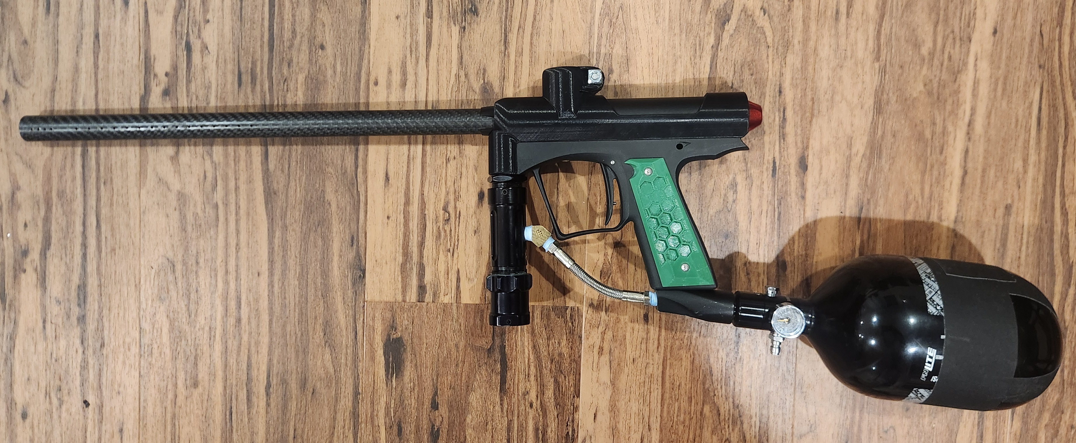

                Dye Proto Rail solenoids came in. Did the fix on the blackheart board successfully. 😃 Up to 3 runners now on this platform. One to go. There are some observations I had on the process from what was shown in the video. I will try to document them and post them as I process this next repair.

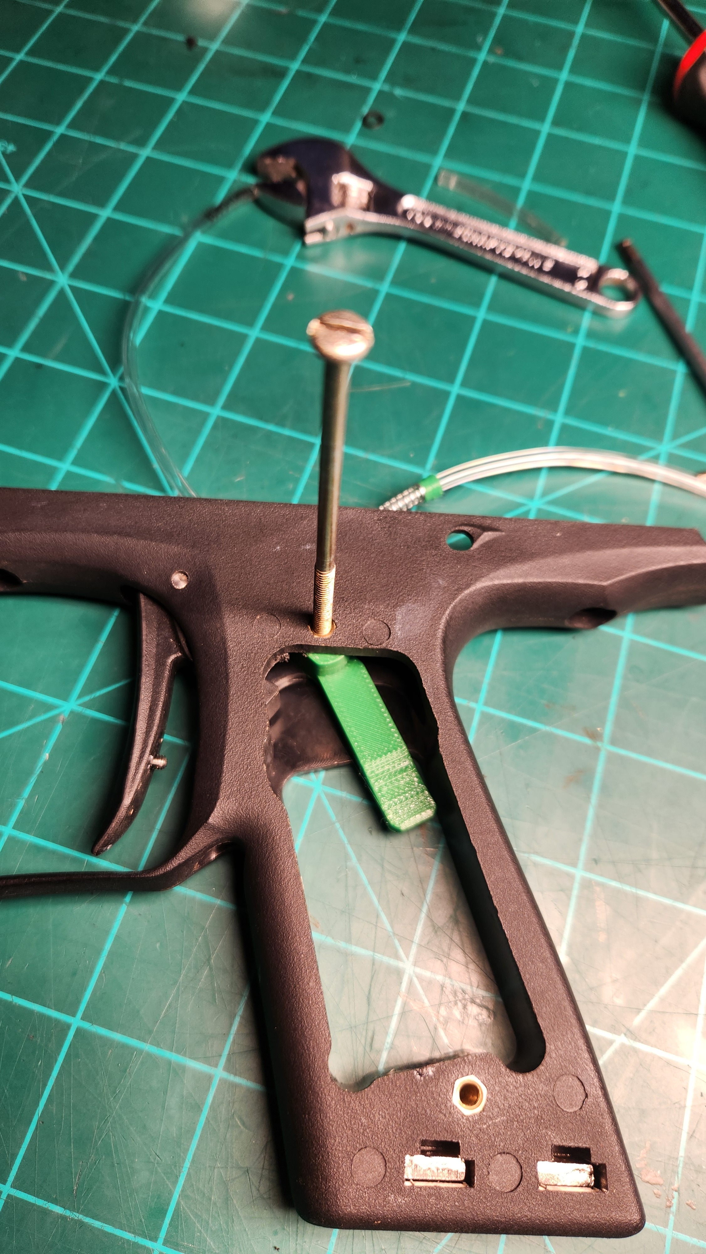

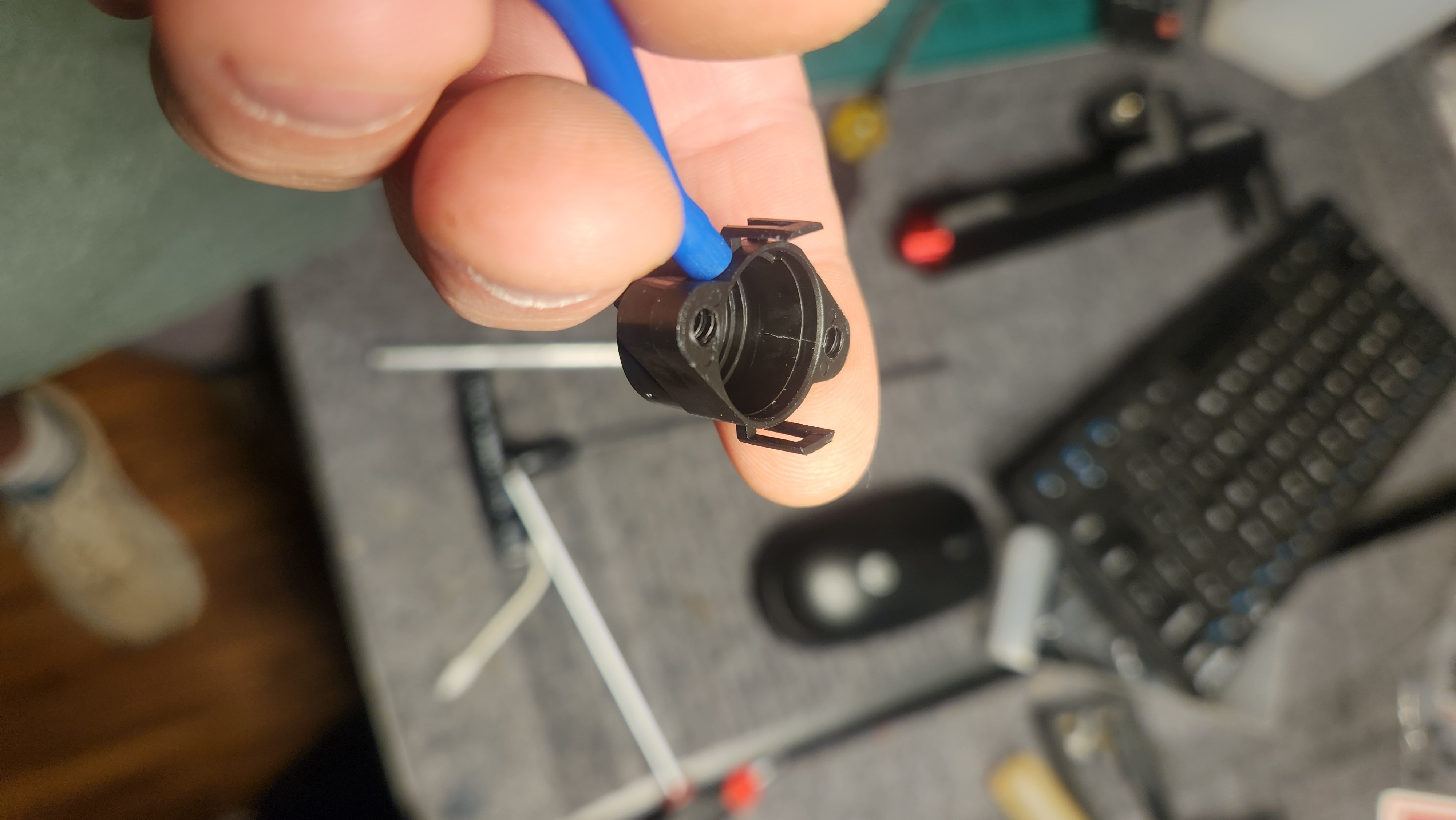

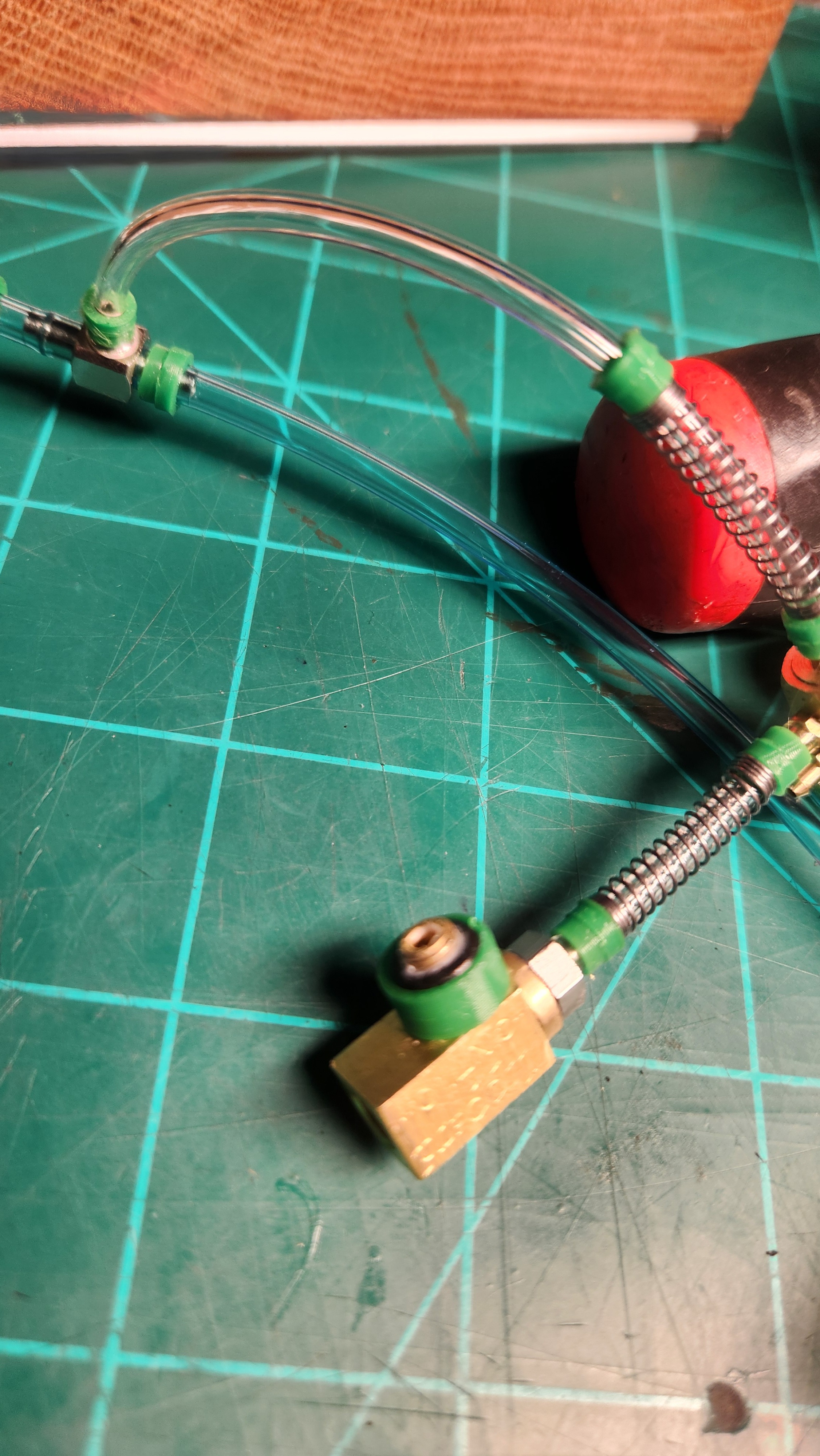

                  One of the noids just died after having been rehabbed and fully functional a day prior. This infuriated me on a cellular level, so I ordered a shitload of SMAVening bits. I finally got the last of the needed bits and went at it.
                  The assembly of the components was pretty easy. Aired up fine on the bench dissembled. Tried to assemble it and realized the from MEV-2 would require some meat removal from the frame.
                  After mauling it sufficiently with the dremel, I could assemble it. Now it was not firing due to bent hose choking off the flow from the SMAV end output. After some play with reductions in the hose lengths to and from the SMAV, I settled on this, which made it happy.

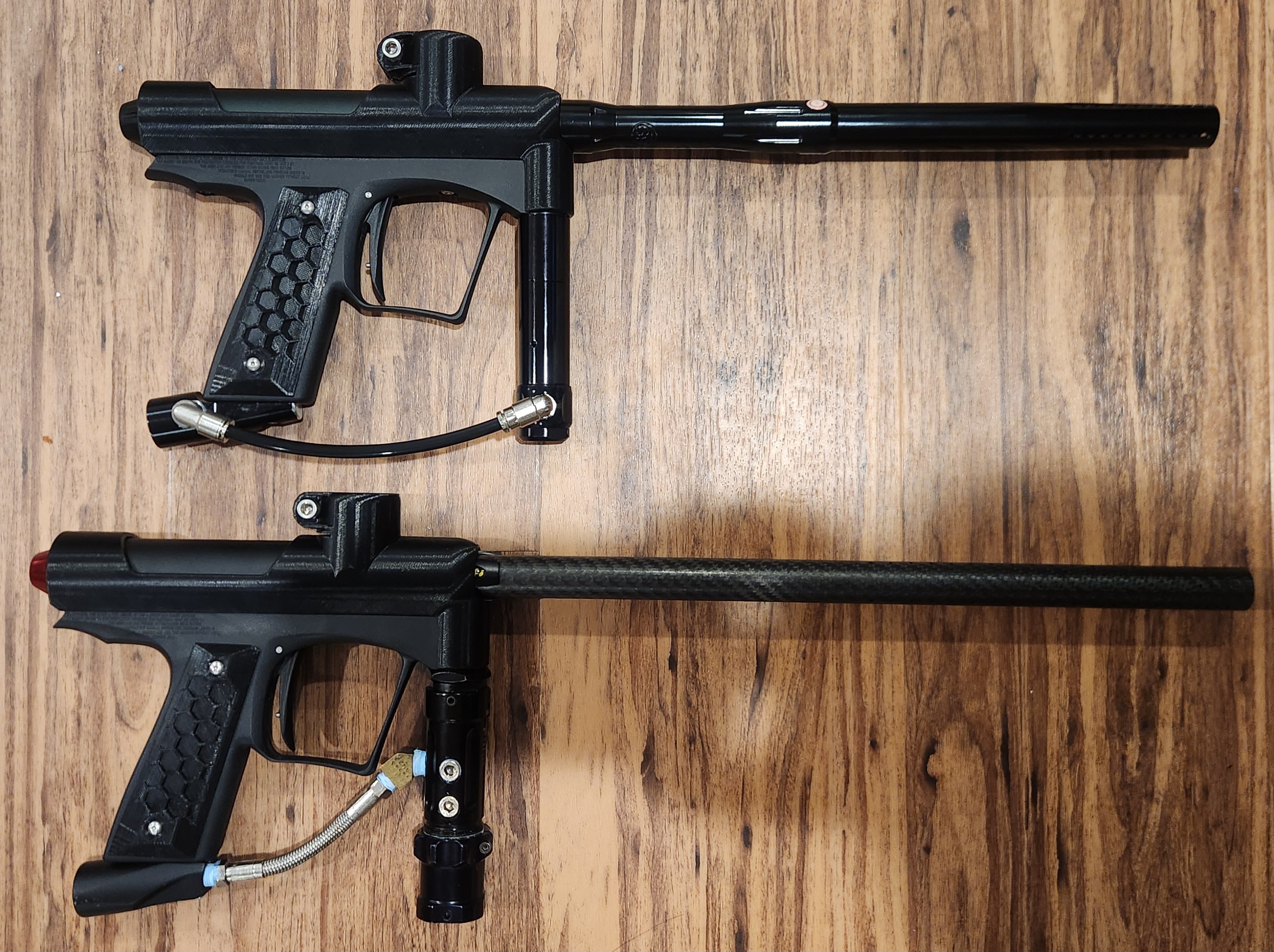

                  Gun chronoed right up. I know there are some differences between the Enmey and Envy drivetrains. Not sure how much those matter, but the SMAVed Envy was shooting very consistently on the chrony. The SMAV is also a much better feeling valve triggerwise on this double trigger frame. I am able to shoot much more quickly. Overall, I'm pretty pleased. Two more conversions remain. I may try a Sidewinder on one of them to see if it is more consistent than the Max Flo.

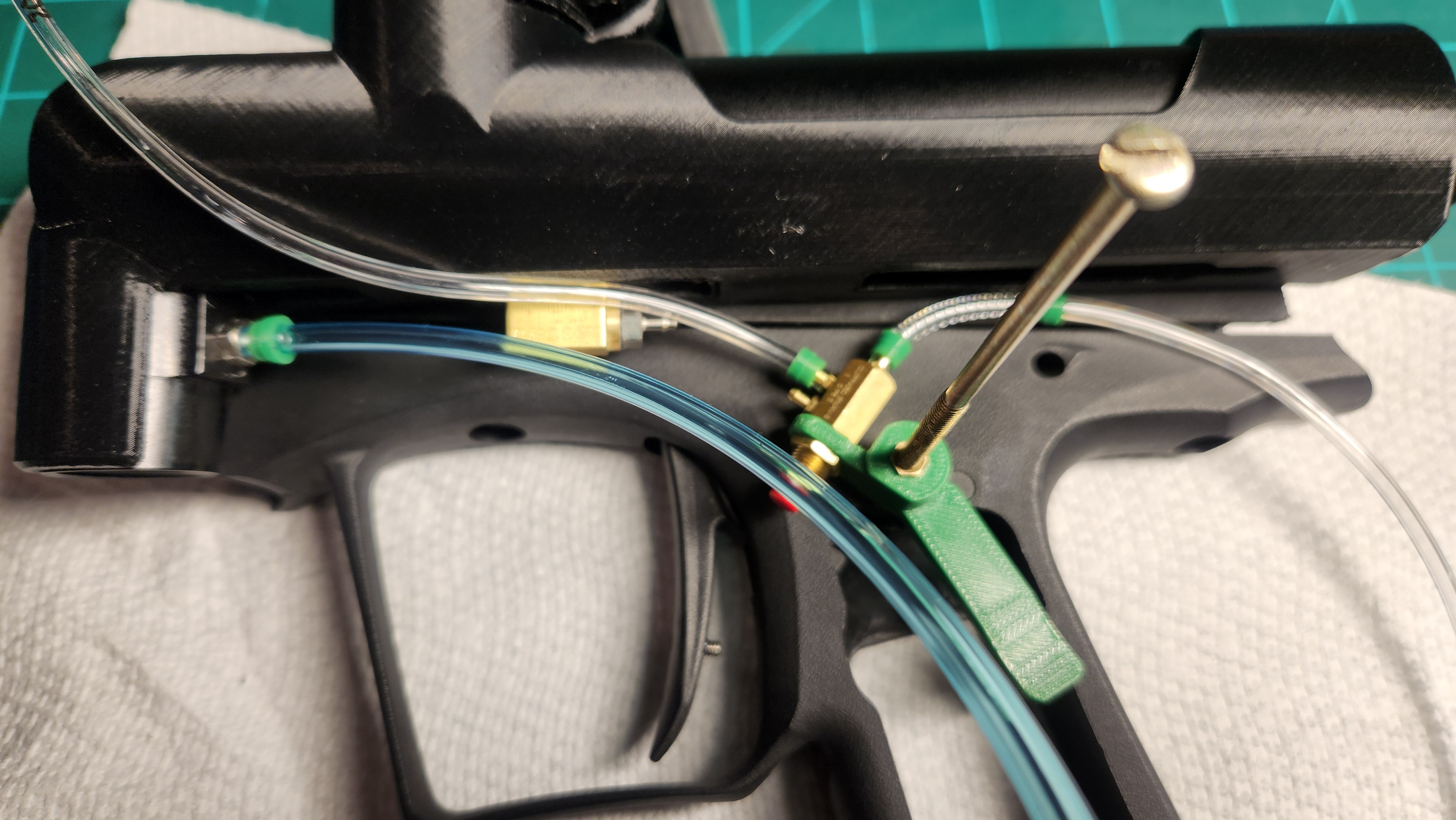

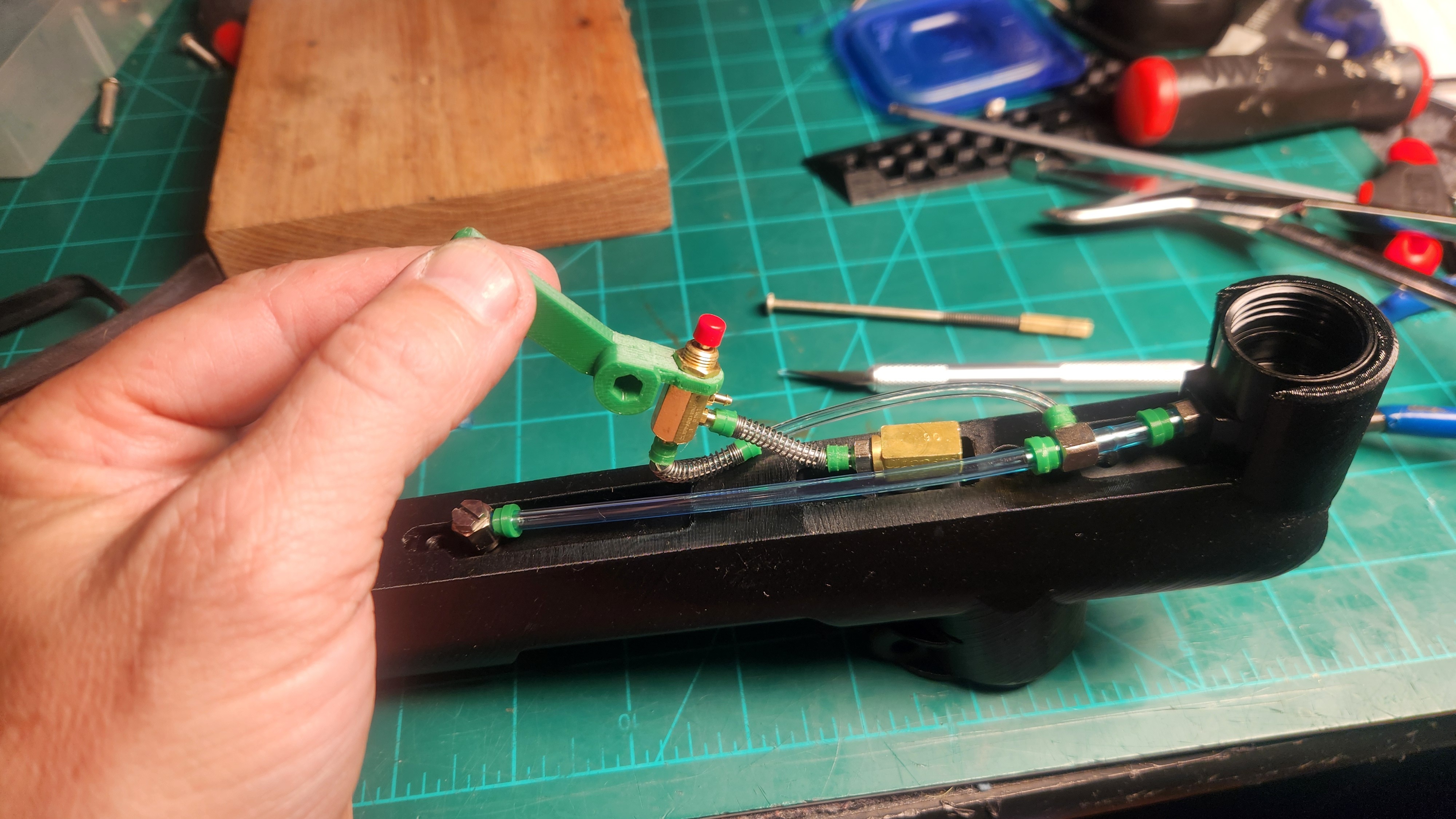

                    Two up. Its very tricksy to get the hoses to just the right lengths so the setup folds into the frame without kinking. The second setup was cycling, but I could tell the bolt reset was slow. I removed the frame screws, massaged the hoses, said prayers to the Omnisiah, and buttoned it back up. Cycled like a dream when aired up again.
                    I already loved the Enmey platform after 4 field days of using it. The feel of the SMAV on this trigger is so good that I am hopeful that this will be the new hotness for me.
                    Click image for larger version  Name:	20260522_214228.jpg Views:	0 Size:	1.84 MB ID:	839813

                  • Calvin
                    Old n' Quick
                    • Sep 2025
                    • 474
                    This is the way.

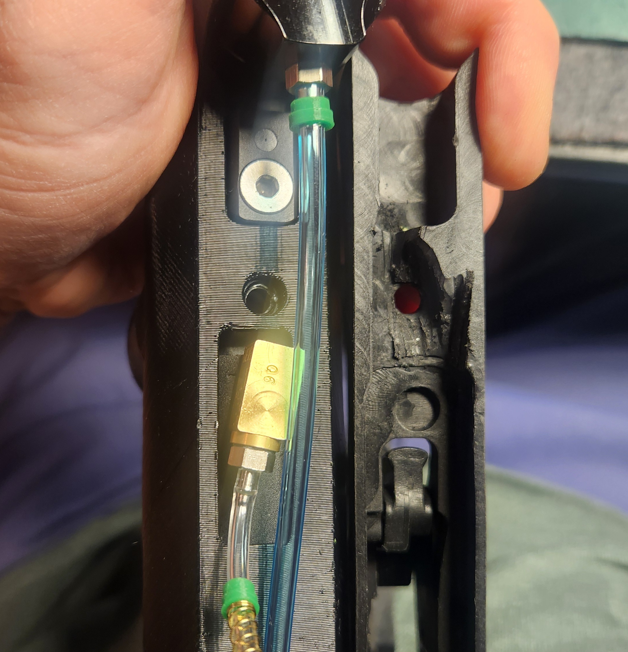

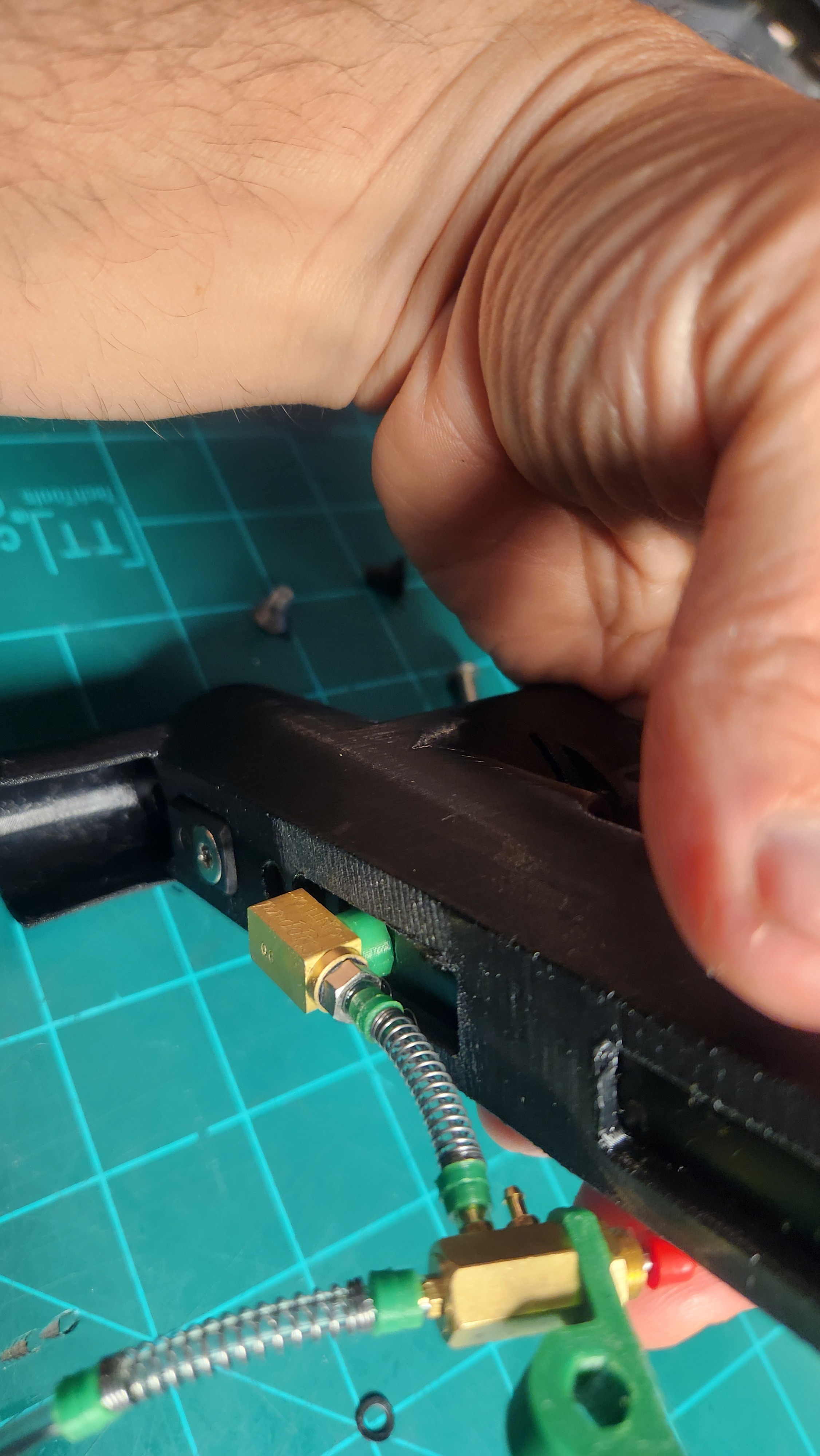

                      • Calvin
                        Old n' Quick
                        • Sep 2025
                        • 474

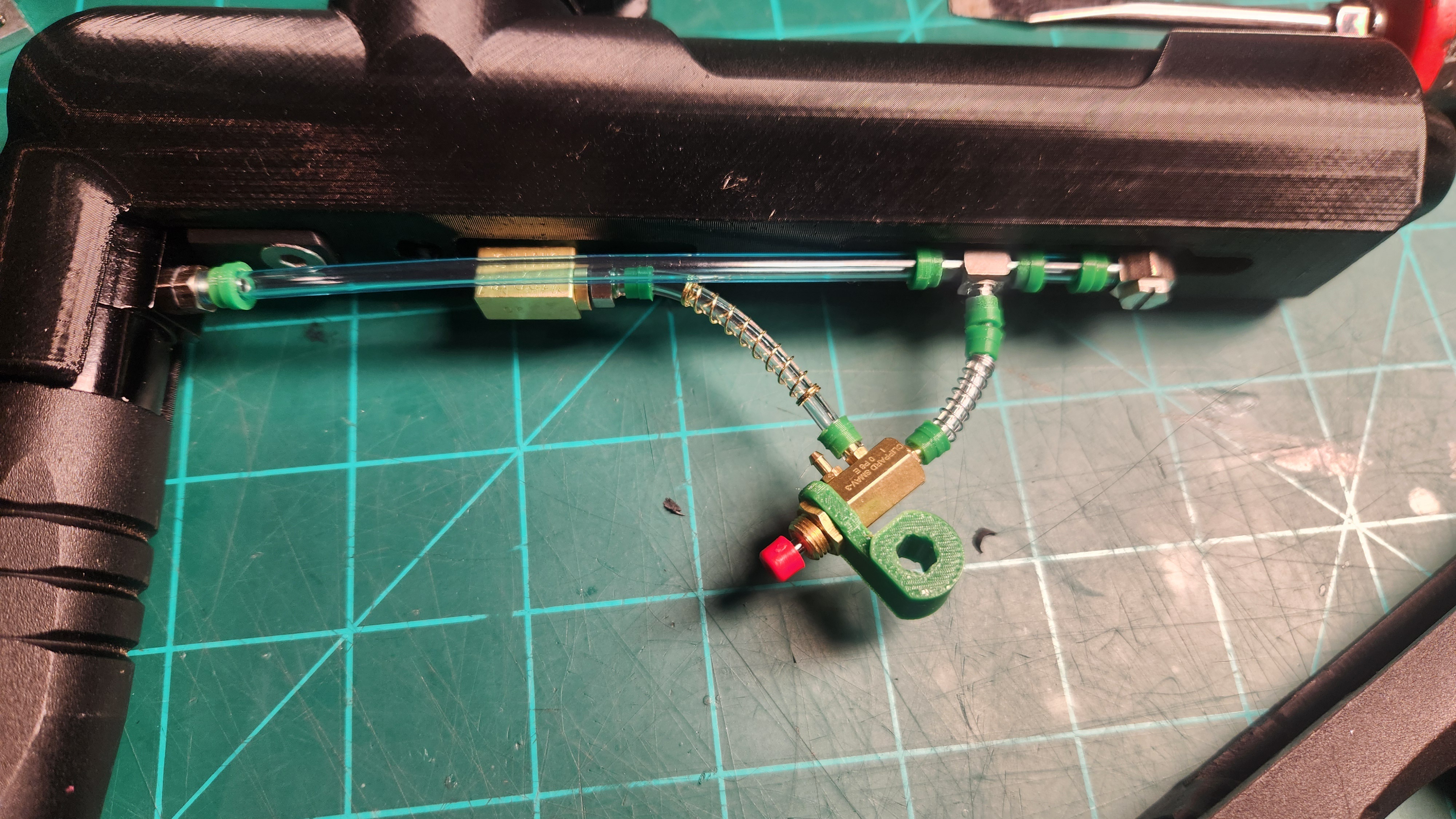

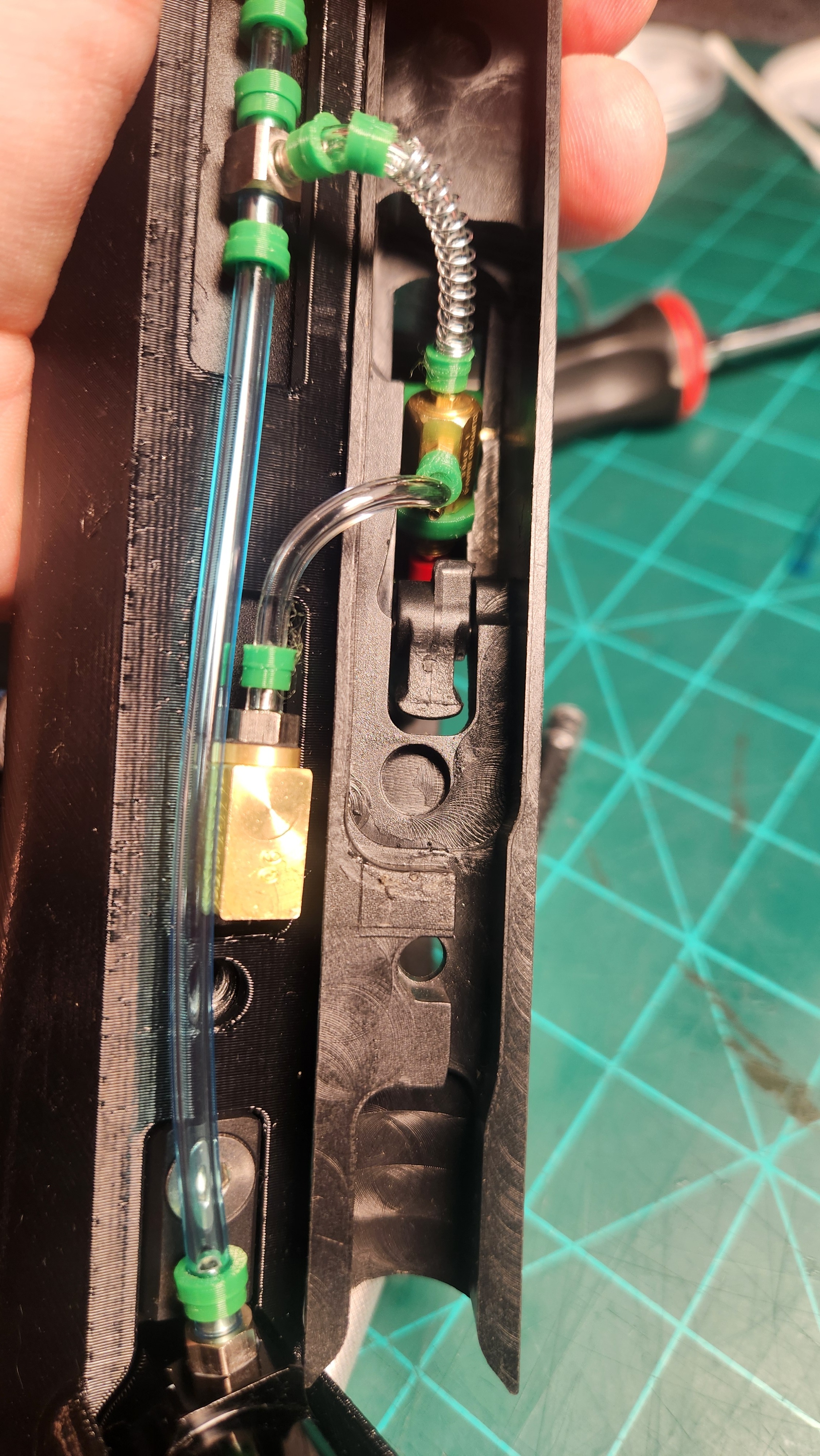

                        I wrestled the bear for a couple hours till I figured it out. The key is to put the tee up front, right at the ASA.
                        Click image for larger version  Name:	20260523_214853.jpg Views:	0 Size:	1.34 MB ID:	840055
                        You can place the tee sideways, and that gives the hose from the SMAV enough room to do a gentle S bend. I placed the spring at the SMAV just to be sure, but its probably not needed.
                        Be sure to clean out the front area of the frame to have enough space for the two hoses to pass the MEV-2.
                        Click image for larger version  Name:	20260523_215357.jpg Views:	0 Size:	1.36 MB ID:	840057
                        Speaking of the MEV-2....it's a pain in the ass. The flat seal included gives about 30 degrees of sealing direction, and doesnt seal particularly reliably if the edges of the hole have any wear. I used orings, which worked sometimes, but sometimes squished out the oring to get the required direction. I ended up printing a cuff to go over the oring to give it similar function to the captured oring in the stock fitting. That gave me about 270 degrees of good seal and let me hit the right direction with a good tight seal.
                        Click image for larger version  Name:	20260523_221150.jpg Views:	0 Size:	1.63 MB ID:	840056
                        Click image for larger version  Name:	20260523_221343.jpg Views:	0 Size:	1.18 MB ID:	840058
                        The fight wore me out. Gonna wait till tomorrow to go at retrofitting the first two I did. At least I know what will work now.
