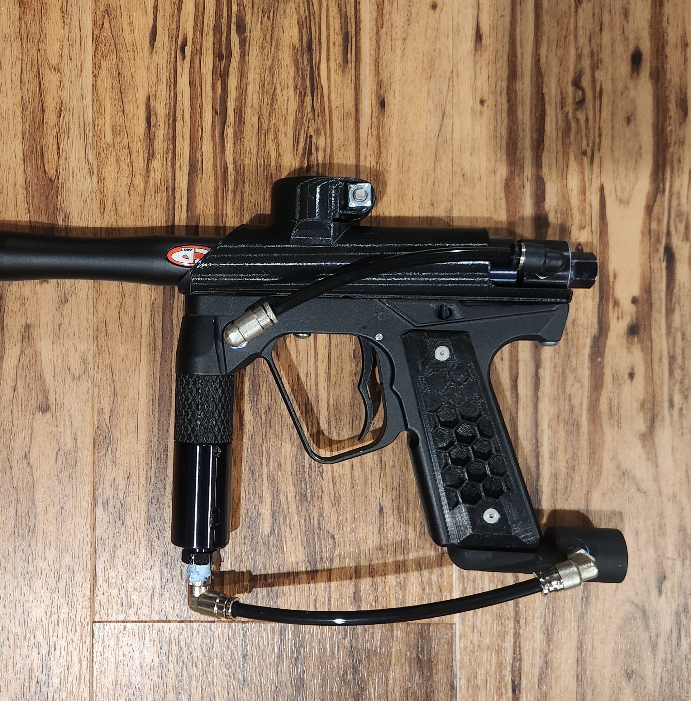

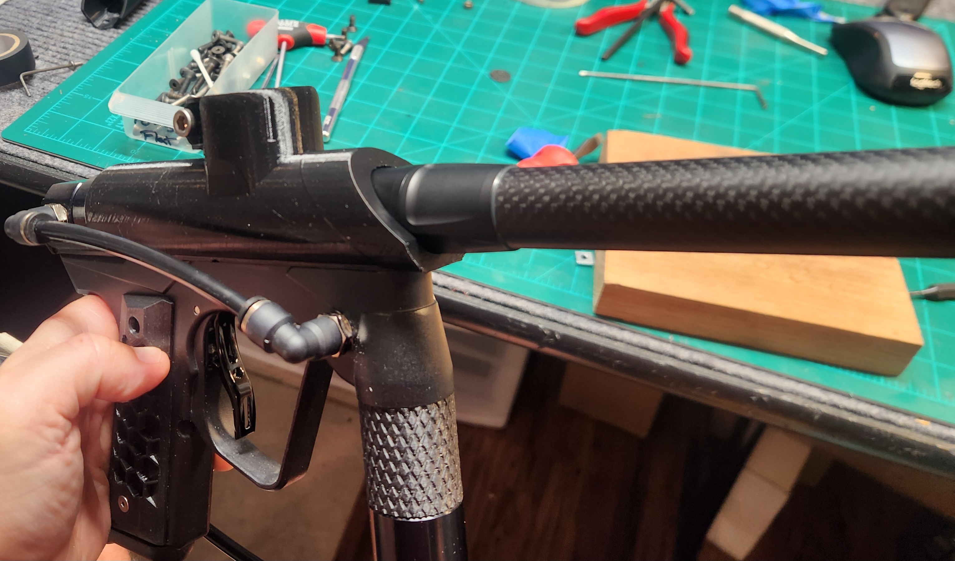

    After I got my Enmey/Vibe/Envy mechs working perfectly, I decided to move into original Ion bodies. While they have worked reasonably well, they have been giving me various issues that I don't get from my later body styles. I have been working through these problems, and I have finally gotten the build to the point where I think it should be.

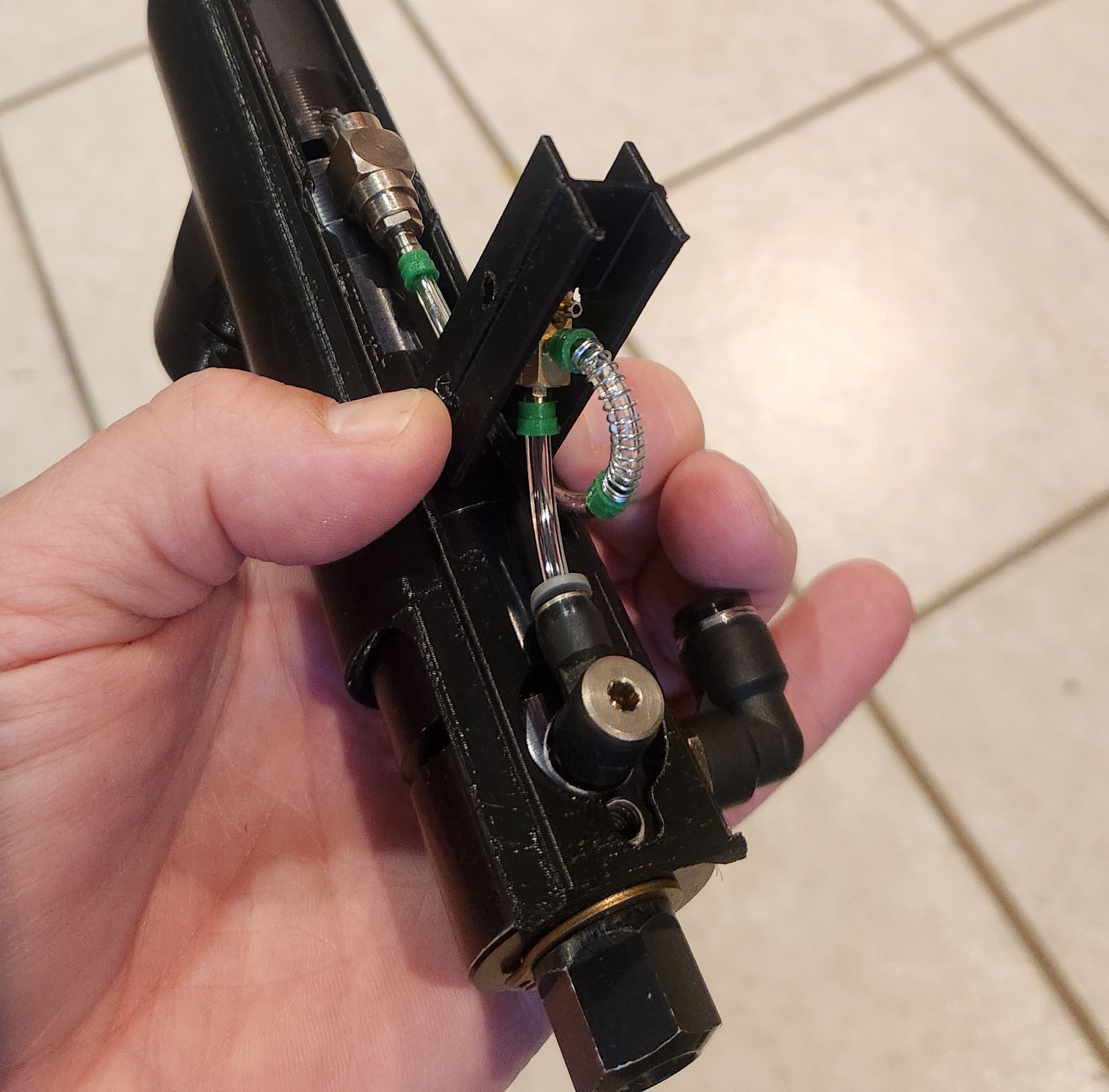

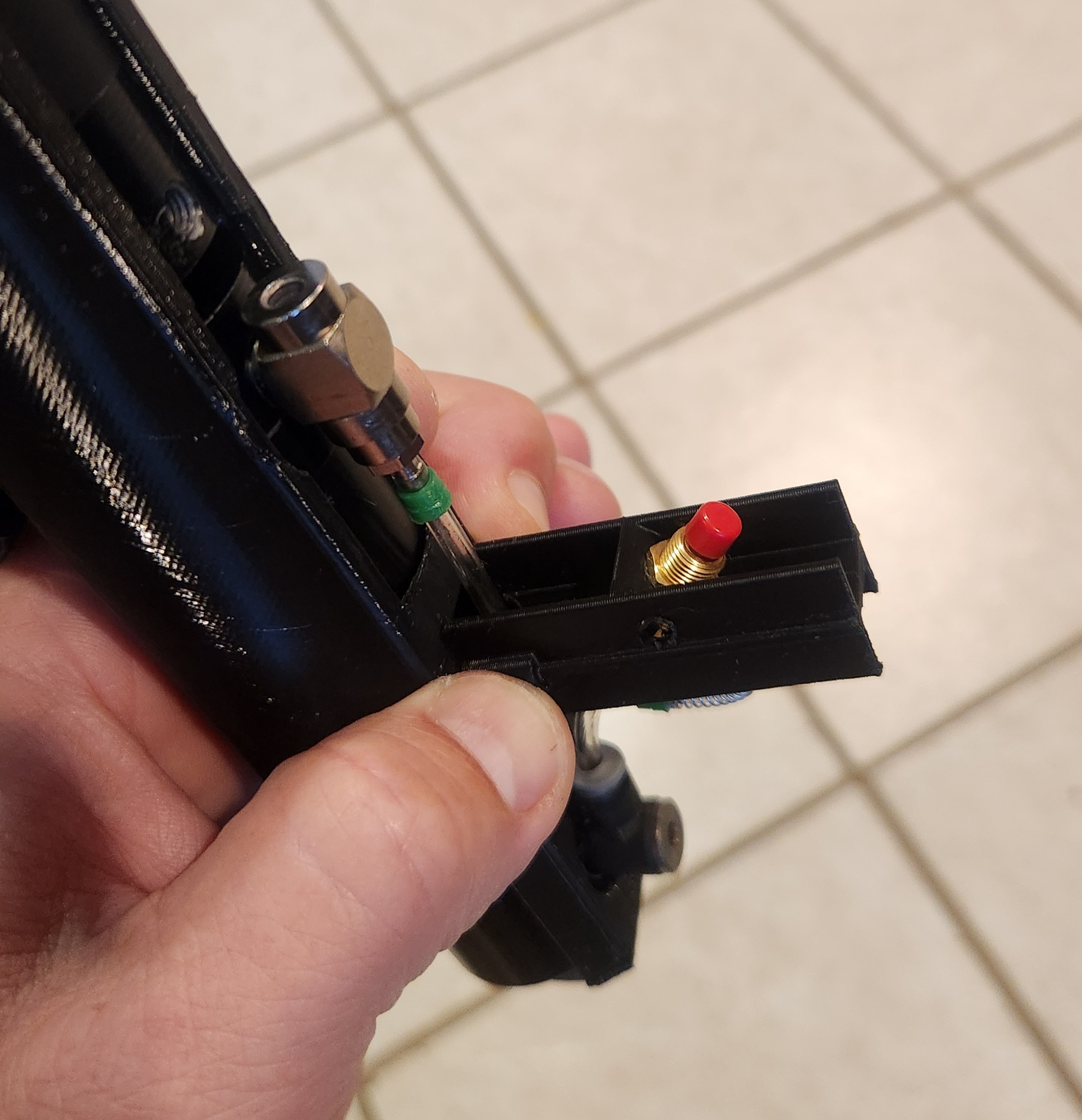

    Air Flow:
    The Ion grip frame doesn't have the space that the later plastic frames have inside for air lines. I had been doing various small lines down the right for the rear chamber while routing air from the front air entrance in the frame back to the valve and then to the front chamber. I removed the guage, and made a macroline run down the left side, which should be less finicky than the 5/32 hard lines were. That allowed me to use the bottom of the donut to route air to the SMAV inlet, and then out to the QEV at the front. This makes kinks a non issue, and also makes breakdown of the gun a snap. Remove the two top grip screws, which go into holes in the SMAV mount, and the two halves can pull apart without issue.

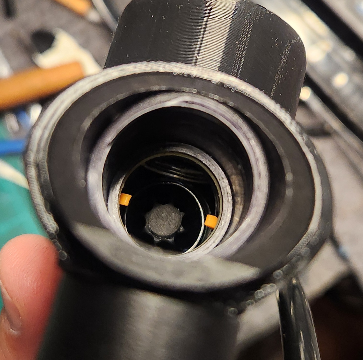

    Bolt Issues:
    I had been using Shocktech Superfly bolts for these two builds thinking that they would be better. I had a couple breaks out of 1500 or so balls, and noticed that the ball rollback was greater than my stock Vibe/Envy/Enmey bolts allowed. I got some stock bolts double o-ringed and then tested them. Still, a lot of rollback. I made a round foamie out of 5mm foam sheet using a hole punch and CAed it into the front of a stock bolt. This placed the balls into the chamber perfectly with zero rollback and just enough room to enter the chamber without resistance from either the foamie or the detents.
    I just ran 3 hoppers full of 3 month old craptastic paint as fast as I could pull the trigger. Had no issues and accuracy was good. I am hopeful that these Ion bodied builds are now equal to their later brothers. Can't get to the field for a few weeks, but I am excited to stress them a bit and see how they do.

        Finally got a chance to get up to the field today. Only had time for 4 games, and used this one for two of them. The changes proved to be spot on. I shot approximately 900 rounds through it. Zero issues or ball breaks. The gun was everything I had hoped it would be. No shoot down whatsoever while shooting quite quickly. Straight up gud fights with electros are completely doable with these things. It also threw a fantastic ball. I have been using a 68/4500 800psi tank with them. I think I am going to get a 60/4500 Bunkerkings tank with a 450psi output reg for use exclusively with these Vibe/Envy/Ion mechs. Post-game inspection revealed no damage to the foamie whatsoever. I also didn't feel that going back to the stock bolt had any negative effect whatsoever vs the Shocktech Superfly bolt I had been using. Very excited to have these Ion body mechs working up to my expectations in game.
        I'm beginning to think that the old thoughts on low pressure markers being kinder to paint are bullshit. I think good detents and the geometry of the ball positioning in the breech are the real factors involved in good paint handling.

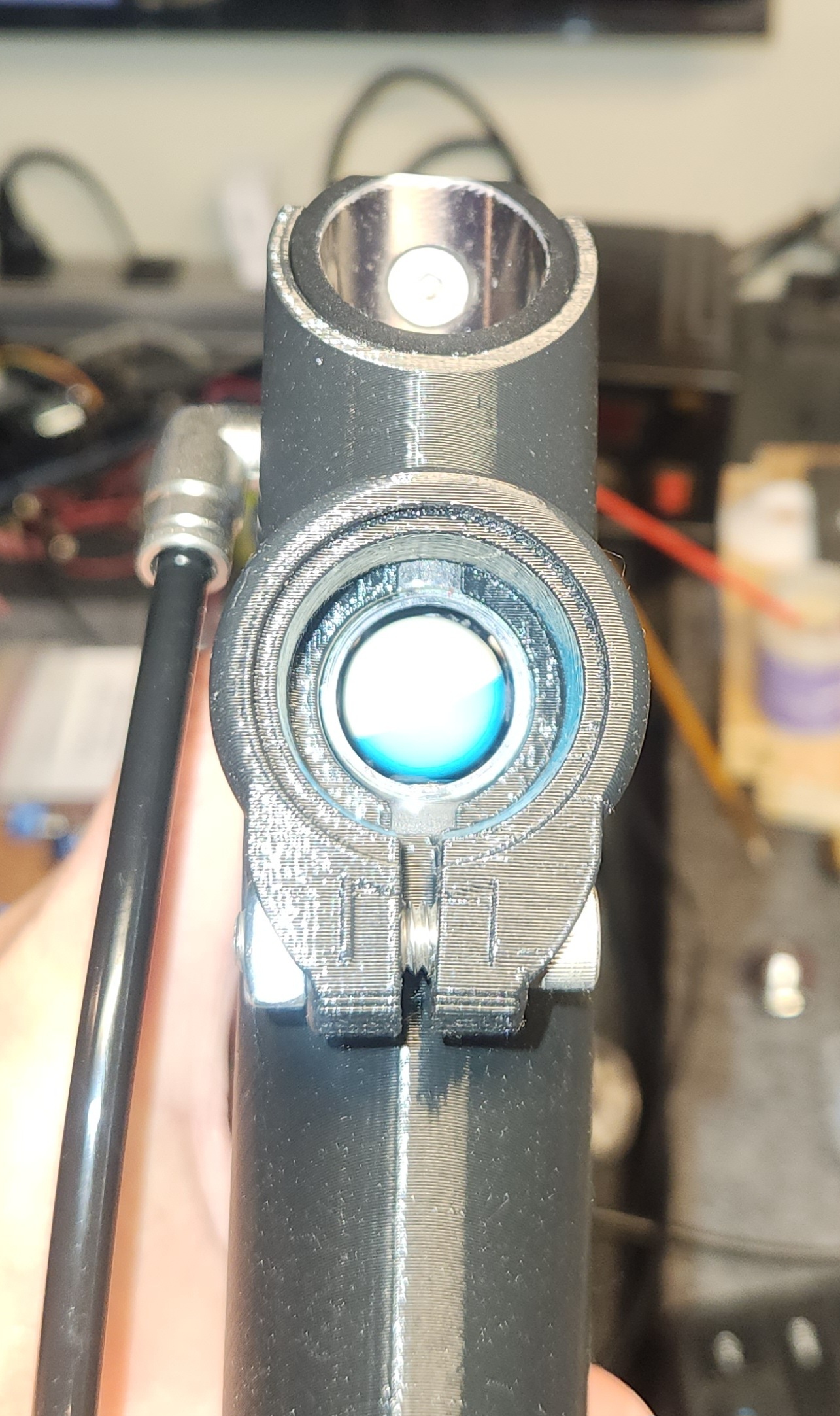

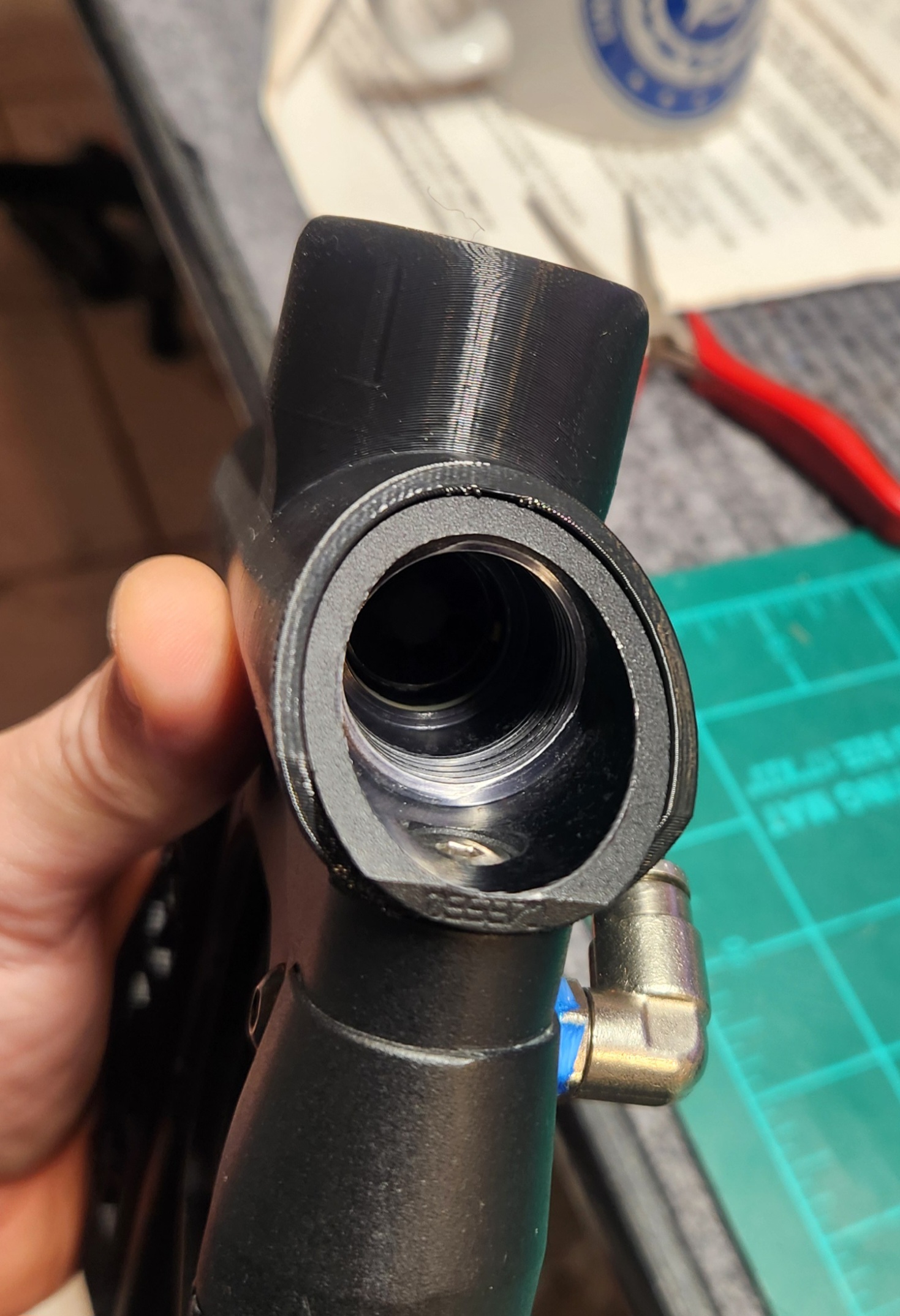

            • 474

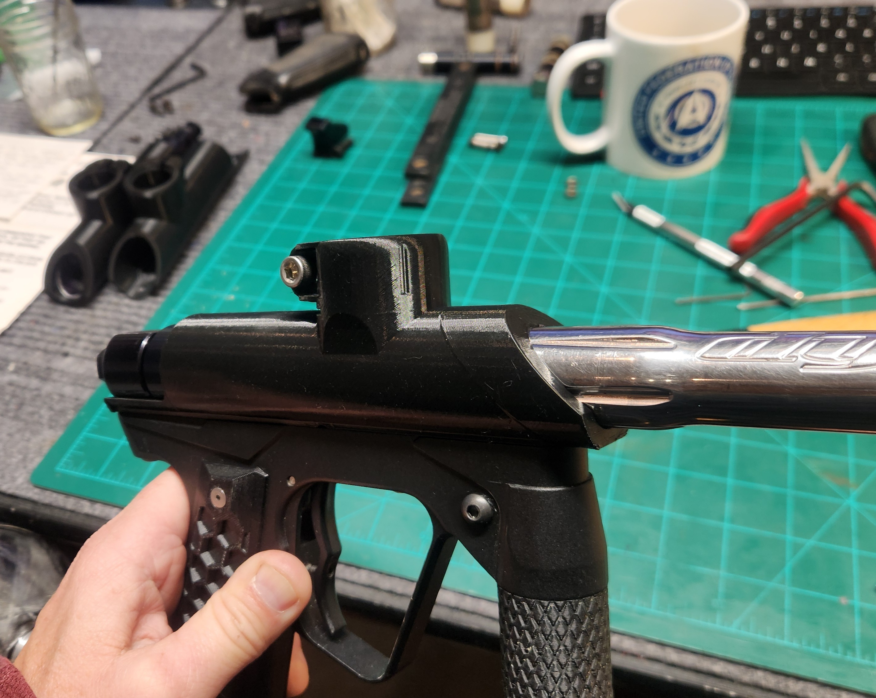

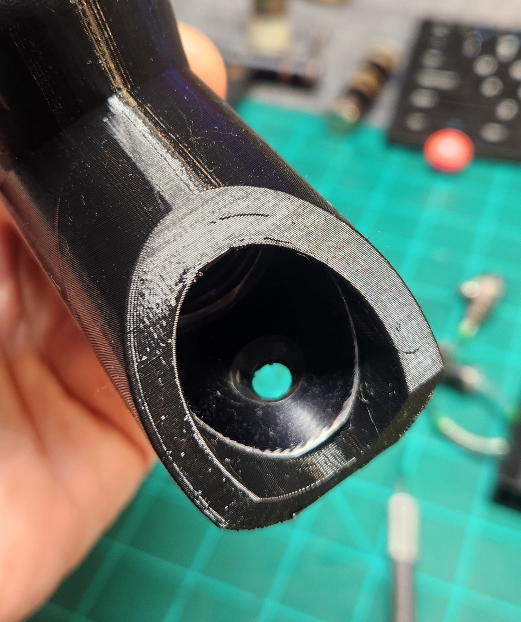

            I have a couple more game days in on the meched Ions. Should be well past 10k on balls shot through these now. They have been perfectly reliable with only one issue caused by a design flaw. When I built the body, I made it flush with the front of the inner body. I have been hit twice in this area right above the barrel causing some paint to force its way under pressure into the feed opening on the inner body. This has led to predictably adverse situations.
            I redesigned the body with a lip on the front to extend past and over that seam. As a bonus, it makes aligning the inner and outer bodies on assembly much much easier, as the rounded lower lip of the inner body enforces proper alignment. I'm pretty sure this change will render these as close to bulletproof as required.
