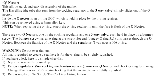

            Necro thread, but this popped up when i was looking at new sterlings. Not sure if it matters but:
            http://www.arrow-precision.com/Arrow...ign_manual.pdf
            http://www.arrow-precision.com/Arrow...s_manualv1.pdf

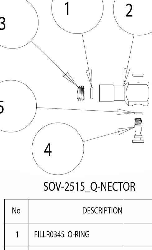

            Sovereign uses the "q-nector" also, and lists a 006 o-ring inside, hypothesis that it's the same bits.
