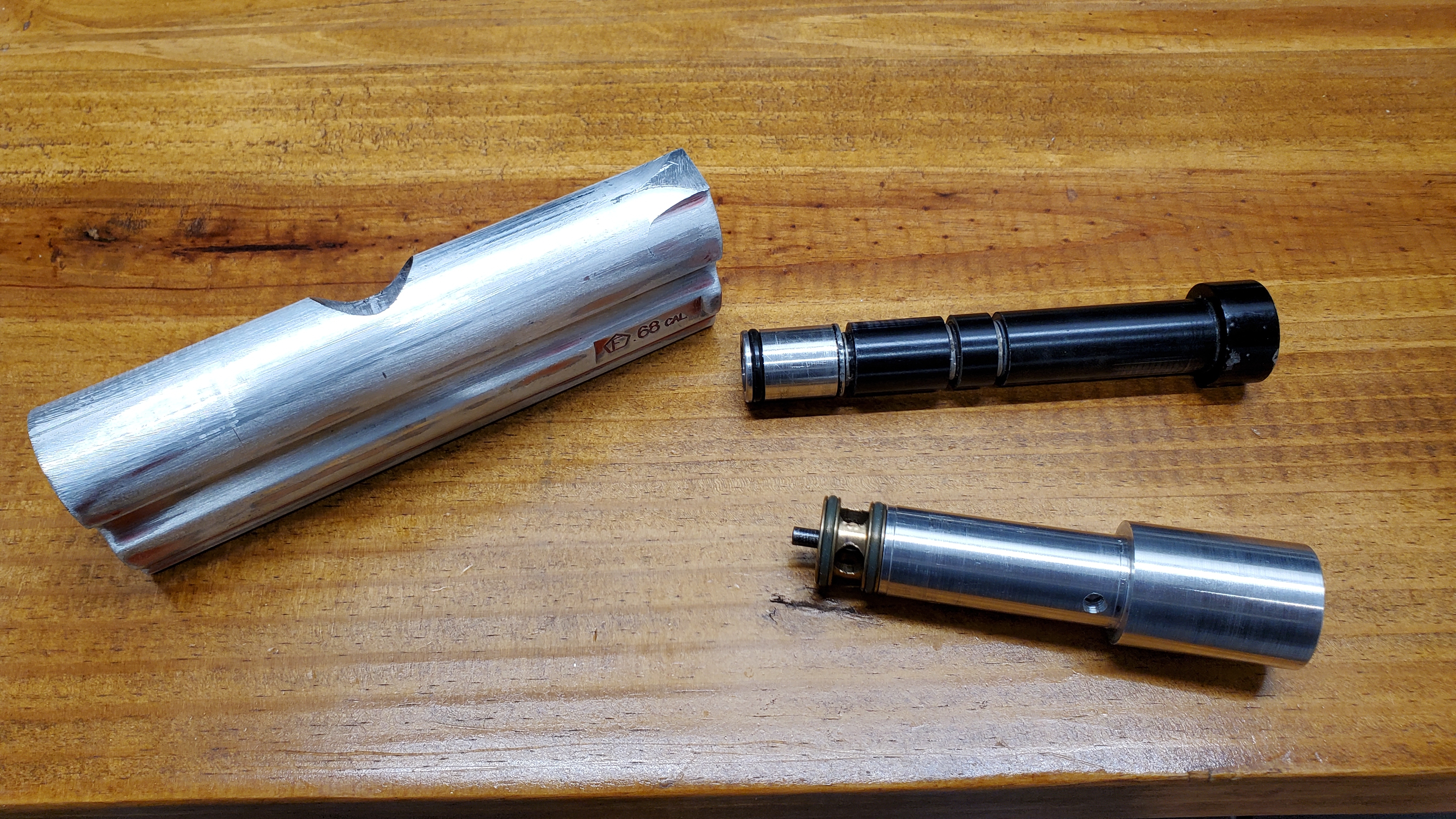

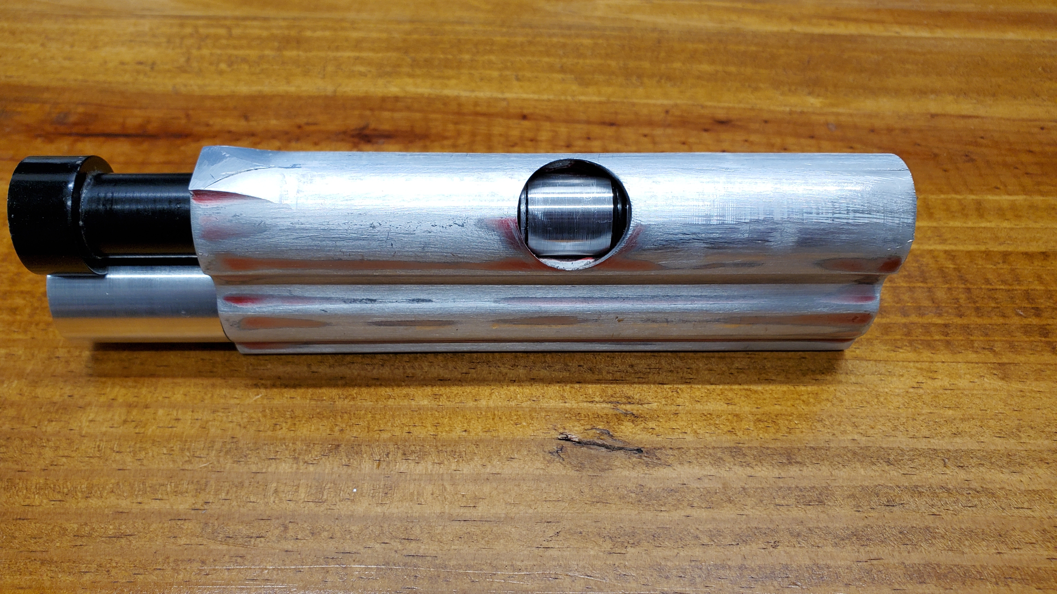

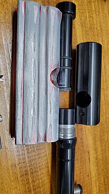

              Weekend update:
              This started as a junkyard dog, with stripped frame threads in the valve body and a gnarly paint job.
              Got a new valve body made, then extended the bolt. Didn't feel like making a new one from scratch - the back half with the scallop for the valve looked tricky - so I just made an extended nose that pressed in. By keeping the ID of the nose a bit smaller (I mean, really... the valve port is 1/4", but the bolt is 7/16"?) I'm able to keep it smooth the whole way, and hopefully see a slight efficiency boost. Gotta control the pace of expansion...
              Next is plugging the old feedneck, then drilling and reaming the top bore to trim the plug, and drilling for a CCI block. I'm a bit worried I didn't leave enough meat up top for the block. Might just have to mount it backwards.
