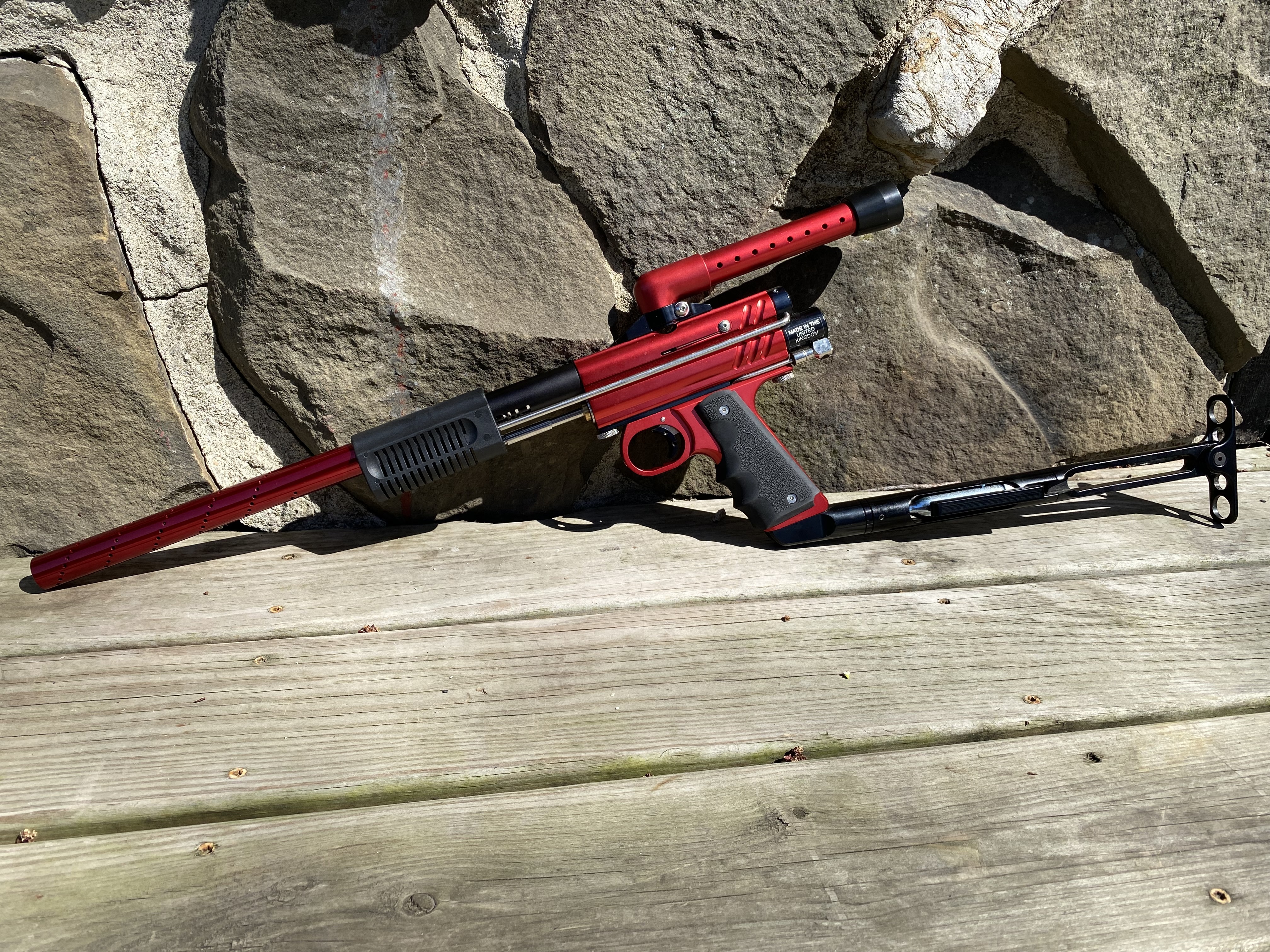

                        I’m running a Spyder freak back and an All A’s spiral ported front and my SC STP is shooting money. 0 issues with this setup,
                          • 6282
                          #27
                          I did need to swap to the CO2 springs for 12g play. I tried having Lee Spring make me some but they weren’t as effective as the ones specifically designed for the Sterling. I didn’t realize they didn’t come with the proper springs to use 12g. But after getting the right spring in it, it shoots great. I haven’t noticed any real issues with the breach design. It’s not hard on paint at all and gets a decent shot count. I do like the longer barrel over the stock. The stock one is so short it makes aiming it hard. I use the barrel tip for reference when aiming with the stock barrel it’s hidden by the handle while behind the marker. The longer tip gives me a much better perspective making it much easier to point.
