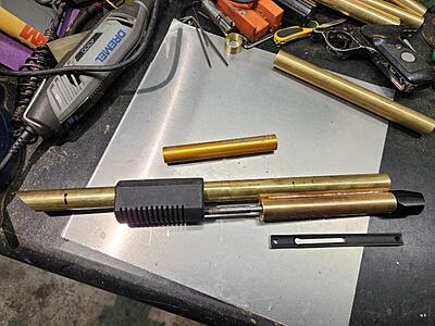

    This is the starting point. I have to figure out if I'm missing parts first. I'm going to re do the barrel with Freak inserts and a detent. More coming eventually, personal projects are always last on my list.

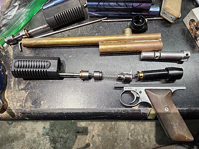

          So this is definitely a first for me with Sterlings. I think I have enough parts to make this work, except one: the velocity adjuster piece? This is the first time I've seen a sterling this close, and I didn't get to take it apart.

            Older Sterlings didn’t have the hole drilled in the pump/drive rod to allow for velocity adjustment so I wouldn’t sweat having it or not.. most people prefer an adjustable bolt over the factory method

            I have the hollow pump rod though

              Yeah that hole, is the transfer port. Whoever created this didn't use a transfer tube. This is another reason why I'm making a new barrel.

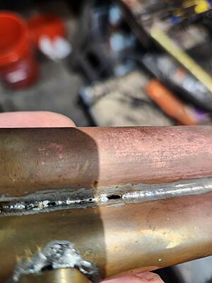

                I have the body soldered up. Now I just need to decide if I want center feed, or left.
                I also don't like the stock trigger frame, I might do something a little weird. I'm hoping to have this ready to test by Saturday, so we will see what happens.

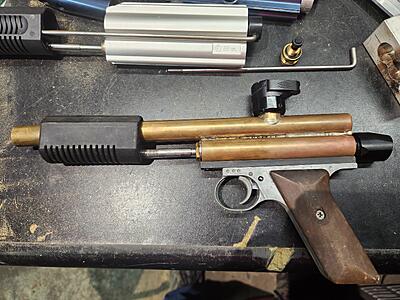

                  You can mod a cocker frame to take a Sterling sear release… the dimensions are extremely similar.

                    Yeah I noticed the Sheridan kind of lines up, and wouldn't take much to make it work besides modding the sear.

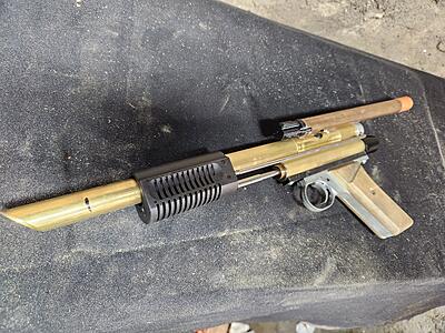

                  So I did cobble it together enough to test fire. It seems to be working, but if I pump it too hard, the valve pops. I think it might be the hammer spring is too long, as it's just a cut down Spyder spring I got with the pile of parts. It's likely binding up and just pushing on the valve stem. I'll experiment with some other springs I have, to see if I can get rid of the pop. It shot 240's with an extreme overbore, as a .690 was the closest insert on hand when I did this. I think I'm going to make some sort of velocity adjuster for it.
                  Also the stock trigger pull is dreadful. I don't like it one bit and it is definitely getting replaced.

                    I went with the left feed. I put a red spring in the valve, and a 12 gram, and it was hovering around 280fps. Now it just needs the finish work.

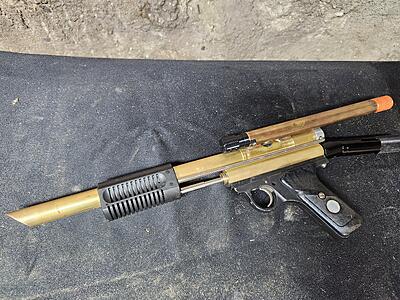

                      This is good enough for now. Just need some rubber PMI grips

                        There was quite a bit of fiddling and I had to re-shape the sear, but the Sheridan trigger frame seems to be working reliably now. Maybe I'll pick up a hinge frame for this build. I'm field testing it tomorrow.
