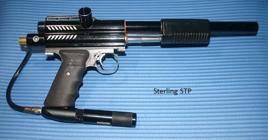

      Although the newest Sterling and the oldest Sterling are fundamentally very very similar in truth nearly every part has changed, often more than once. I think maybe the bolt is unchanged but I’m not even sure about that.
      OGs had pot metal WGP grips. They eventually made a nice composite version and then eventually a billet one. The barrels used to be their own thread but at some point changed to Spyder. There are at least two pump handles. Early guns were all right feed, modern ones are center feed and based on a different extrusion die. OGs had one hole wood grips new ones used wrap around rubber Hogue. They added a detent at some point. The valves aren’t angled for bottles anymore.
      Then there is the optional gas through grip and stock class stuff which are options that didn’t exist early on.
      If you buy an old one I wouldn’t assume it would need a rebuild. They use a very reliable seal. They are made for CO2 though and have no velocity adjustment. If you plan on playing with it and right away I recommend a new one.
      If you buy a new one I think you’re getting the best pump for the money in 2025 by some margin. It pumps very nice and is super accurate even with the stock barrel that people never seem to want to use.
      There are “mid period” Sterlings that seem to have issues with…something, I can’t remember. I can’t say I have any experience with those.
        Stock barrel is very short it has a large handle so it hard to get a good sight picture on the stock barrel from behind the marker. The longer barrel makes it point more natural.

      The biggest functional differences to me are the barrel threads and hammers.
      The oldest Sterlings had very long barrel threads, similar to a Raptor (and sometimes interchangeable) but proprietary. This allowed the bolt to put the ball right into the barrel. Newer ones have Spyder threads, but the ball sits behind the barrel. Some people don't care; I do. It's easier to get Spyder barrels but it's really almost a breech drop instead of a bore drop, if you're familiar with Nelson terminology, or like comparing a Phantom breech drop to a Carter breech drop.
      The other thing is adjustable hammers. Not sure when, but at some point right around the switch to Spyder threads, the hammer (and therefore velocity) became adjustable with a long Allen wrench through the pump handle.
      Other than that, they all feel very similar to me. And everything is visually different beyond the hammer and barrel threads. I like them all. It's hard to find old pattern barrels, though.
      I haven't tested this, but I think WGP cup seals work (very similar size) and my brand new Sterling had a cup seal fail in a year. Only reason to get a spare part, unless you get the newest had through one, where I hear the "Q-nectors" fail/ break easily.
      Oh... and they use different rail/ frame patterns. No functional difference but it's a gamble to swap parts around.

            I owned an older sterling and aside from NEEDING a custom barrel from Palmers, and the trigger being super mushy it was great. I fixed the trigger by removing some aluminum from the body. Over the years the hammer sear had smashed the metal down but it was an easy fix with a small file. My main issue was the length of pull from my tank to the grip. The original ASA on that thing was one nautical mile long. I ended up selling it for around 450 or so.
            I've never owned a new sterling, but that might be the way to go. Centerfeed and spyder barrels AND detents. You'd feel spoiled.

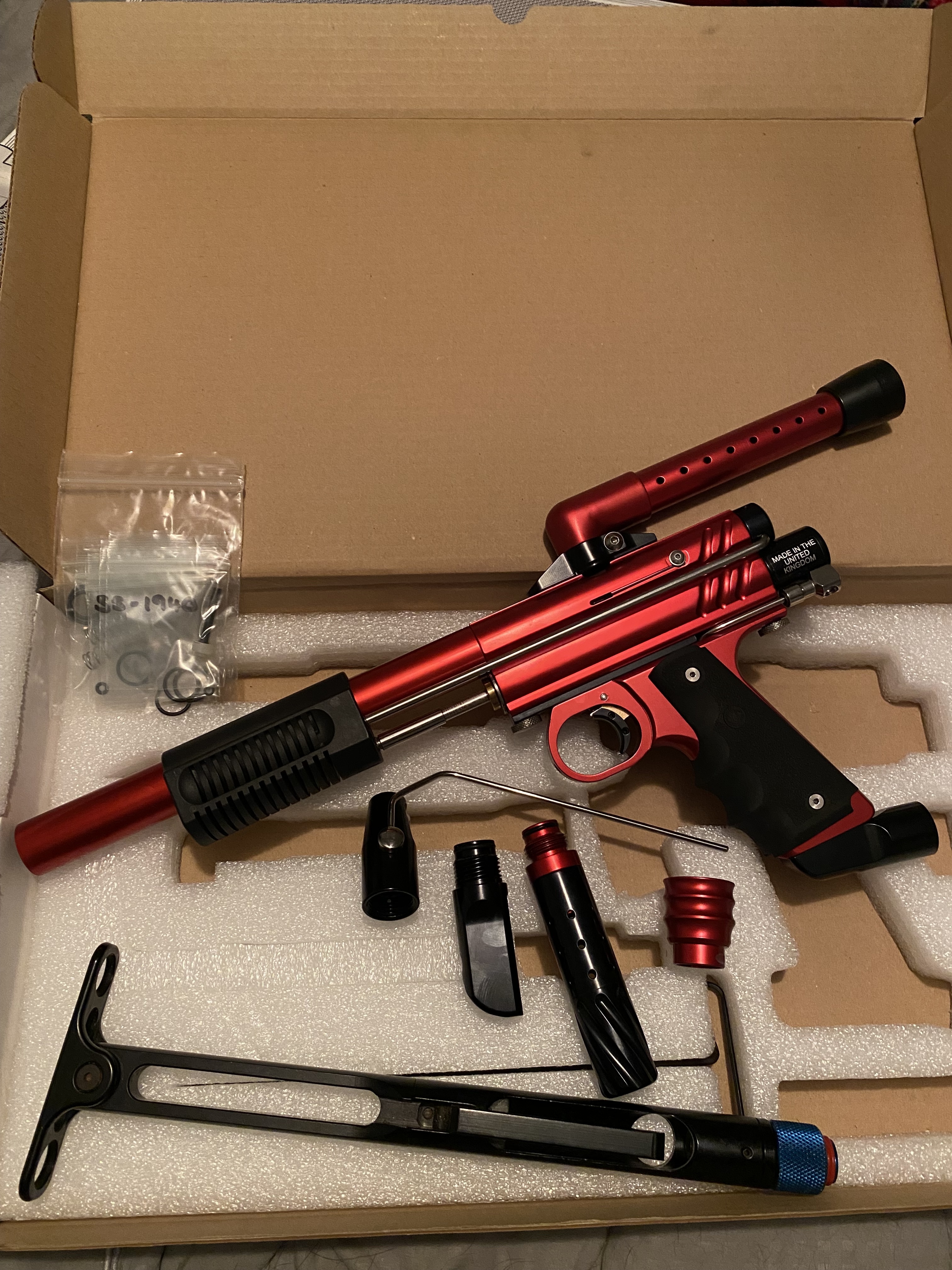

              I much prefer the newer Spyder threaded ones. I never had a an issue with how the ball sits in the breach mine shoots fantastic. It dose require different springs for CO2 but after swapping them out for the CO2 springs it works fine on Higher pressure HPA systems as well. (800psi tank input pressure) I still get 280fps out of mine on HPA with the CO2 springs.
              If you don’t care about being center feed as long as you find an older one with a small bore barrel (.681 ish) you will be happy. I wanted a center feed with all the stock class mods so I went new. The exchange rates pretty good so it helps eat at the fees. But double check to see if there are new tariffs on the imports now. Back when I got mine there wasn’t.
              They are approx $560 USD + about $30 to ship another $10 if you want the stock barrel freak bored. There might be terrif on that as well. That you would need to check on.
              But you should be into a new one shipped for about $600 looks like all the colors are available Blue black pink purple gold silver green.
              *Oh make sure you get the Co2 springs from them if you order new they are cheap to get and you will need them to run 12g on the setup. My SC sterling did not come with the co2 spring setup. I found that out the hard way.
              I know Hellions Sterling is well sorted so that will be ready to go and you won’t need to worry about extra fees of ordering overseas if you want to go used.
              https://paintballshop.com/sterling-stock-class-gold/
