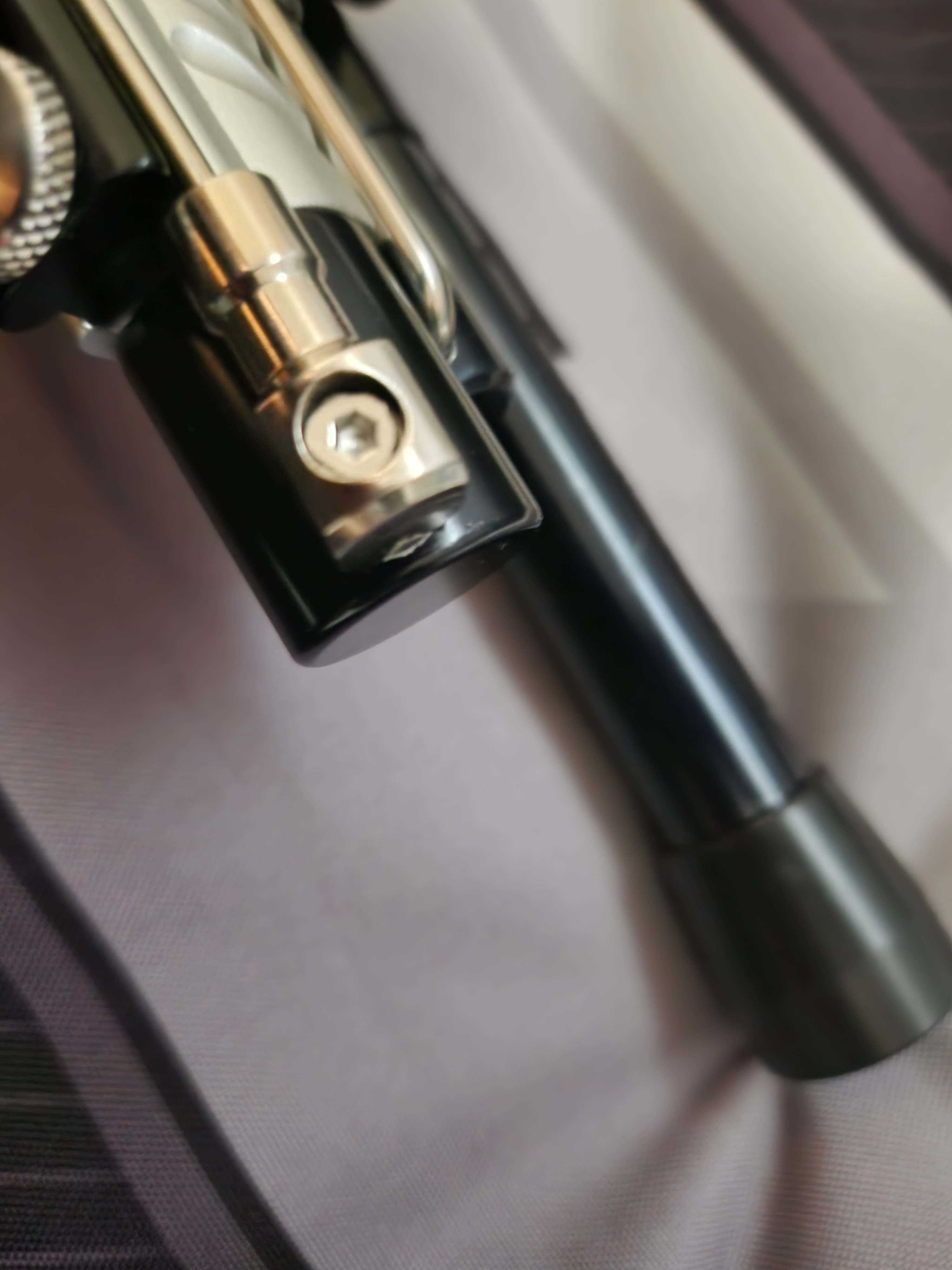

    Sterling stockclass
    At a recent event by mistake somehow the ( SDV-2560- BUNGEY SCREW ) was broken from my valve when someone was looking at my marker can anyone help with a replacement screw or possibly another stp valve ?

    That screw is so thin that it's a miracle that they all aren't broken. I'll look to see if I have a spare later tonight when I get home.
        Thank you very much. I am trying to look for any options to repair it I was also wondering if I could install the stp valve in emergency's if such a thing where to ever happen again ?
            Yes you can use a STP valve if you have one.
            I think I'm going to have my valve drilled and tapped for 1/8 npt and use a regular ASA so I don't have to deal with the air through fitting.

              Originally posted by SignOfZeta
              I’m confused as to what happened here…someone was looking at a screw and that caused it to break?
              I'd put money of the fitting was leaking and someone tried to fix it. If you put any torque on the banjo screw it will break because of how thin it is.

                • LittleSnail
                  • Jul 2025
                  • 27
                  Good news I fabricated my own Bungy screw. seems to be holding air we will see at my next event.Thank you everyone for helping out.
                    • 6380
                    Looks good nice job!
                    • LittleSnail
                      LittleSnail commented
                      Thank you. I am just glad to have the marker repaired it's a great pump. Just need to find some up to date Stock-Class gear for holding tubs.
