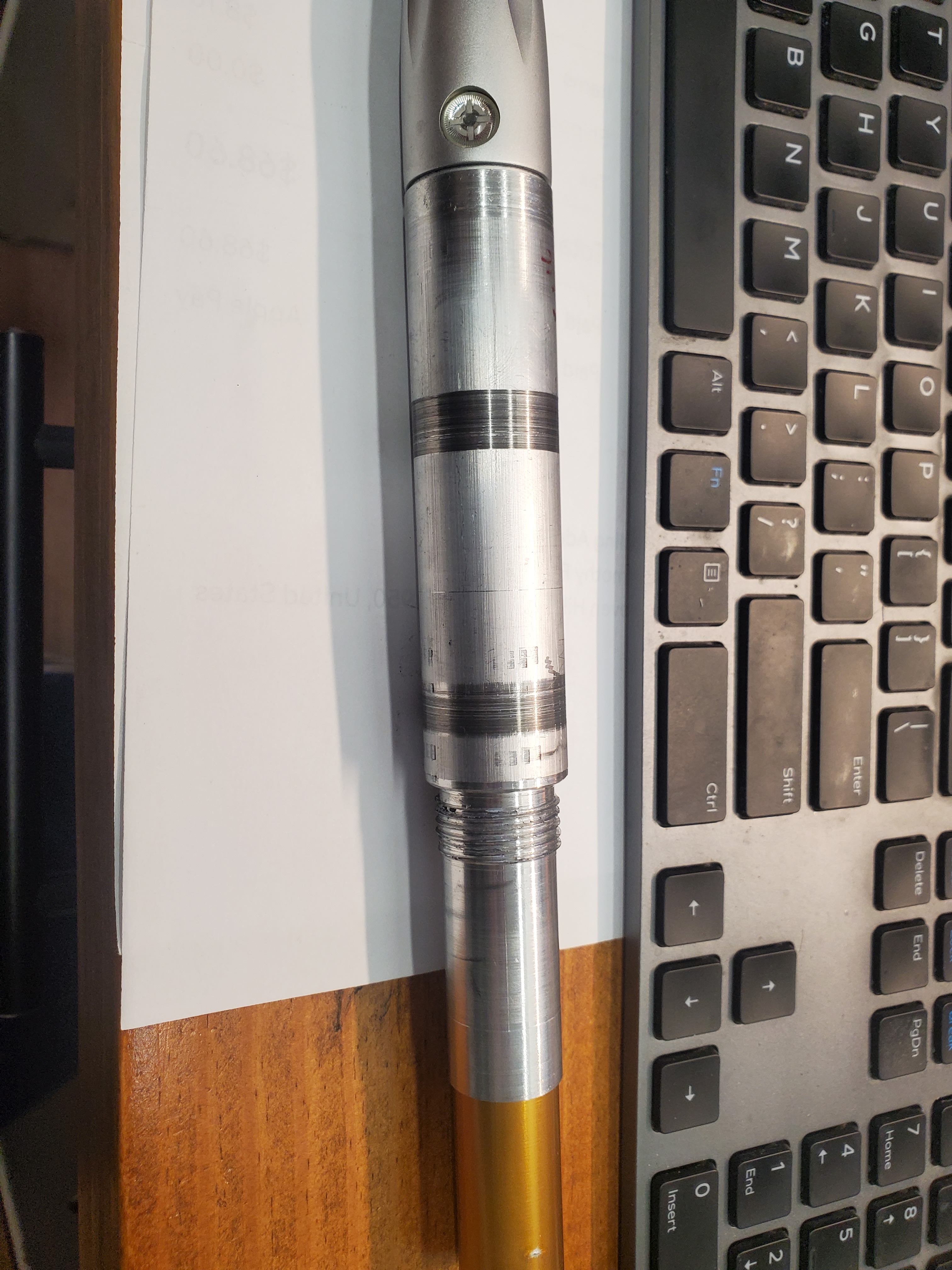

            So, it's doable.
            Far from perfect, process- wise. But after not single- pointing a thread since 2010, while breaking in an unfamiliar lathe, I made a usable barrel (that still needs to be cleaned up between centers).
            The double- lead thread for the front was real fun, but advancing the compound 0.031" at 90 degrees while keeping the halfnut engaged did the trick.
            The OD before the threads is the same as a Spyder barrel, just longer. I didn't have a long enough groove tool to cut ID for an o-ring, but I can chuck it back up and do that later if need be.
            Besides my initial metric-ish thread, the only other problem was accidentally advancing instead of retracting my ID chamfer tool at the end (hey, long day) so I had to make it 0.050" under length to remove the resulting sharp edge.
            Not keen on making more, but I've proven it's a viable design. Now go bug the guys with CNCs!
