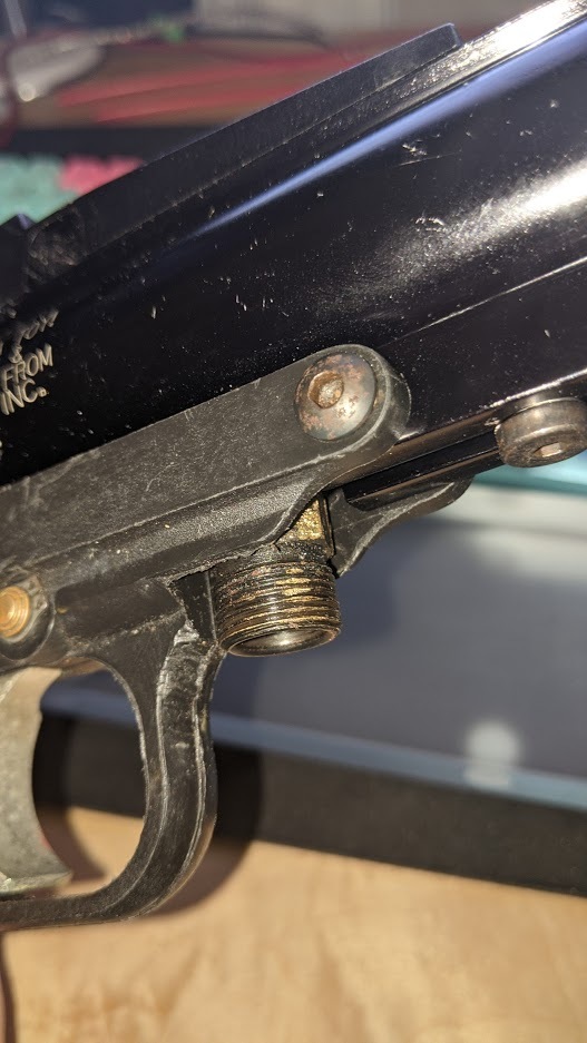

    I am rebuilding my 68 Carbine and in the process of replacing all the o rings my rebuild kit doesn't have the valve reduction fitting o-ring and I don't know what size to get. I also am looking to replace the copper line with a steel braid but can't figure out what fitting to thread on the stock valve reduction fitting that has outer threads on it to then go into a 1/8 female.

    This little fitting is what I got for mine.
    https://www.dirtyworks.com/tippmann-fitting.html

      Hello :
      This is the fitting you are looking for to allow you to use a steel braided line on your 68 -Carbine.
      You should be able to locate one at your local hardware store in the gas/propane fitting section. Unfortunately i can't remember the thread size for reduction end. Worse case scenario, strip the gun down, take body to store and find the one that works.
      Hope this helps,Good Luck.
      *EDIT* Just checked a fitting and i believe the reduction fitting is a 7/16-20 to 1/8 NPT Female. Please use this information for reference till you can confirm.

        Holy shit I spent hours trying to find this part but they were sold out everywhere I looked. Thank you so much! I thought I was going to have to settle with some frankenstien'd fitting madness.

          Did you ever figure out what the O-Ring size was? warbosschoppa
          • Chandlercv
            • Sep 2021
            • 25
            It's a M1x4.5, Buna-N 70A
              Good to know. I couldn't figure it out and ended up just buying a kit from tippmannparts
