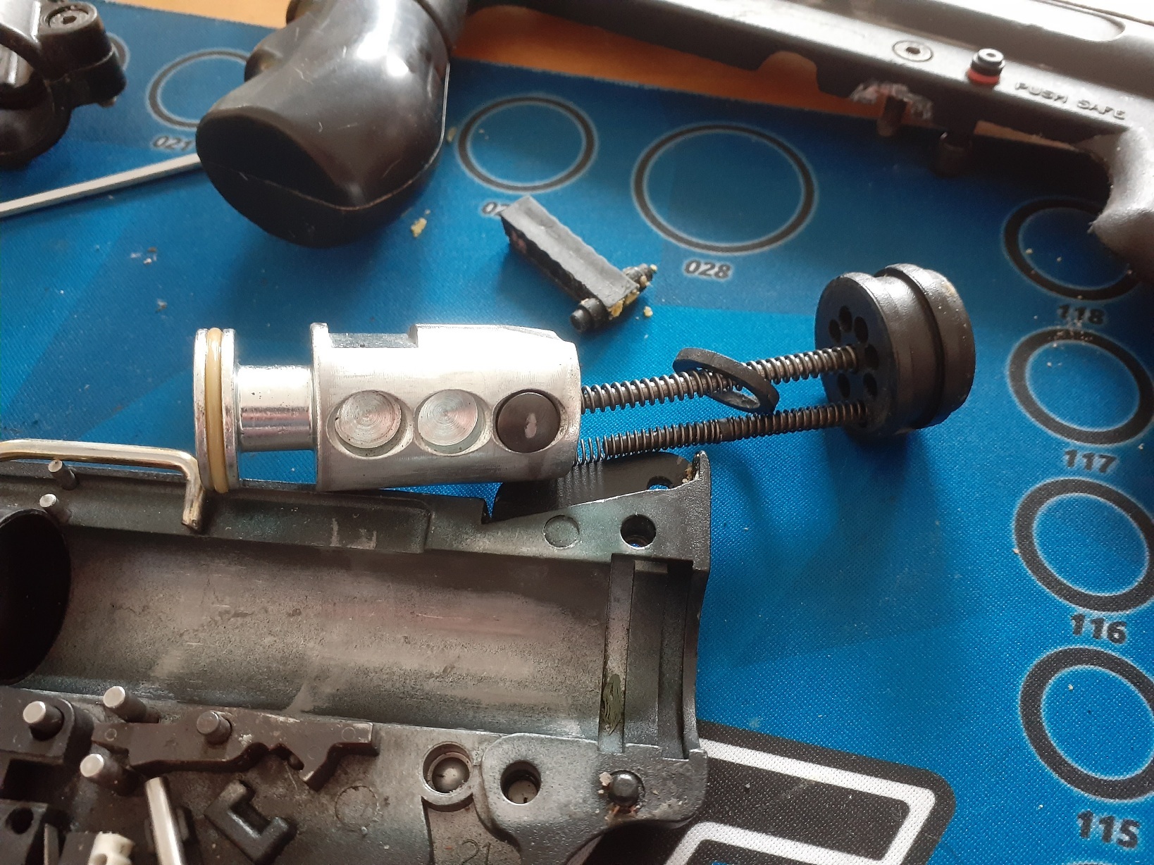

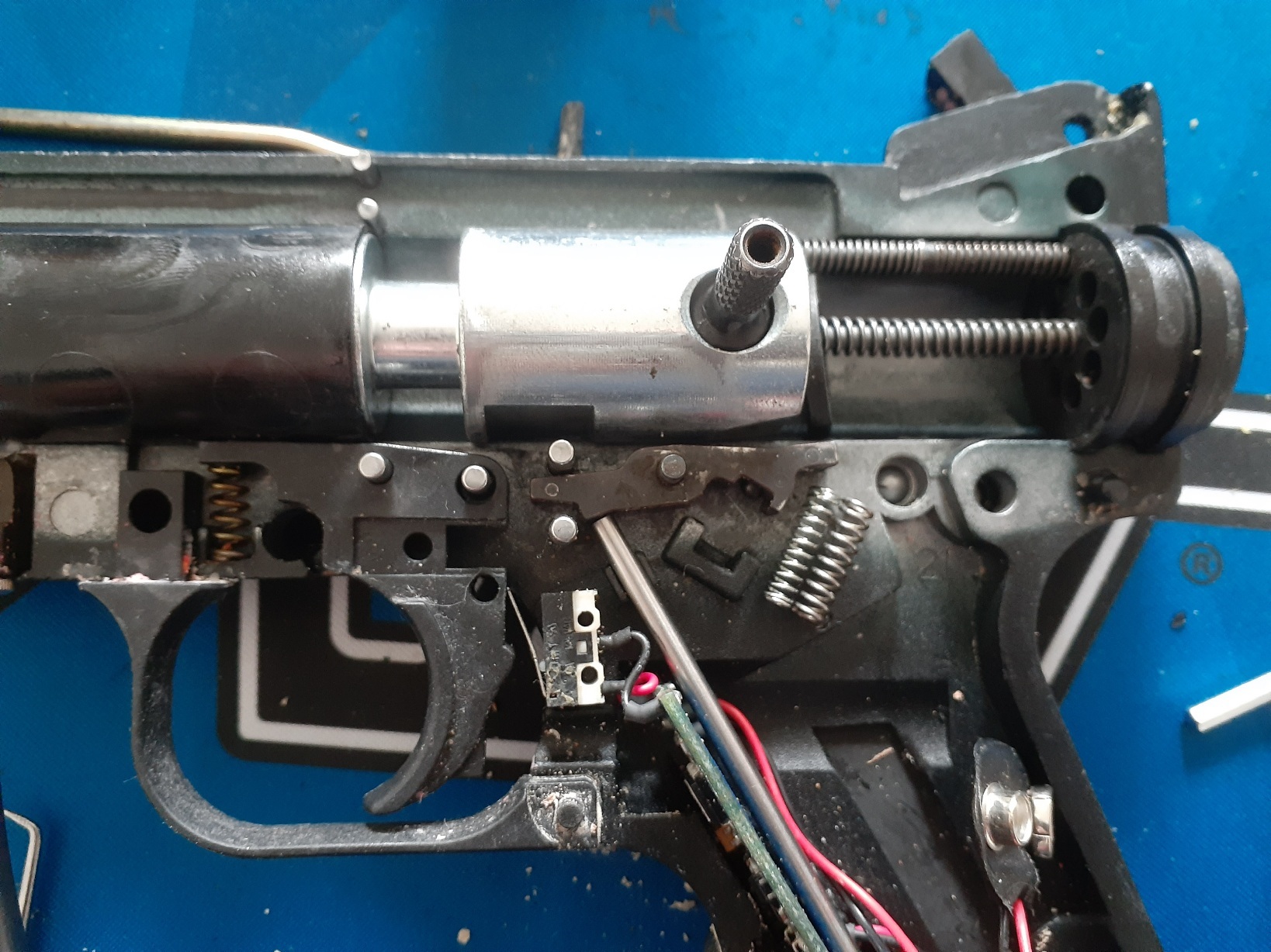

    Bough a egrip 98 and sear spring was missing
    Had some A5 spare box, found two spring that look close enough but little on the long side and seem too compress when I install them.
    Any idea if those are corect?
    one seem to be stiffer than the other
    The spring from the trigger look like the right length but I am not a tippmann expert

    And can someone confirm if this hammer is stock?
    look like an aftermarket with a weird connecting rod

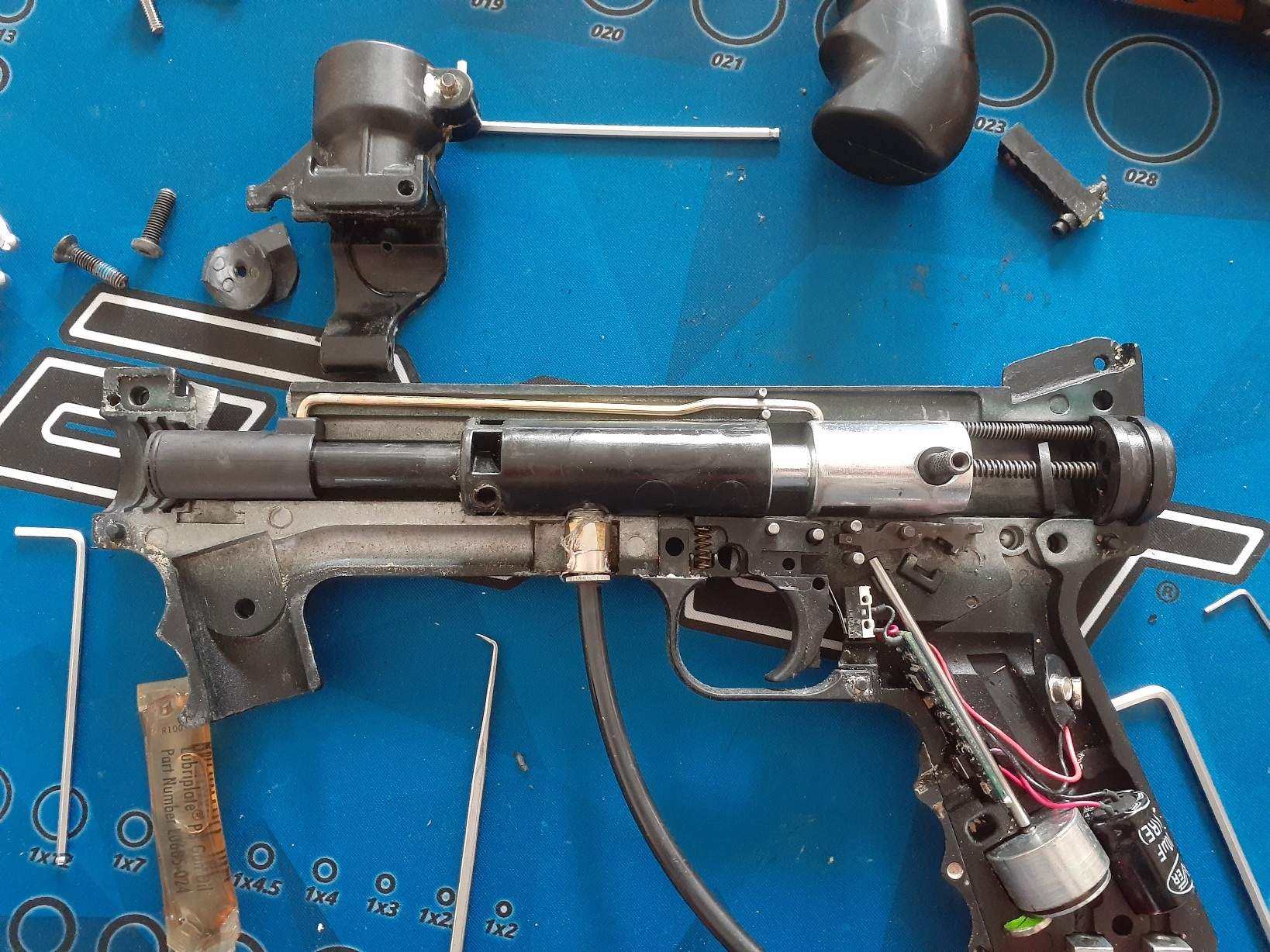

    Trying to fix it before selling... 98 are not my cup of tea
    Electronics say equaliser on it, probably aftermarket too.
    its also been converted to a vertical feed with the kit

      Hammer is an ACT, so it probably came stock with this model. It might work well with a low pressure kit installed.
      As for the sear spring, I think the electronic grip came with its own. Maybe check out an egrip installation video.

        I'd say, pop in the weaker one and see if it catches reliably. If the marker goes full-auto or double-fires you need the stronger one.
        Edit: I think this is easier to troubleshoot than the solenoid not tripping the sear because the spring is too strong.
