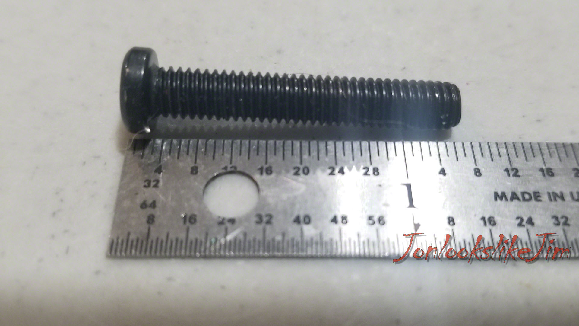

      Originally posted by JonlookslikeJim
      does any one know the thread pitch and required length for the frame hardware?
      Click image for larger version  Name:	 Views:	0 Size:	285.2 KB ID:	260229

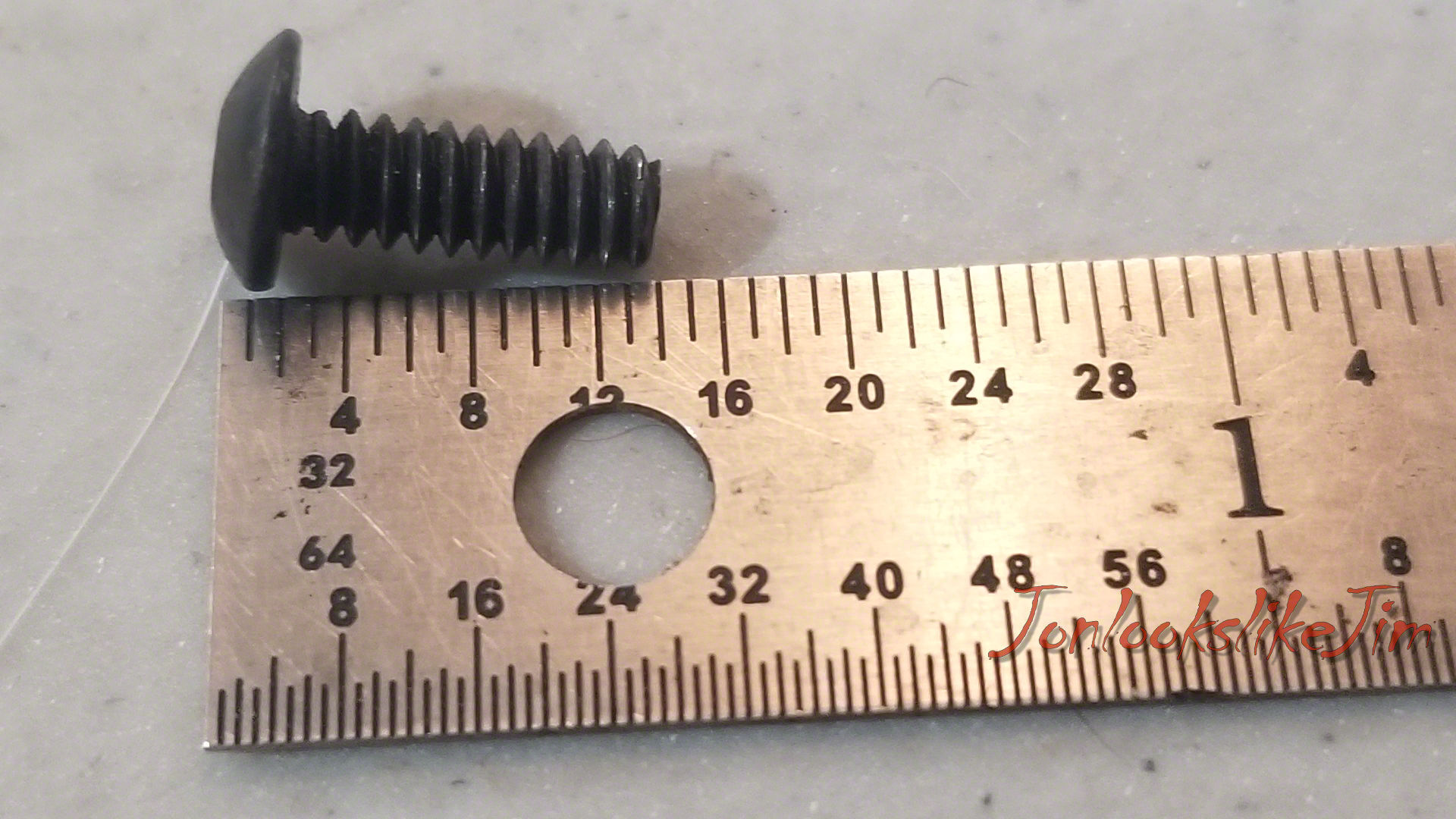

      The rear grip screws, those are 6-32 x 7/16" or 6-32 x 0.4375" they are a bit long and possibly rare, the more common 6-32 x 3/8" or 6-32 x 0.375" are adequate.
      The body & velocity tube bolts are all 10-32 threads.
      Click image for larger version  Name:	 Views:	0 Size:	209.6 KB ID:	260230

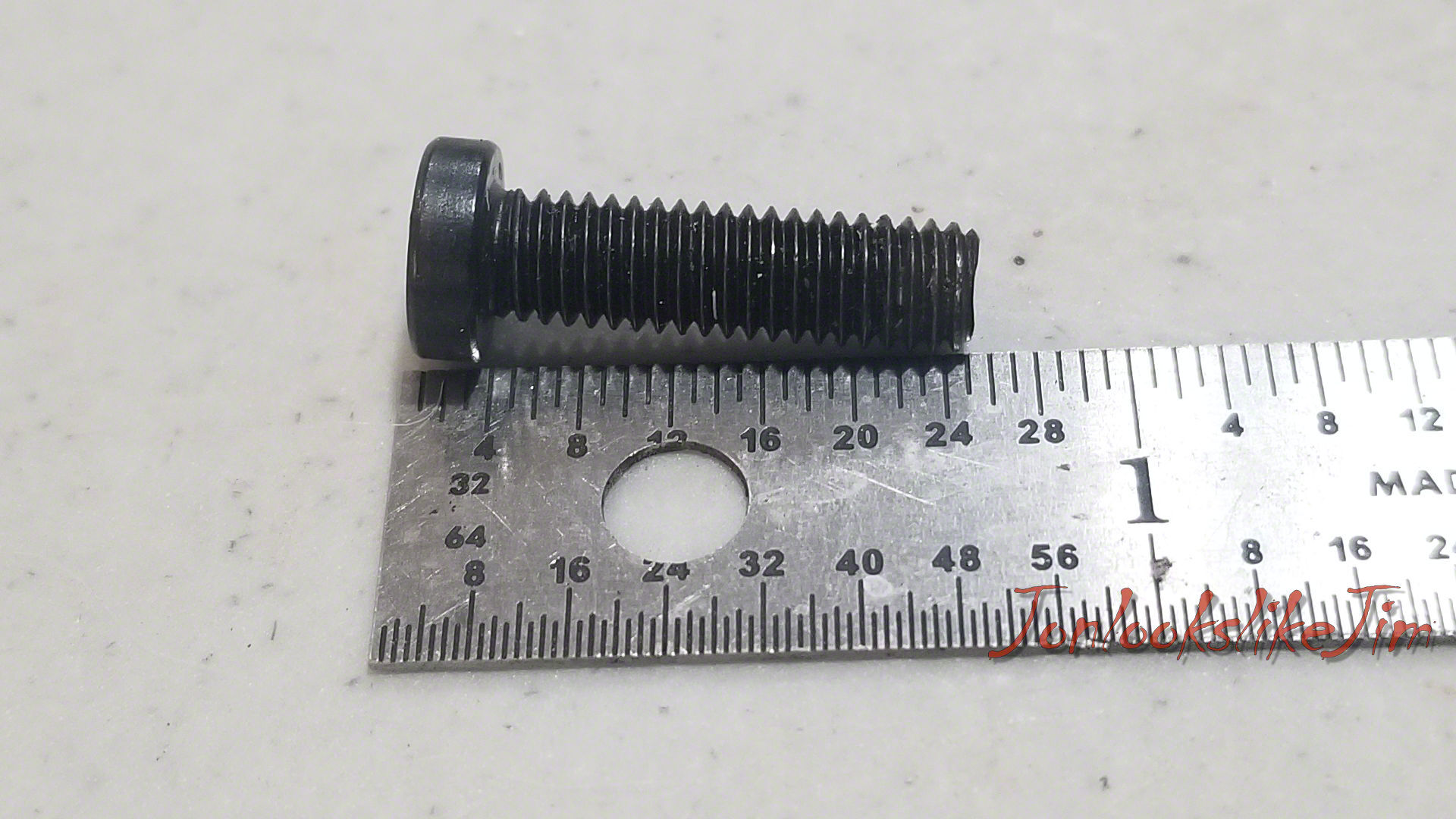

      There is (1x) long bolt through the front grip thread and length: 10-32 x 1-1/4" or 10-32 x 1.25".

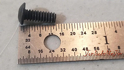

      Click image for larger version  Name:	 Views:	0 Size:	264.3 KB ID:	260231
      There are (5x) med length body bolts thread and legth:10-32 x 3/4" or 10-32 x 0.75".

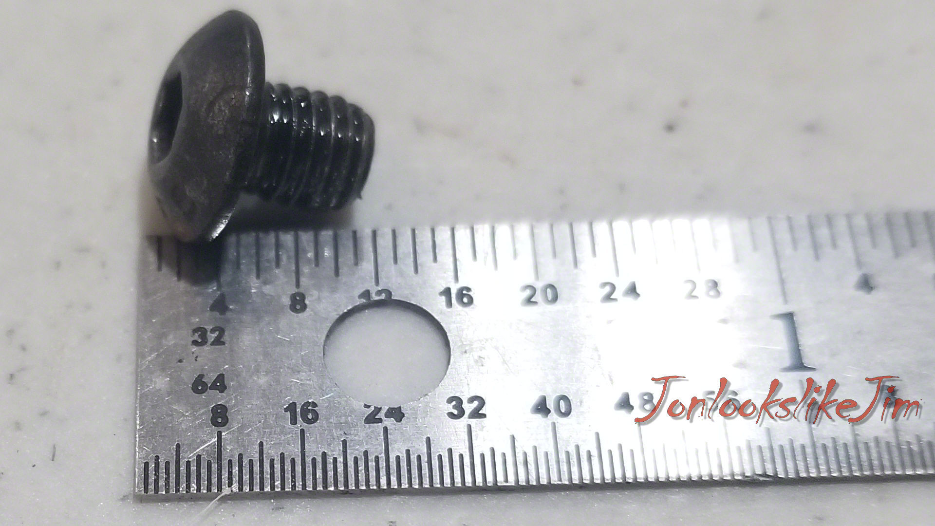

      Click image for larger version  Name:	 Views:	0 Size:	254.9 KB ID:	260232

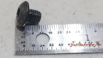

      ***The button head bolts for valve tube are 10-32 x 5/16" or 10-32 x 0.3125" but this size may be hard to come by you may need to round up to 10-32 x 3/8" or 10-32 x 0.375". If you have to go with longer or shorter hardware than 5/16" do not over tighten. For shorter hardware use loc-tite on the threads, for longer hardware you may need to grind down the length slightly. ***

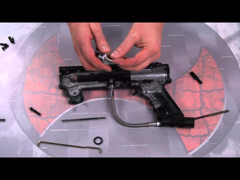

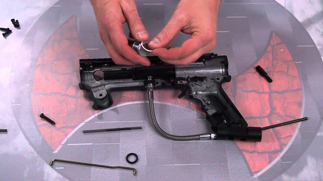

        I found this YouTube Video for how to retrofit m98 non ACT with the available kit. It is a direct drop in for m98 shells.
        *You may need to do some modifications to the hammer if running low pressure. (I.E. drill out to reduce weight of hammer)*
        **Modifying your end cap may be necessary if not included or running rear cocking style bolt.**
        ACT conversion adds an additional spring and pin to the rear of the hammer assembly that allows the bolt and hammer to disengage from each other momentarily in case of a misfeed to prevent ball chopping thus helping increase rof (rate of fire).

                I may be incorrect on ACT kit being "drop in" on these older m98 shells, upon closer inspection it seems like the connecting rod channel in the classic m98 would need grinding/sanding to match the hump of the ACT hammer/bolt connecting rod. The route that requires less modification would be to retrofit these internals to a later revision Tippmann 98 custom or custom pro body that already has the desired features.
