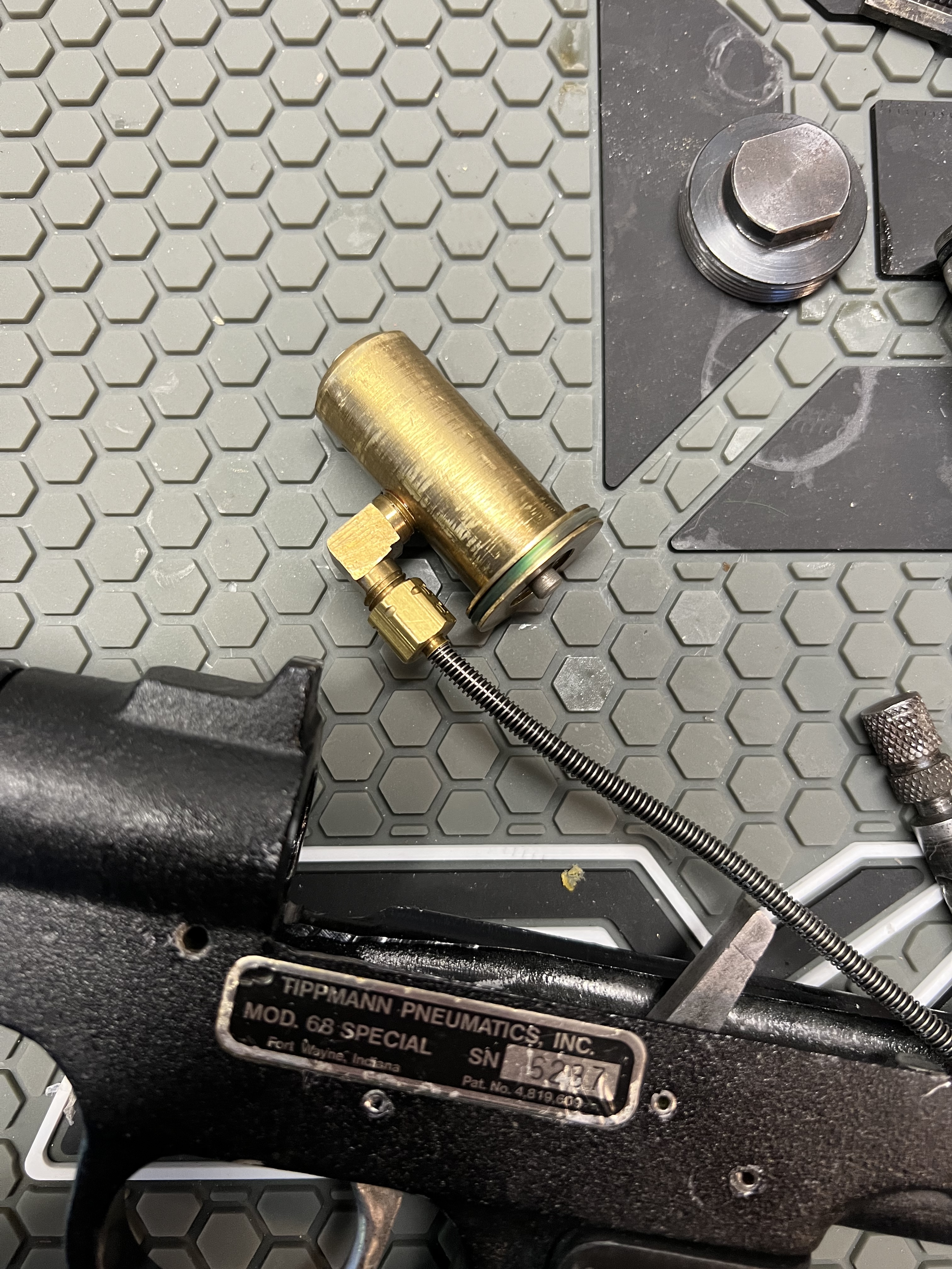

    Jury is out on the usefulness of spacer but for running it on liquid some say its a good thing. Mine doesnt have the normal recess for some reason.
    Anyone know the story? Is this a stock valve?

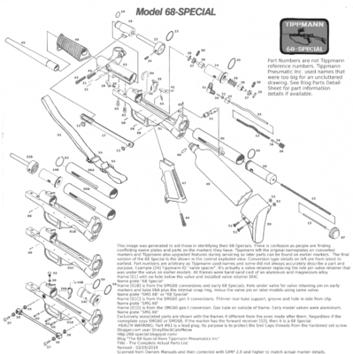

        That is the first generation of the 68 Special. There is a rolled pin under it that is tapped in to limit valve movement on firing. The later models deleted the rolled pin and had the C retainer, a groove on the valve and notched frame for the C retainer for easier maintenance as the valve must be kept free floating. Early 68s sent to factory for service had the modification done automatically so C retainers may also be found on some early markers. Note that Tippmann just referred to the retainer as a spacer on the parts list.

        Yes, that is correct. But if Tippmann serviced the marker later, they completed all upgrades. Same goes for the SMG60s and SMG68s that were converted to 68-Specials for a $100 fee. The lack of the safety notch could also indicate that the tube was from a SMG. The picture should cover all renditions, but actual timelines are elusive.

          Just restored the withdrawn pages on my 68-Special blog marking them with pending update in red. That includes the initial parts list that identifies o-ring hardness and some hardware resources helpful in repairs. Prices and availability have not been updated. I will only pull them again after the update is published. I need to find my detail files on the improved picture as well as siphon tank part details that I had tracked down.
